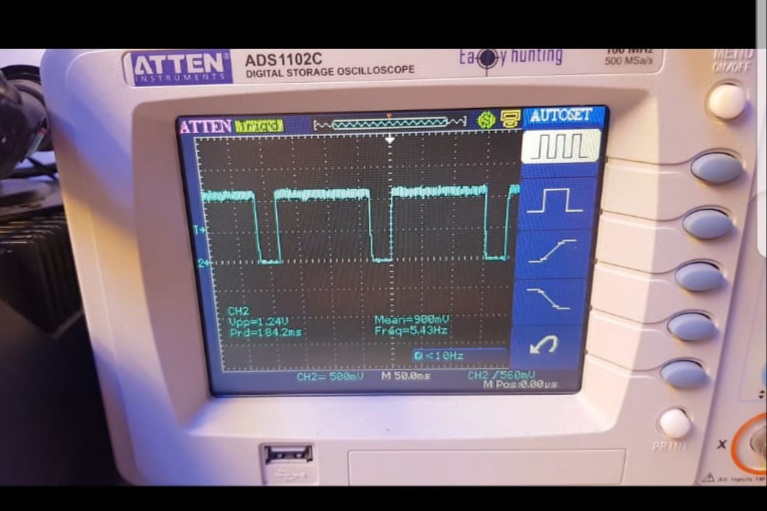

                                    HI i have a strange issue... i have the +1.05v of the chipset power supply with 5Hz zero values (5 times at second from 1.05v to 0v)
                                    same happens on +3vSUS ... and also on eeprom power... the 1.05V can be explained because the PG signal (on PU8200 ) is also doing this 5hz strange issue..
                                    i can't track this to the origin..
                                    Anyone with schematics? ( can't identify the issue with only boardview)
