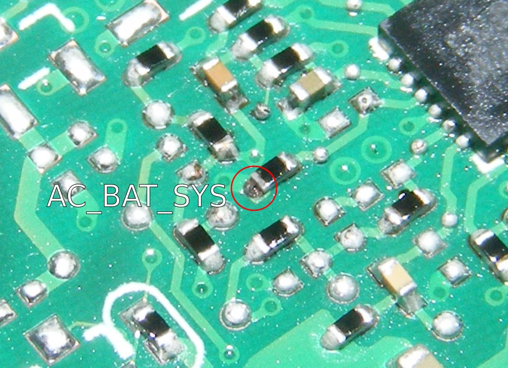

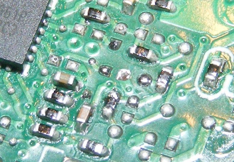

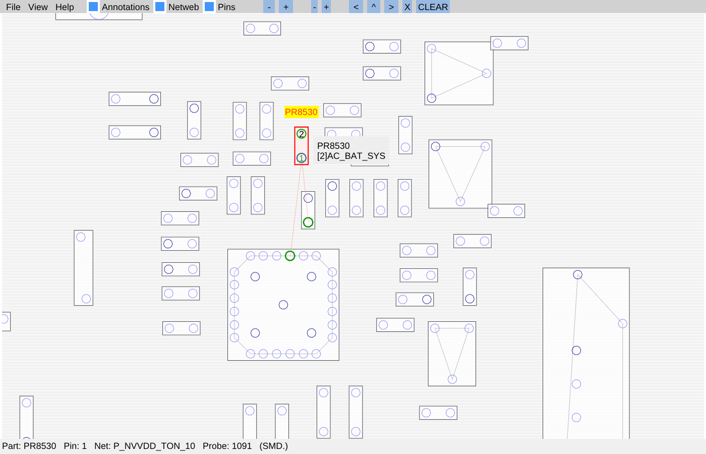

                  Problem solved. Would have helped a lot if I had the proper schem
                  In this case, because this board has an nVidia GPU, that was a whole section of tests and subsequent EC input that I didn't check (when using the UX31A2 schem).
                  Needless to say, fixed now. Was the turn-on resistor for the nVidia GPU power rails generator; it had the pad and resistor end-cap vaporised, wasn't overly easy to see, but taking some macro shots with my camera helped a lot (old camera but still 7mpx).
                  Not having a decent stereoscope, and lack of schem made this job harder than I'd want to deal with on a daily basis at work. Just glad it's solved now.
