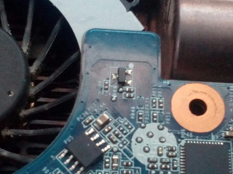

    I've got this laptop, pretty beaten-up but it starts on without problem. Oh well, no screen on either main or external vga. The vents were really cloged badly so I suspect the vga chip cip, 216-0809024 is either burned or doesnt get enough voltage, it's stone cold even after 2 minutes after the laptop has been powered, meantime I change cpu/ram but to no avail. I'm missing this schematic from my collection, can someone upload one for me so I may try and test this motherboard?

      Re: HP Pavilion G7 1045 SF schematic needed
      Yes, I knew that it will be bite me in the ass if I dont provide one but I was already home when I made the topic. :P
      HannStar J
      94V-0
      MV-0
      1104
      Also, I think some parts might be missing on the picture taken of the board.

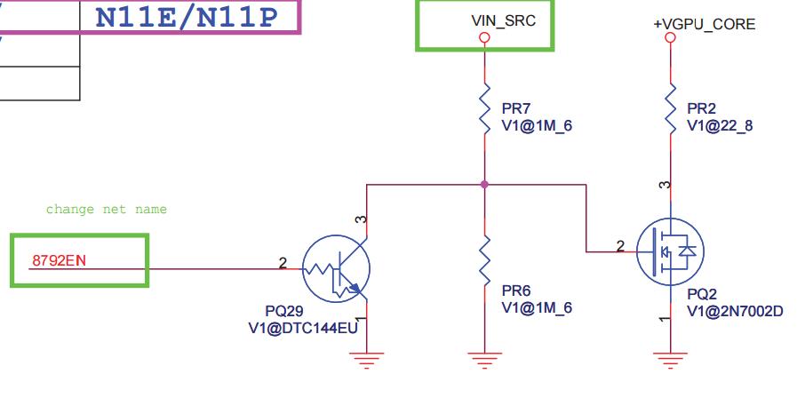

        HannStar J - It is a manufacturer of PCB.
        PQ2 - maybe it's 2N7002D
            PQ2 is in the power circuit +VGPU_CORE
              Then it might be this one: DA0R12MB6E0 REV: E
                Da0r12mb6e0 rev: E
                    Originally posted by alexnavin
                    Thanks for the schematic and the picture. Will try and figure out what those missing parts do.

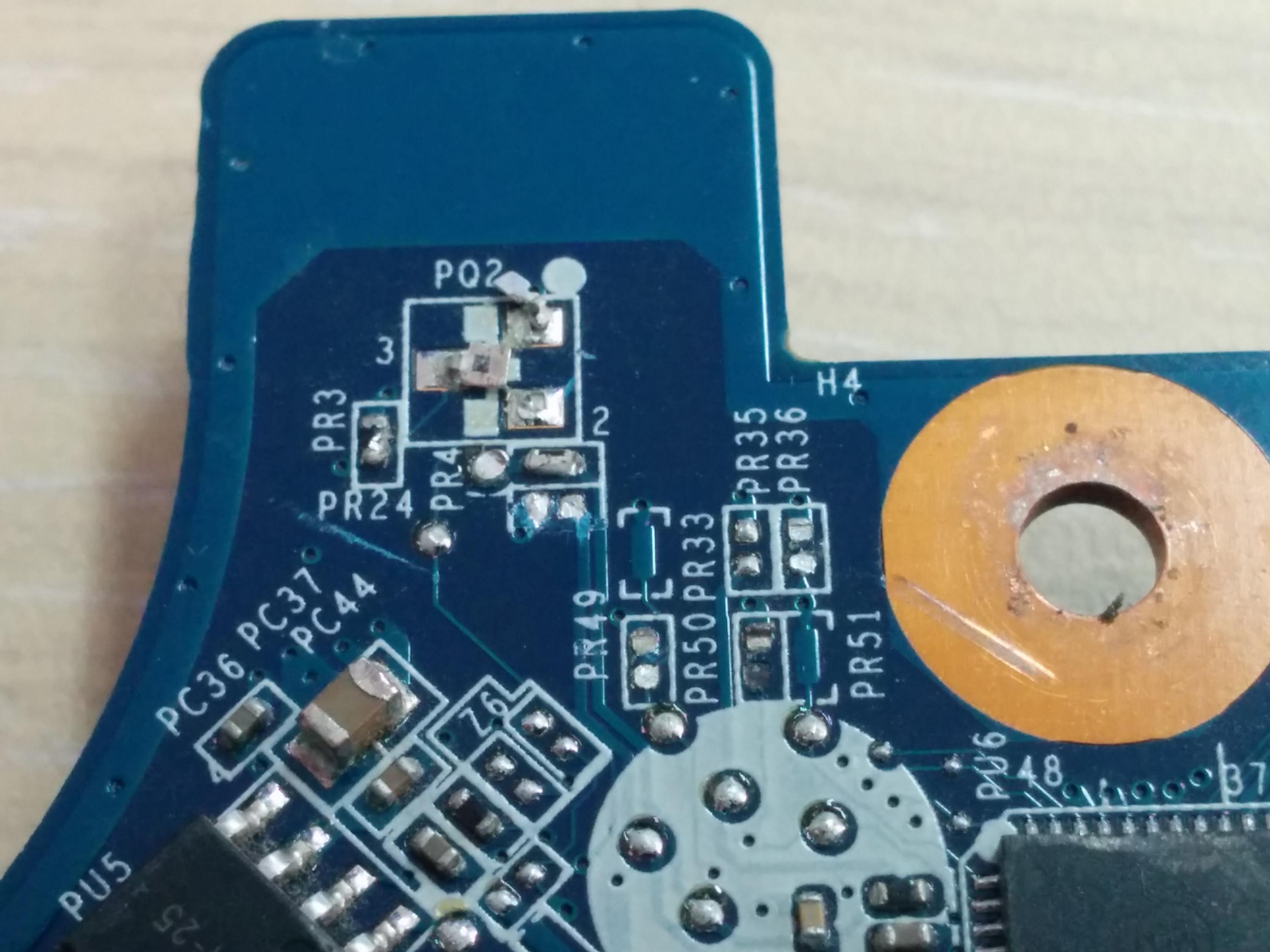

                        Alexnavin, any chance to help me out with the values of that PQ2 component? We cant seem to identify a proper one so we need to know what's written on it.
                          http://pdf1.alldatasheet.com/datashe...DMN601K-7.html

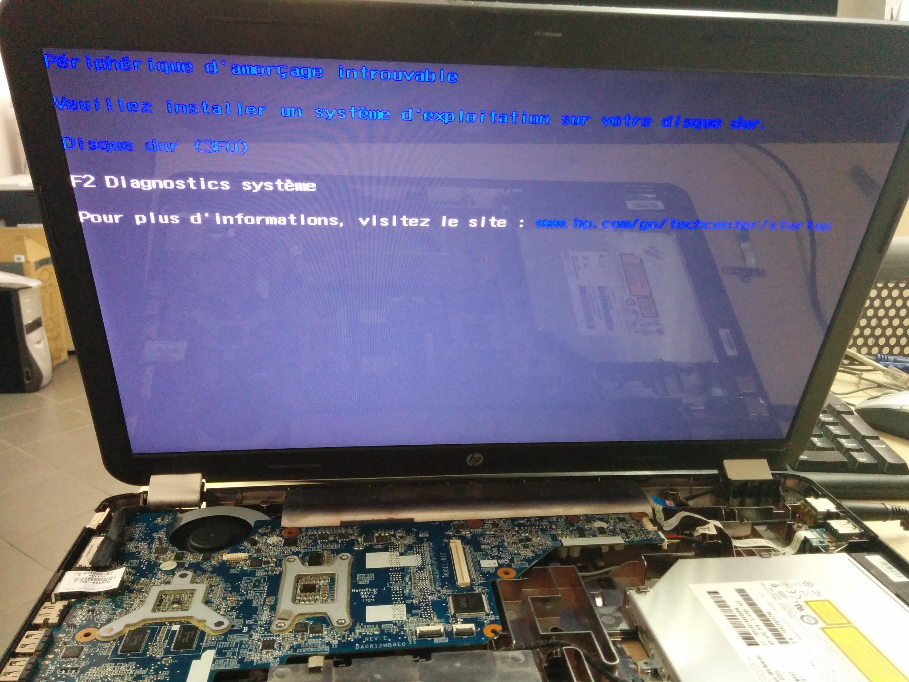

                            Thanks for all the help. I managed to replace what was missing and the laptop turned on with screen this time.
                            Now I found some more missing parts, some small smd's. I will try and fiind replacements for them although I dont know yet what they are for.
