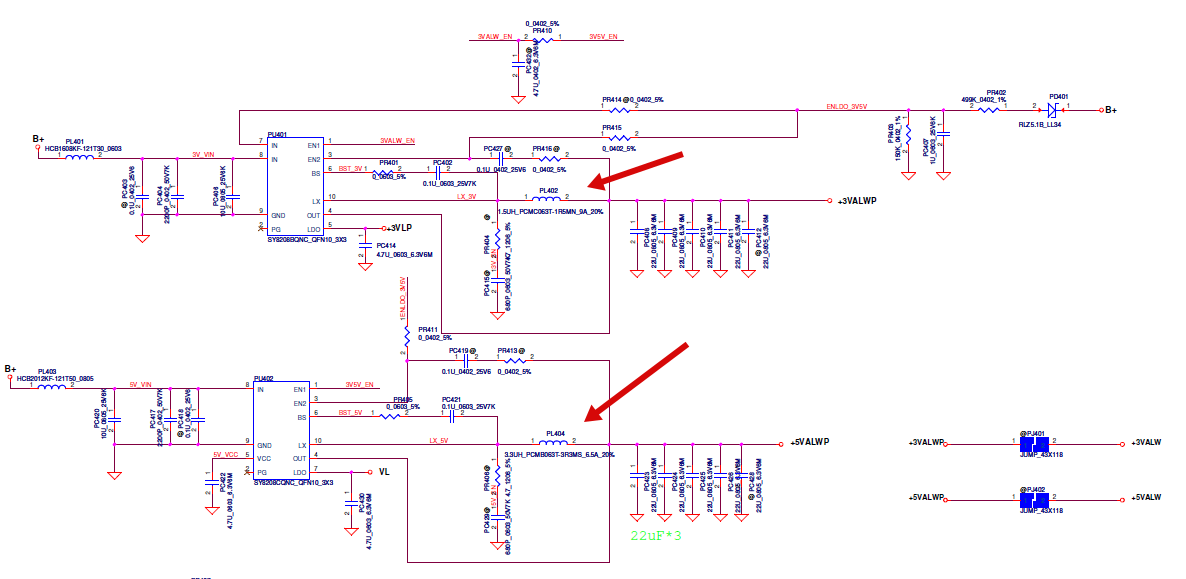

    Does anyone have access to schematic for Lenovo G510S motherboard LA-A192P Rev 1.0 2013-08-16? Thanks in advance for assistance!

    No schematic available yet - yuck. Laptop doesn't power on. No LED's. I'm guessing the hole in the inductor is not a "factory flaw". Any guesses on where to find one? 1R5 Q3N I've seen some decent pics of the same board with three lines of text on this component. I will look again to get those and post them.

      You can get that from a dead board. But I doubt that is blown. Does it show continuity on your meter?

        Yes, no resistance. Little backstory - when checking the power supply, instead of getting 20V DC like expected, I was showing closer to 90V DC. Tried different power supply, laptop does not power up and no leds come on.

              mcintyrerj, look this
