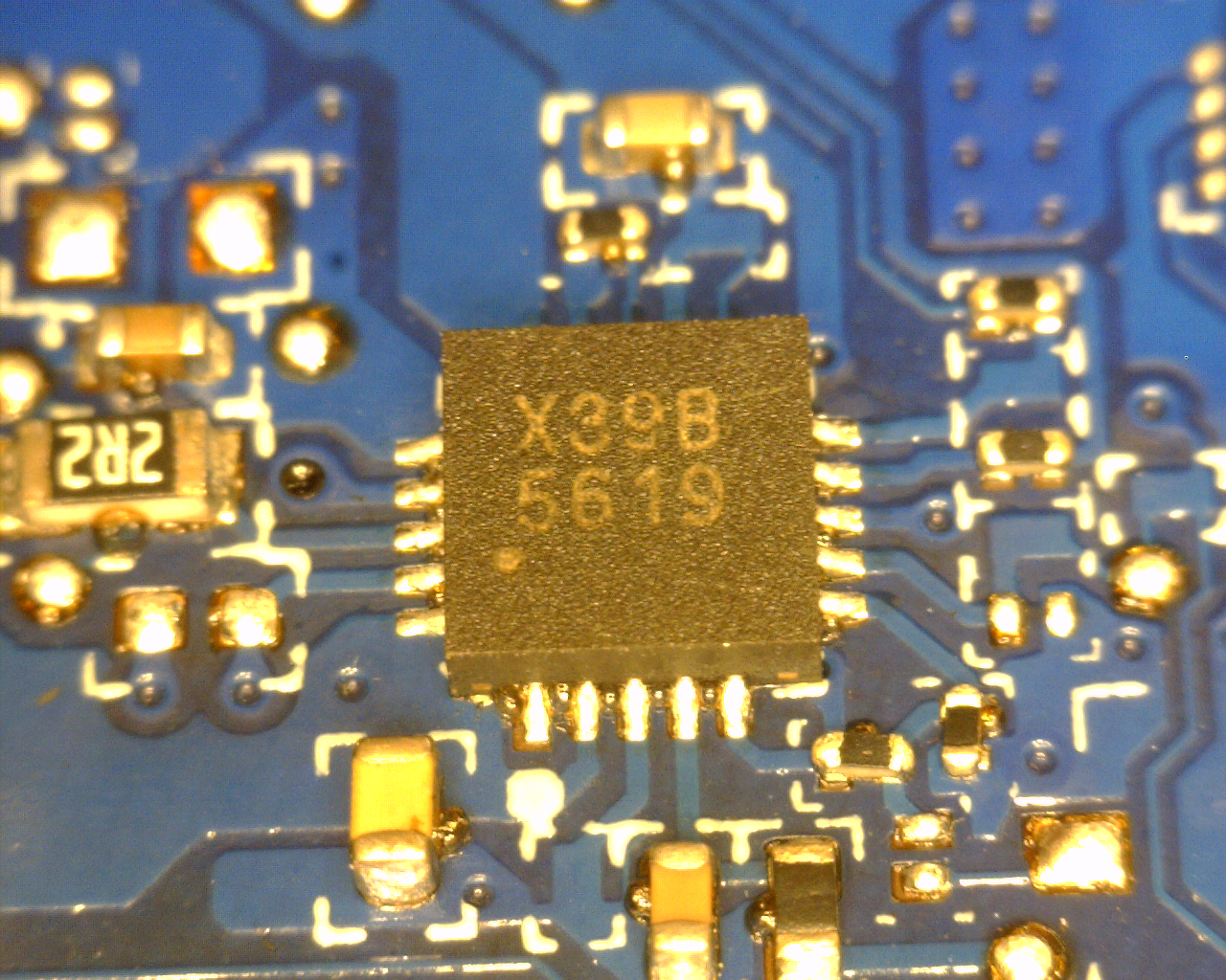

    Need schematic / boardview to identify some faulty chip marking codes

    post pictures of the faulty chips

      Marking on the chip : X39B 5619

        possibly a GMT G5619RZ1U

          Many thanks for your help

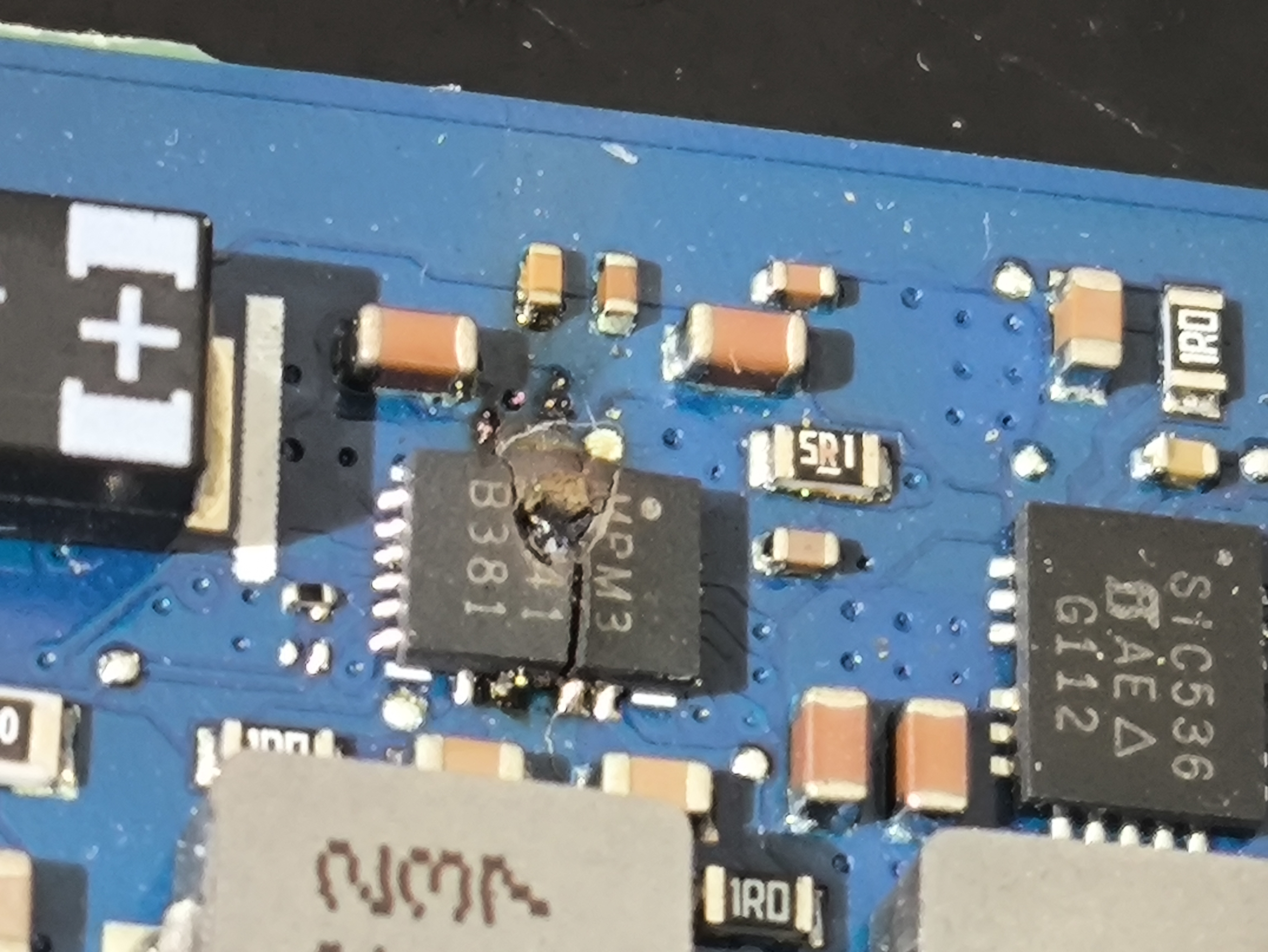

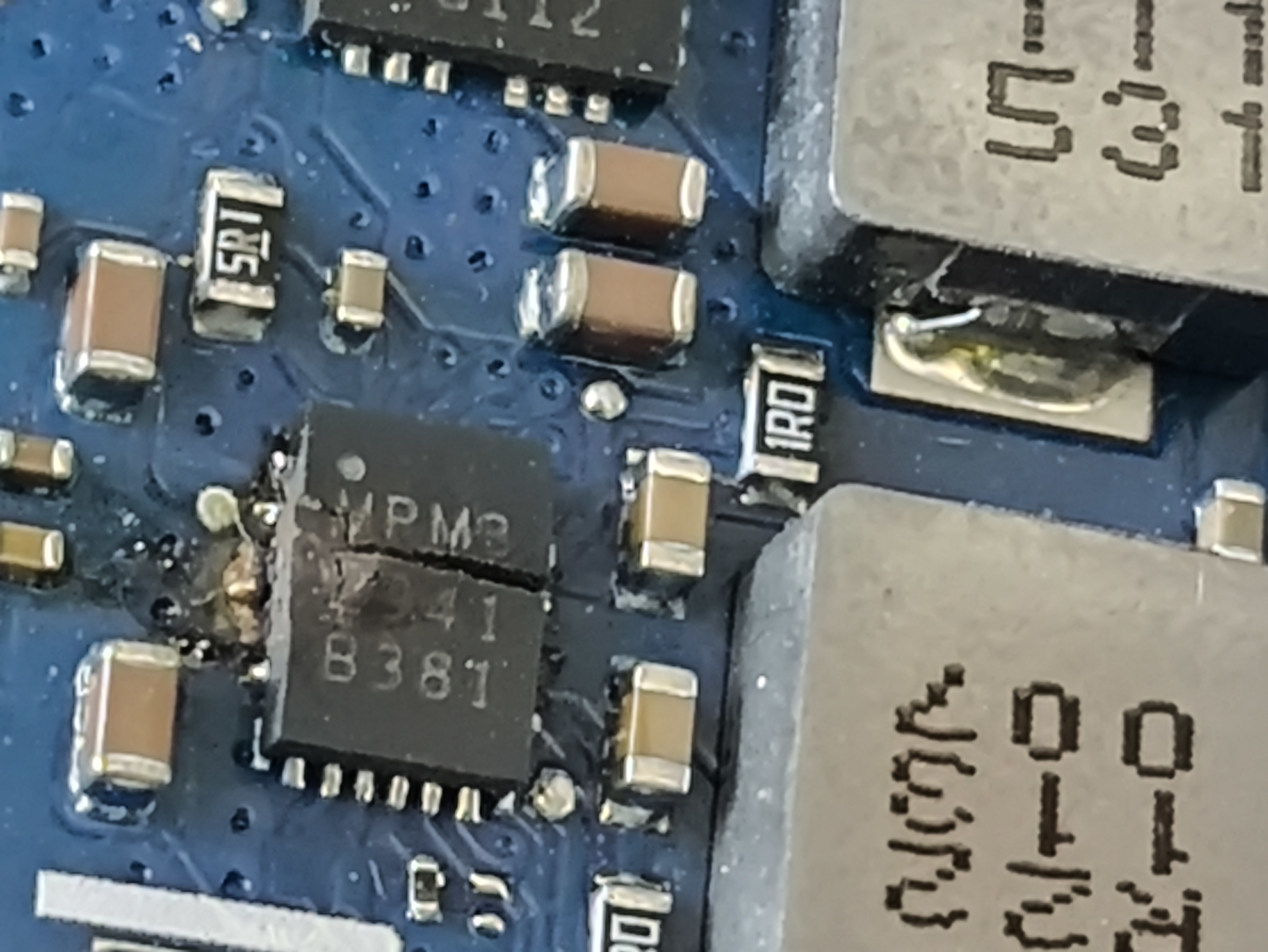

            Have a 440 G8 fitted with a DAX8QAMB8D0 REV D motherboard. One IC is cracked down the middle, and I suspect this is probably the system agent rail for the CPU. It's dead short, but just wanted to know what IC this is before I take it off. Highly likely CPU is shorted but anyway.
            I think the markings (as best as I can make them) are
            MPM3
            2941
            B381
            I wiped it with IPA but the first two numbers of the 2nd row disappeared.
            Edit: Took the IC off, CPU is shorted. I guess it was driven too hard, failed then 19V straight into the CPU. No other damage to the board.

              It`s a Monolithic Power IC https://www.badcaps.net/forum/troubl...20#post1482820
              Possibly MP2941GL-Z

                Thanks Flea, I think you are on the money. There appears to be an A and B variant from SUHMS for this. No publicly available datasheet for it unfortunately. Did a search in FlexBV and found it in the Lenovo 203013-1 schematic amongst others. Appears to be for the VCCIN_AUX rail in that one.
                CPU was shorted anyway.

                  Found some schematics and boardview for this board. That IC was PU9100.
