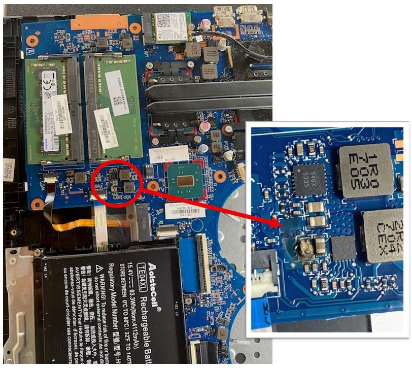

    Hi, I need the boardview and schematicsfor an HP OMEN 15-ax204ns laptop, purchased in 2018, with the following specifications:
    • Processor: Intel(R) Core(TM) i7-7700HQ CPU @ 2.80GHz
    • RAM: 4.00 + 4.00 GB
    • Hard Drive: 1TB
    • Product ID: 00325-96088-89605-AAOEM
    • N/S: 5CD70805T8
    I’m trying to repair a short circuit in the battery charging section.

    If you can help me locate the boardview and schematics or a boardview file, I would really appreciate it.
    Thank you for your help!

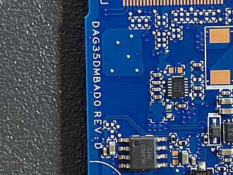

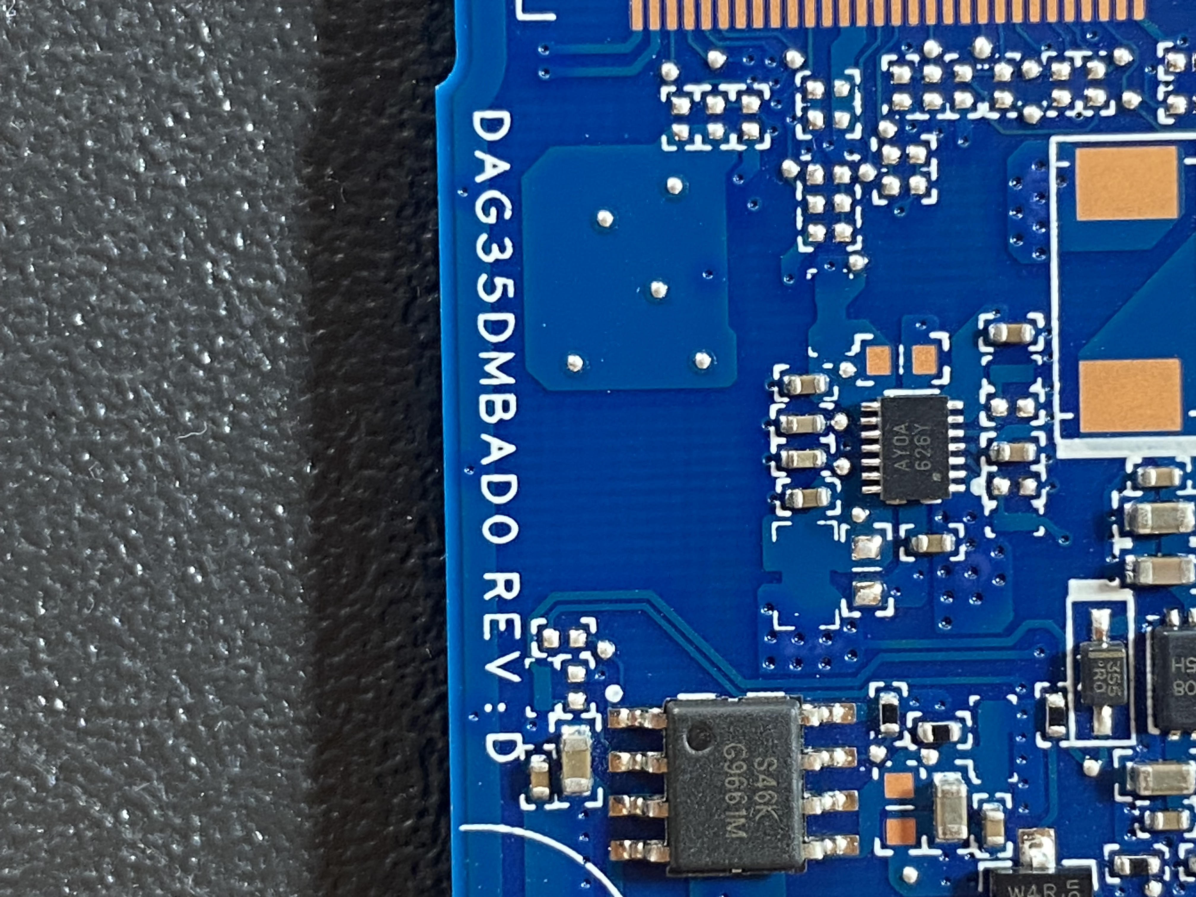

        Plate information: DAG35DMBAD0 REV
        thank for your help

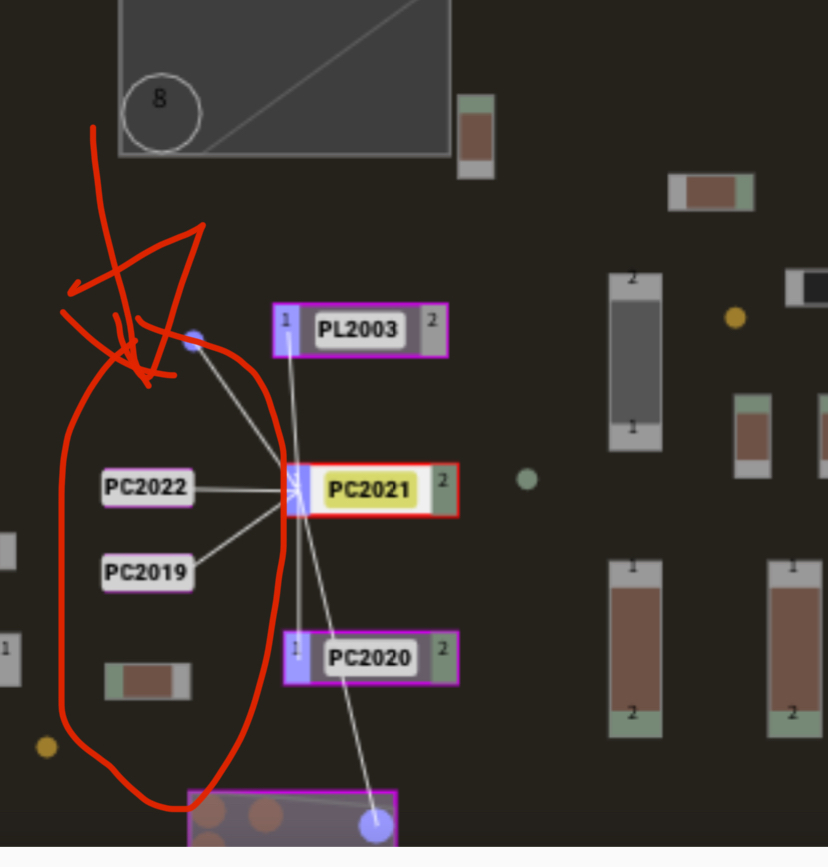

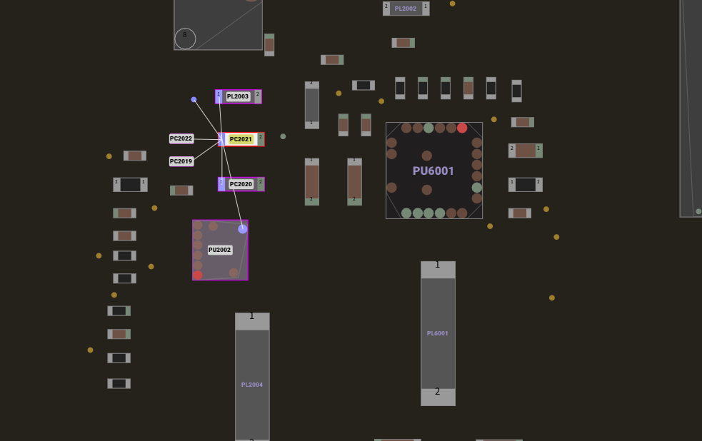

          The shorted component is (PC2021_4.7U/25V)

            Thank you for your help. Could you please tell me the value of these resistors? They are shorted.

              The letters (PC) at the beginning... mean that they are capacitors.
              When they start with (PR) they are resistors.
              PC2022_2200P/50V
              PC2019_0.1U/25V
