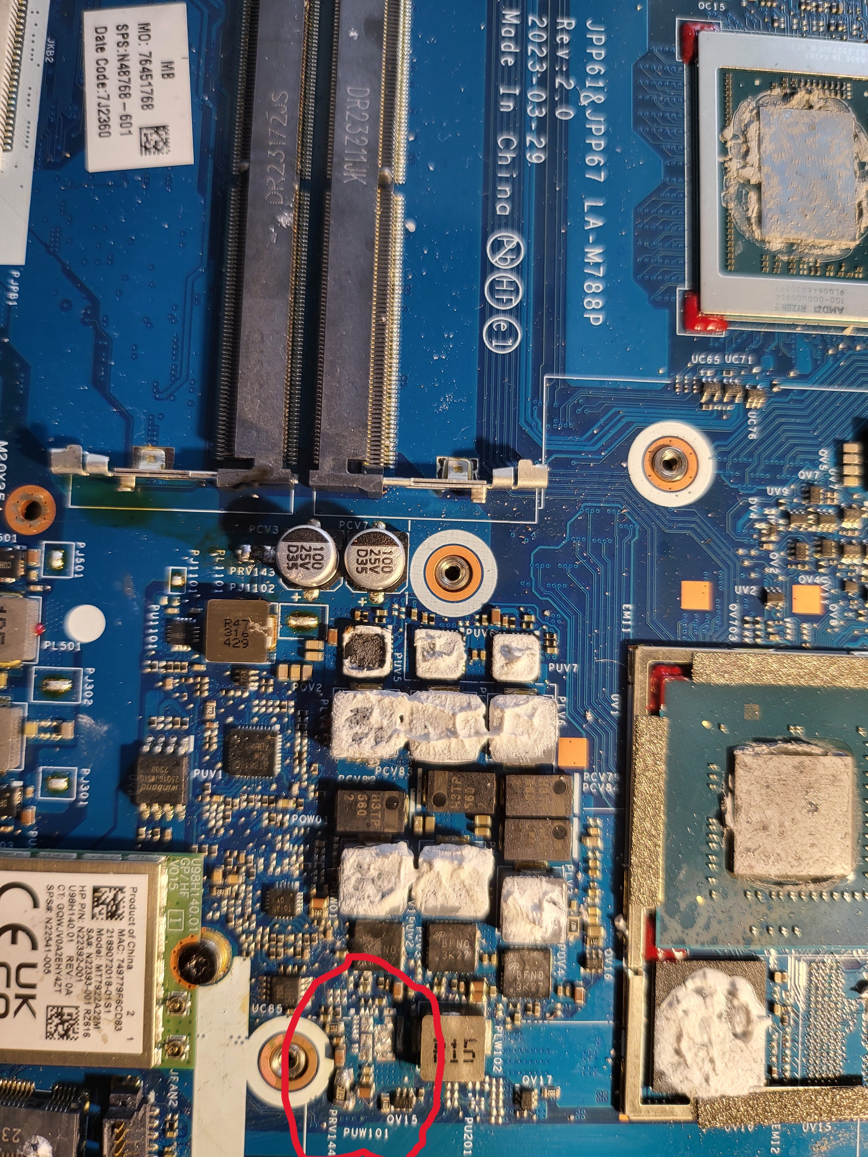

        Hello there I need help identifying this components, one of this is probably shorted, but I don't find any references to this marking codes. If someone has any info please let me know. DFAF JB, CUHF JC.
        • Gernet
          • May 2021
          • 60
          • Italy
          =DFA...= SY8371BTMC
          =CUH...= SY8370CTMC
          • ferah831208
            • Aug 2019
            • 65
            • Cuba
            Thanks 🙏🏻

                LarrySabo I already fixed that laptop, I bought the replacement from SHUMS on AliExpress, and I had to replace also EC controller chip but luckily laptop is working.
                    Thanks for that info. I've ordered the SY8371BTMC on AliExpress but it hasn't arrived yet. Haven't checked the EC chip so I hope it's okay.
