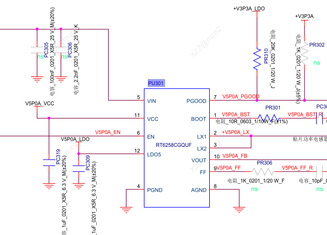

Looking for ACER nb2665_PCB_MB_V3 schematic or name component
  • poky500
    • Jul 2022
    • 12
    • Italia
    Hello, I need schematic of Acer nb2665_PCB_MB_V3 of name of component in picture which is blown. I can’t find anywhere ‘cause I can’t read anything on him.
    thanks in advance
  • mon2
    • Dec 2019
    • 14306
    See attached.
    PU301 = Richtek # RT6258CGQUF
    https://www.mouser.ca/ProductDetail/...cmMFN49xzx_zR5
    https://www.digikey.ca/en/products/d...CGQUF/16376603
    Datasheet:
    https://www.richtek.com/assets/produ...S6258BC-03.pdf
