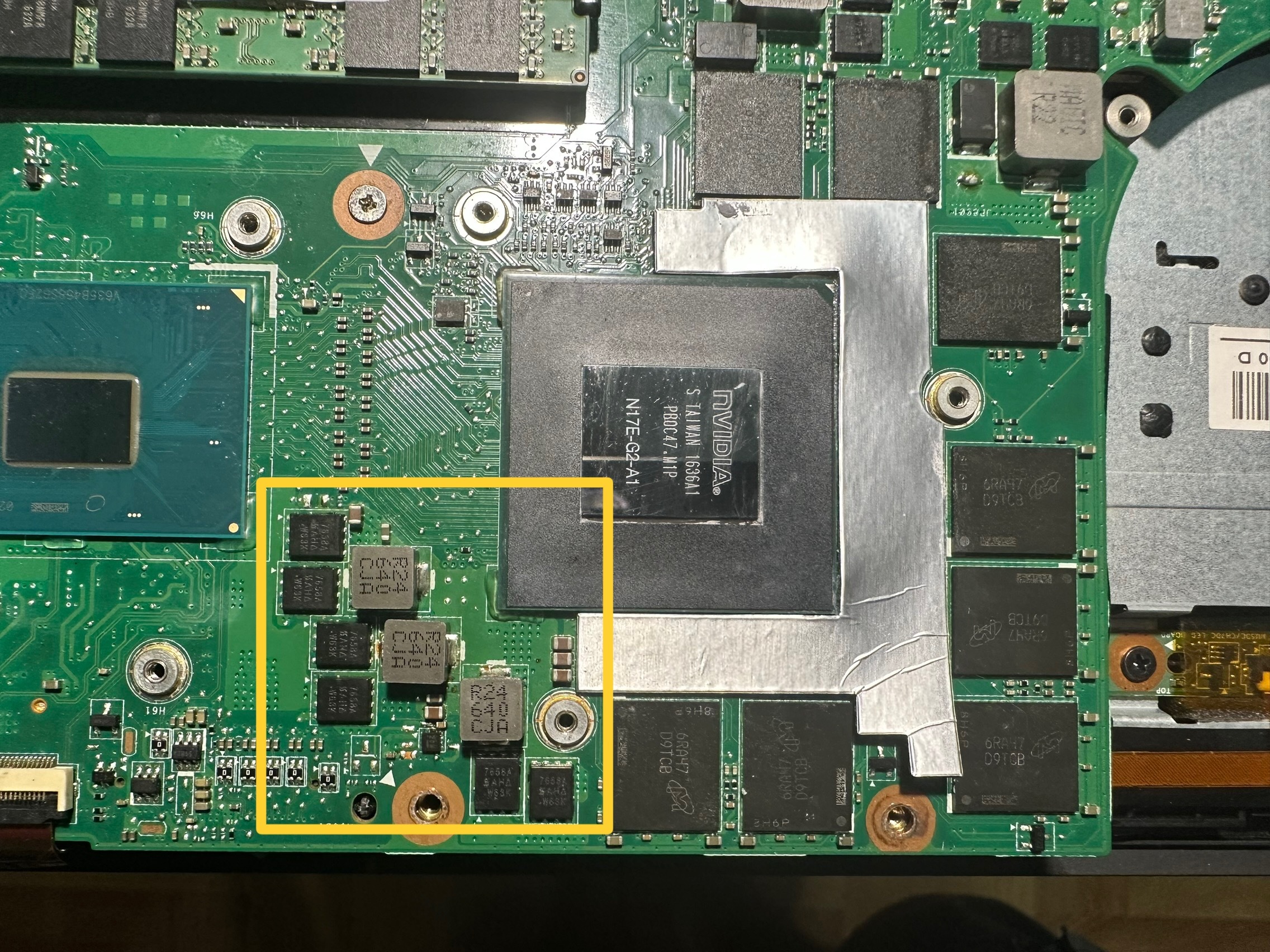

    Hi, I am looking for schematics for an Acer Predator 17 G9-793-73A6?
    I can not read the last digit, maybe 6.
    In another topic I found a boardview that seems to match mine: Acer Predator 17 G9-793 - Pegatron MU5DC CH7DC BoardView
    But in the same topic schematics don't match (both board view & mine) : Acer Predator 17 G9-793 - Pegatron MU5DC CH7DC REV 2.0
    On this mainboard, the GPU is dead (shorted), but I am trying to have it booting without the GPU Nvidia, to disconnect GPU I have desolder 3 coils powering the GPU, and one bigger in upstream these 3.
    Now it begin to boot, as soon the hdd led lights up, it reboot
    Click image for larger version  Name:	IMG_0367.jpg Views:	0 Size:	88.8 KB ID:	3653228

    I remove these 4 coils
