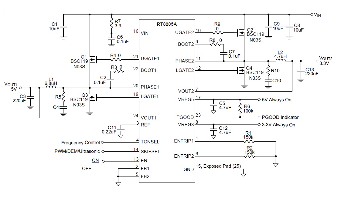

                  tracing through tracks without schematic i found the ALW 3.3v genrated through
                  U6 writtent over chip is
                  DT=CH
                  H1C
                  I UNABLE to recognize this chip no if some body know which is this chip pl reply
                  so that is the chip which is not giving 3.3v so pl help

                    Re: required schematic hp mini 110-3107TU
                    It is RT8205EGQW
                    https://www.badcaps.net/forum/showthread.php?t=31273
                        I HAVE RECIVED DT=CD INSTED OF DT=CH AND INSTED OF 3.3V ALW IHAVE RECEIVED 0.4V IS THIS CHIP IS alternate or not what to do suggest,
                            Where are you checking for 3.3v alw?
                            • sanehdeep2012
                              • Oct 2013
                              • 139
                              • india
                              sorry for late reply,
                              3.3 ALW AT BIOS CHIP
                              AND at U6 chip Pin no 7 of DT=CH(RT8205EGQW)
                                U6 Chip replaced and now 3.3v is availabe and laptop goes power on but now no display
