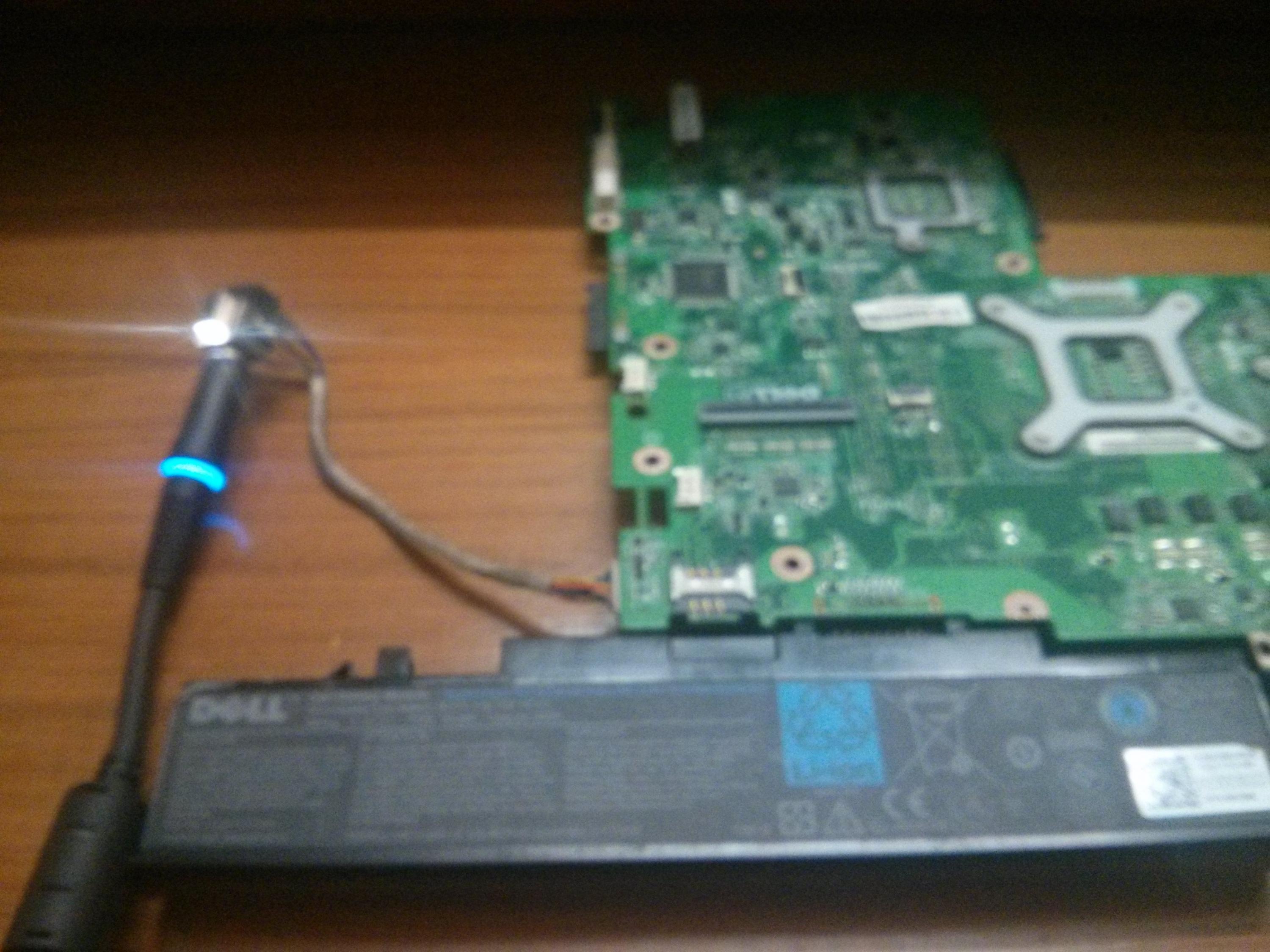

                          First of all many many thanks to the members of this forum. I have repaired some laptops and other circuits just by reading the information provided by this forum. This time i am unable to fix a laptop motherboard and i need help.
                          The Model number of laptop is : Dell 1558 studio PP39L
                          Motherboard: DAFM9CMB8C0 Rev: C PWB: A00
                          The problem with this motherboard is that it fails to power on. The LED attached to the power switch blinks for 1/2 second and then nothing happens.

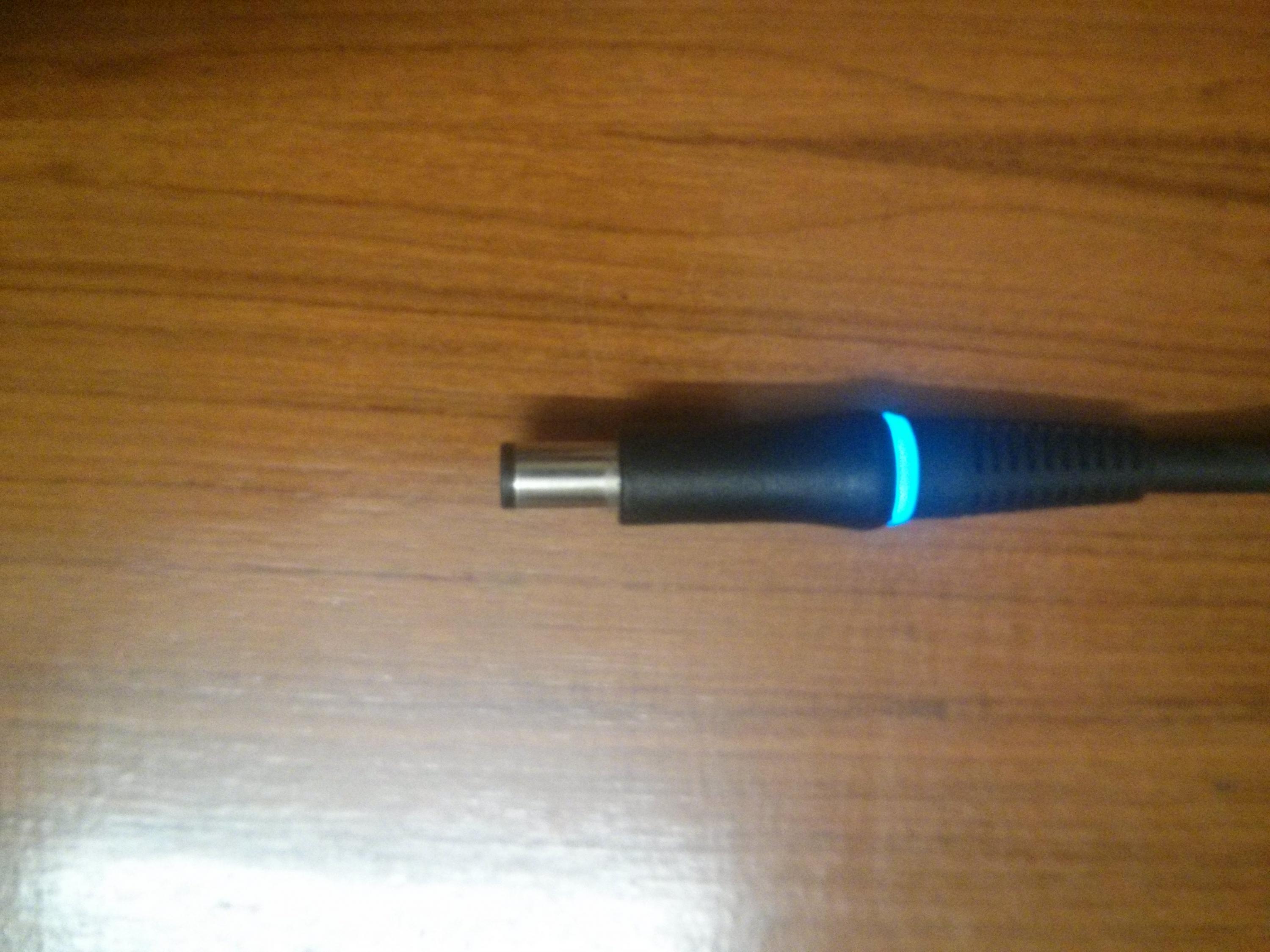

                          Adapter is good with output +19.91 volts

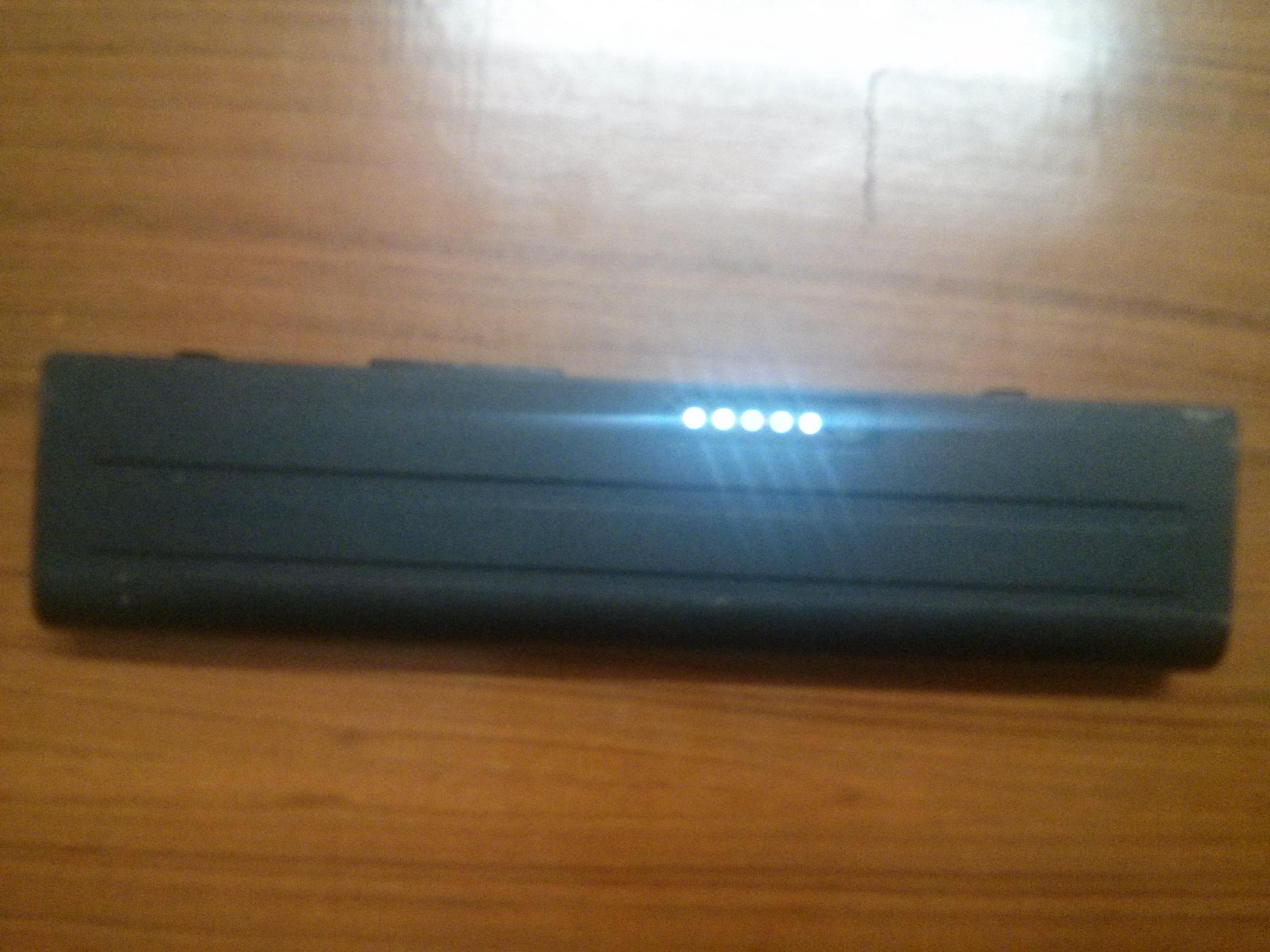

                          Battery is fully charged :+11.8 volts all 5 led on when pressed power button on battery.
                          Charging
                          When connecting battery and charger the white led on charger socket turns on and the voltage on charging jbat1(page 53) connector is +12.59 volts.
                          I have also disassembled this laptop and tested further

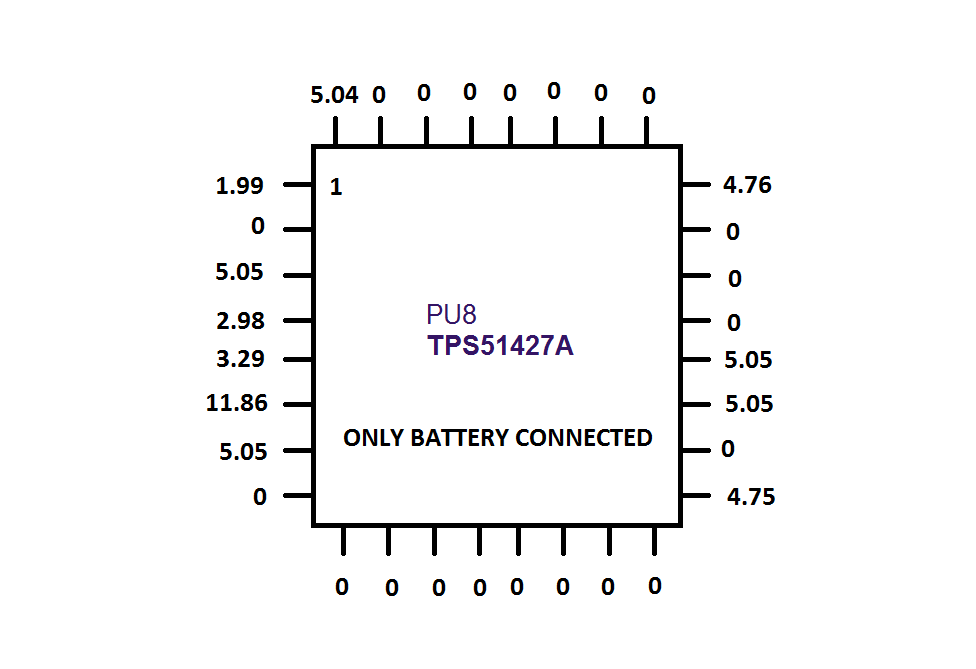

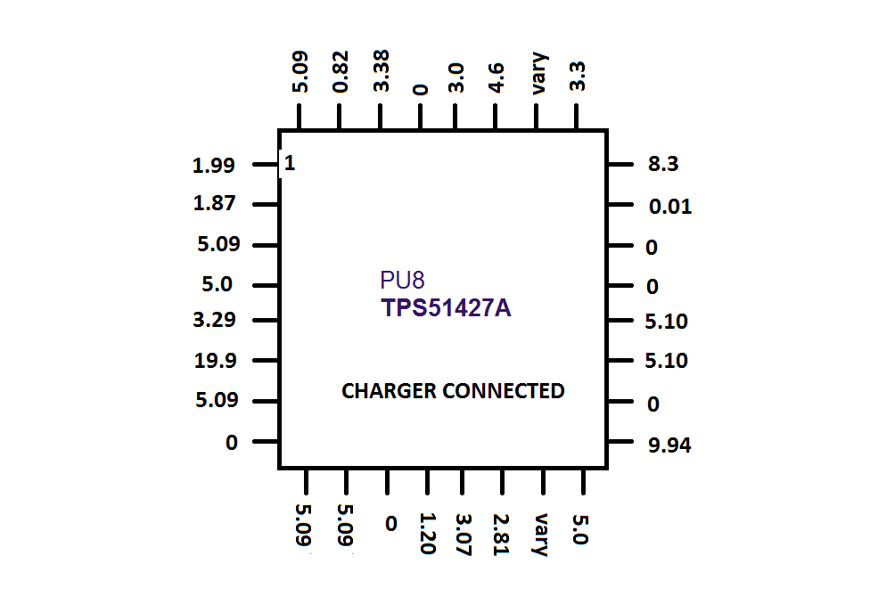

                          ALW
                          when I connect the power adapter +3.3v_alw and +5v_alw on PL9 and PL10(on page 46 of schematic 3.3V_ALW / 5V_ALW(TPS51427A)) respectively is present but when i remove the charger and connect only battery the +3.3v_alw and +5v_alw on PL9 and PL10 is absent. when connecting both alw is present.

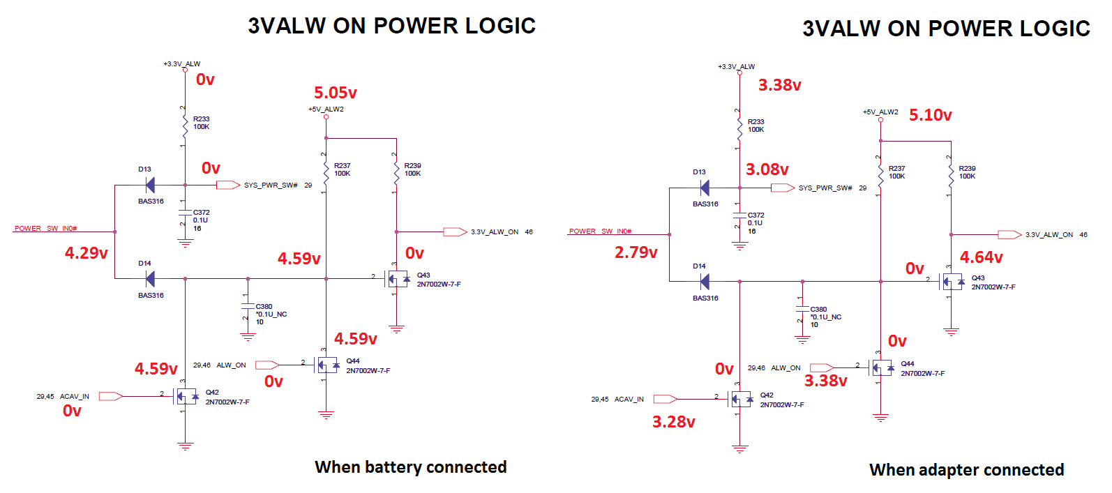

                          Power Button
                          Voltage on power switch is +2.79 volts when both the charger and battery are connected.
                          On battery only +4.28 volts
                          With Charger only +2.78 volts
                          I have also tested some p channel mosfets on the board but I believe they are OK.
                          Please help me locate the faulty component as I am unable to locate the error.

                              How can I test alw_on and +15v_alw.on AC adapter battery is charging does it confirm that the charger IC is working properly or does it require testing.

                                I have tested 3VALW ON POWER LOGIC and here is the result
