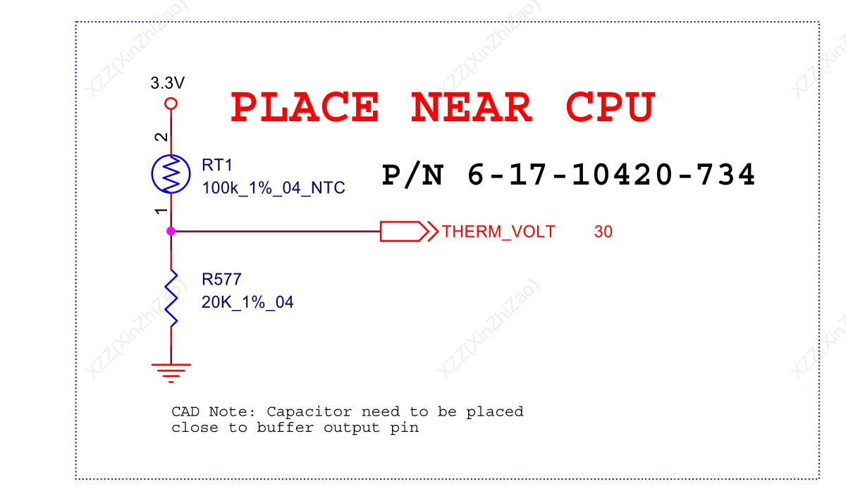

    Not sure if this helps but this is from the service guide. If you are after the RT1 sensor - check near the CPU region.

      Thank you very much! I did find that and a few other components related to thermals but before ripping the entire motherboard out to search corner to corner wanted to see if a boardview is around.
