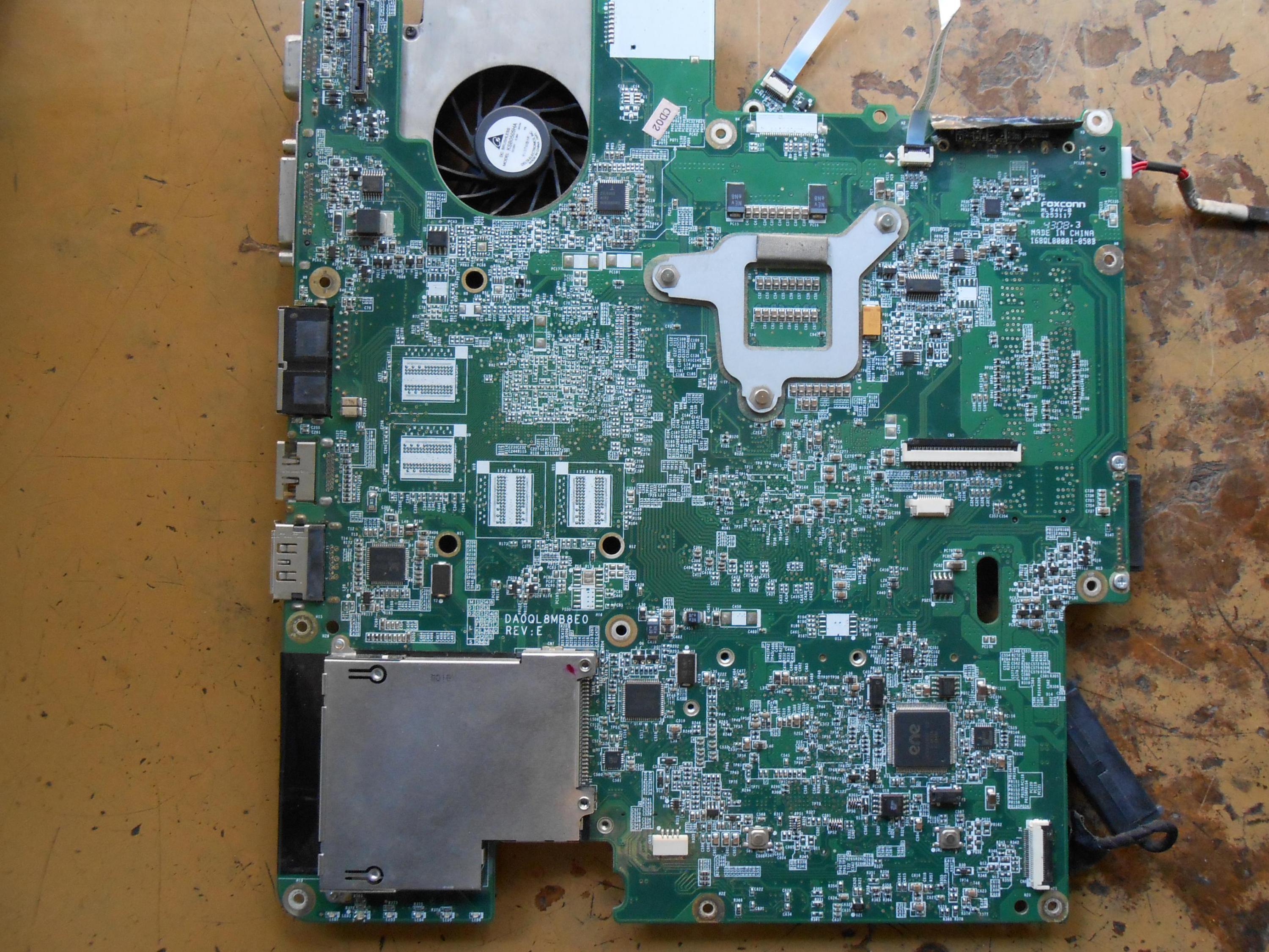

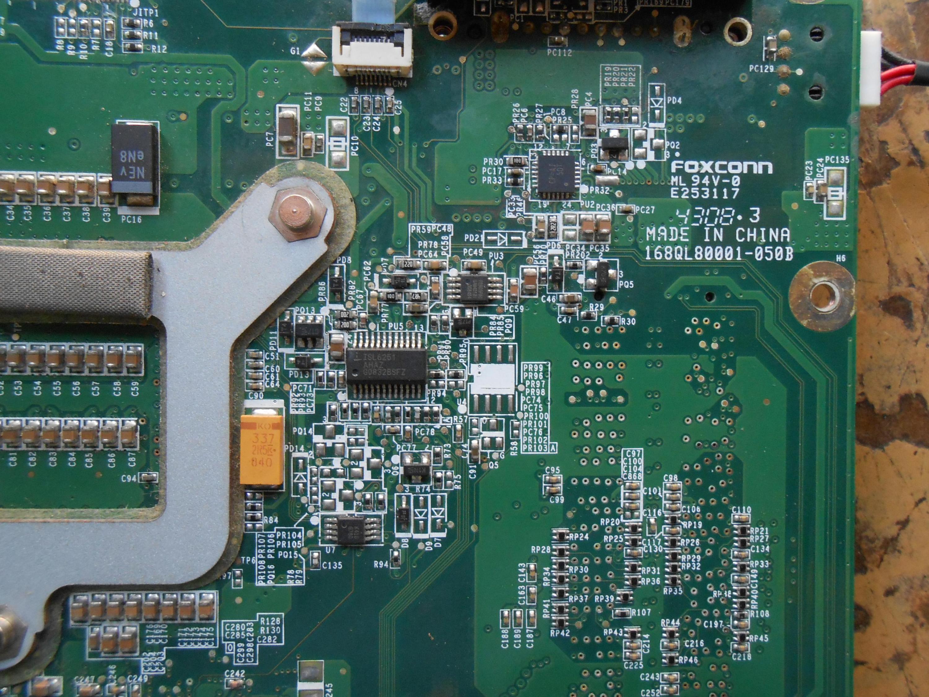

    FOXCONN ML94V-0
    Totaly dead no led .
    i need schematic.

    Re: Foxconn ml94v-0

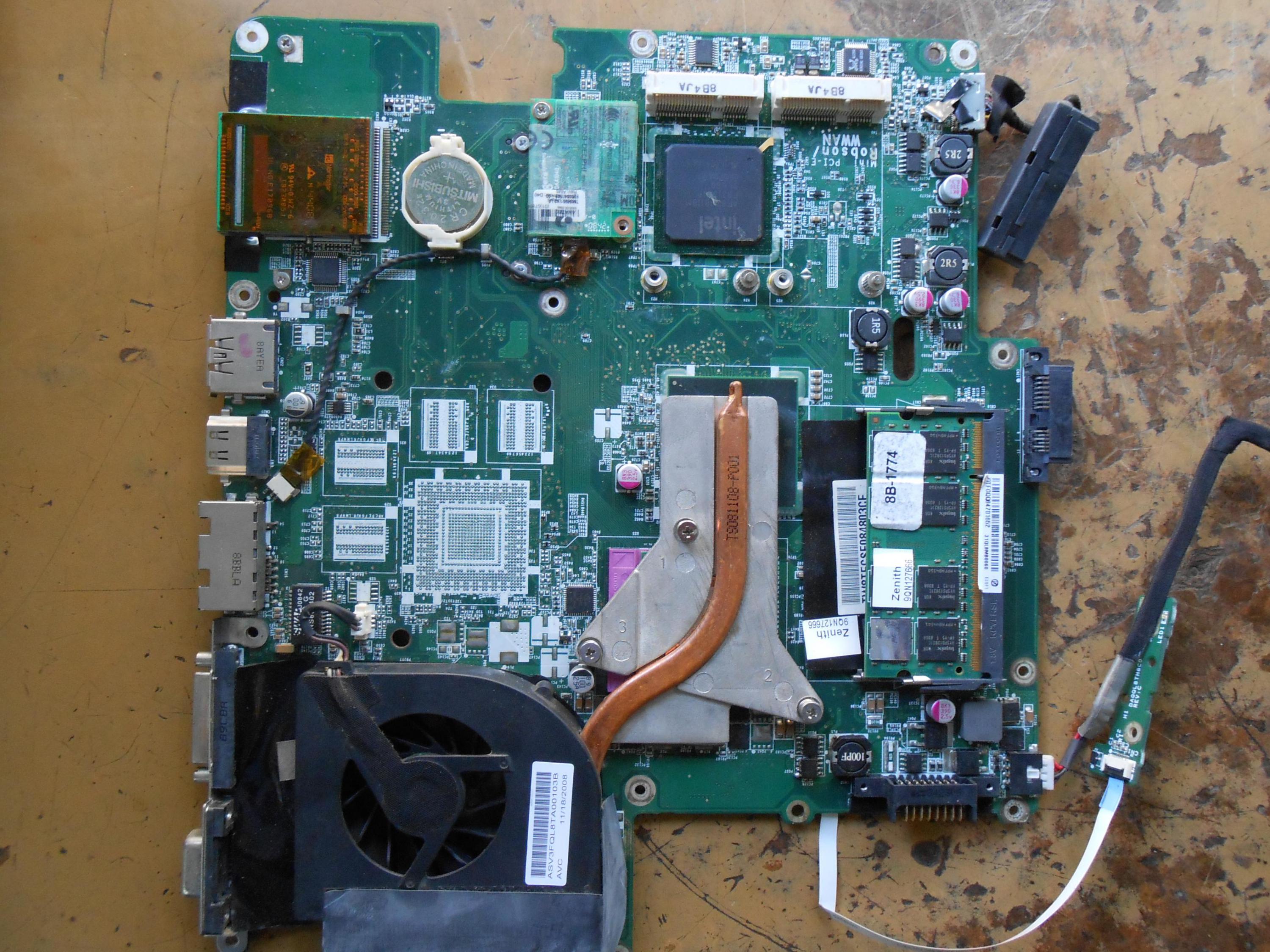

    Thats a Quanta QL8 / TW8 motherboard.
    And this is the discrete GPU version of yours, might help.
    And if you can share the symptoms I can help u. I repaired lots of that motherboard when I was working on a RMA center.
    Most problem is shorted mosfet,tantalum caps and cold solder at Vcore chip.
