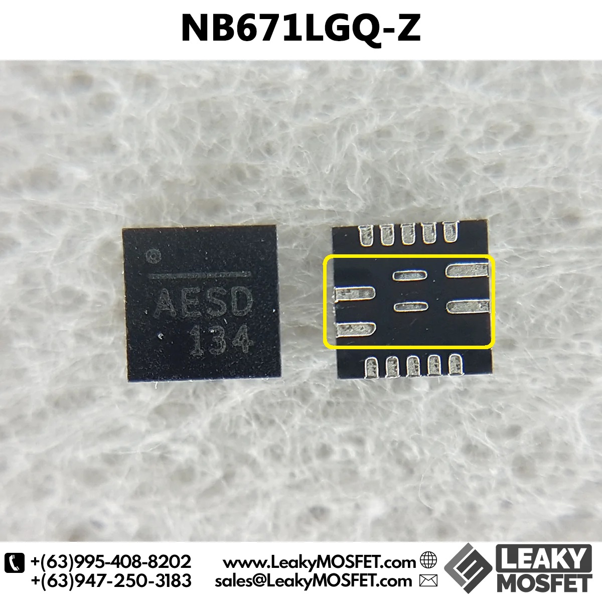

    Hi Everyone Can some one share a Schematic & Board view of HP Spectre 13-3000 or anyone help to identify this IC with the marking code "AF_SD"
    Actually ic is cooked badly i found the board image on google,
    Thanks in advance.

    Its a monolithic power IC -> https://www.badcaps.net/forum/showpo...85&postcount=3 .Don`t know yet what the part number is. Are you sure there`s an underscore between the F and S .The picture is too small.
    Post the motherboard model number !

      I am not sure because this picture i took from google its looks like DOT or Under Square,
      yes it is monolithic power IC but i didn't find the smiler code in list
      Motherboard number
      RANGO_SHIB_HPC MV_MB_V2
      P/N: 010198V00-575-G

        look like marking is AESD not AFSD. If yes, then your chip is NB671L

          NB671L at bottom middle 2 points are SW and different size and not in same line,
          but on the circuit the middle 6 points are same size and in same line and one side 3 points in same line are Ground and the other sides 3 points in same line +V 19volt,
          acutely original chip is roosted so i am not sure about the exact marking,
          any chance for getting schematic & board view?

            this guy have same problem like you.
            https://www.elvikom.pl/hp-spectre-36...=rango&lang=en

              yes you are right Thankyou so much
              i will order the same part and see what happened,
              Again if any one found the schematic please share.
