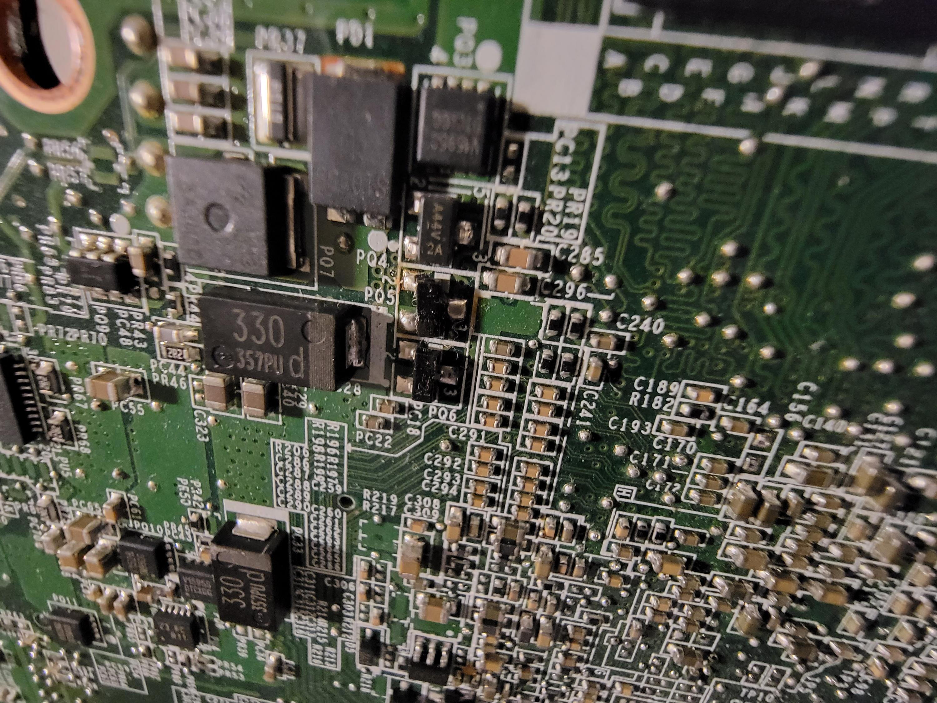

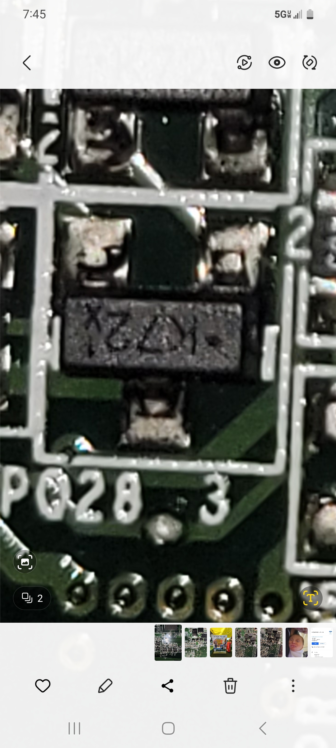

    Acer da0zrimb8e0 rev e schematic
    I'm looking for schematics and board view file for an Acer V5-Aspire 552g. I spilled water on it and killed it about 6 years ago. The computer at first blue screened and now it just has a white screen whenever it is turned on. Looking at the board, I can see one or two transistors that melted. I'm hoping that replacing those could fix the problem. They show k72 with a 1 above an x.

        Re: Acer da0zrimb8e0 rev e schematic
        I've been looking these over the past couple of days. Very helpful. Looks like the mosfets I think are burnt are part of the gpu power enable circuit. 2n7002k n-channel mosfets. Possibly explains the white screen
