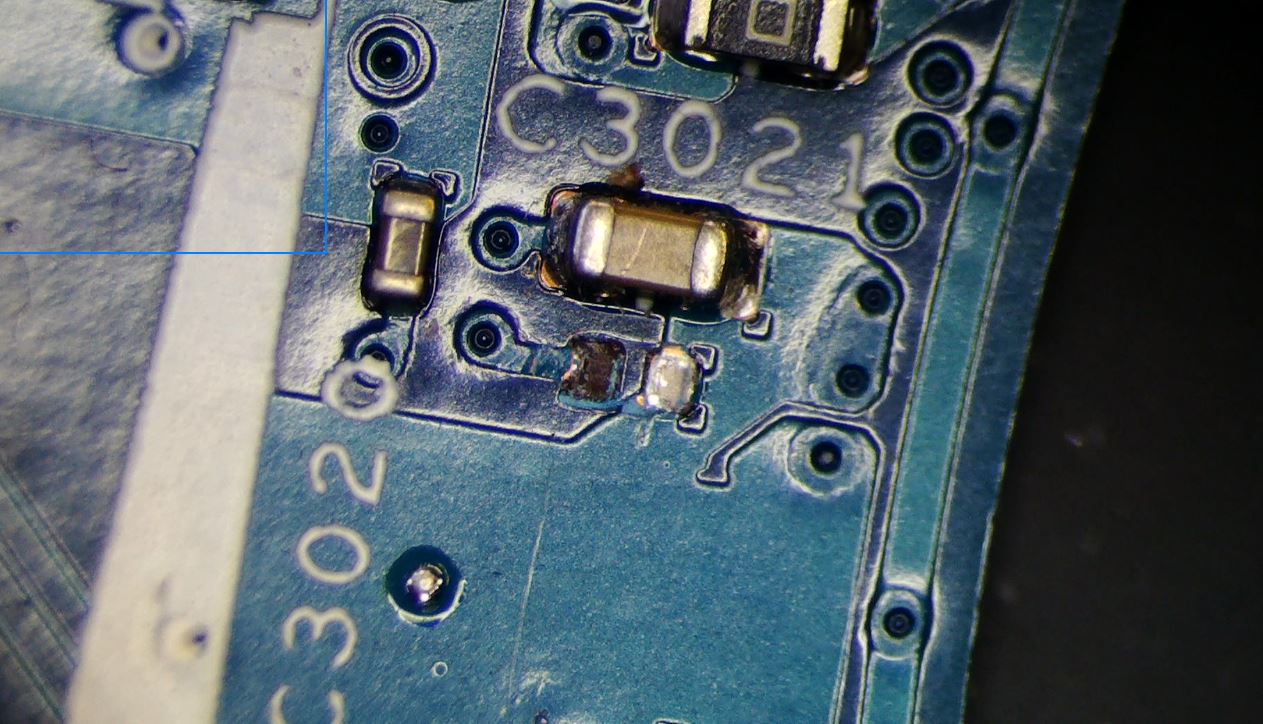

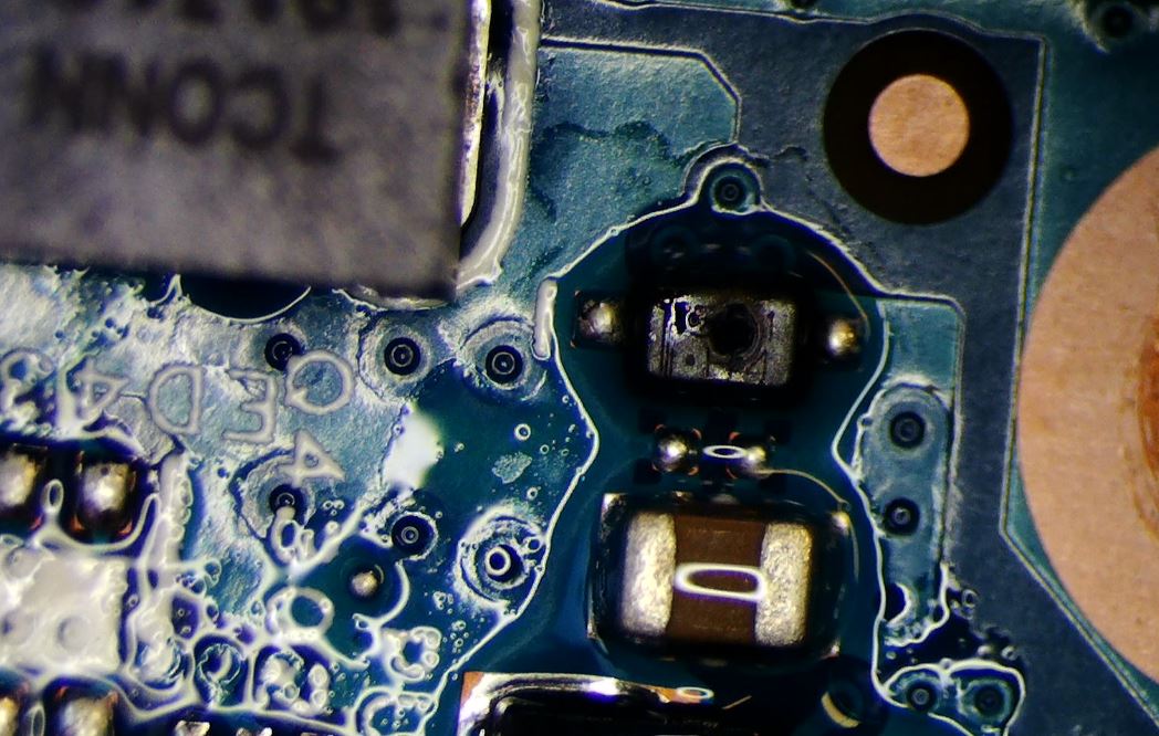

    Hello
    Got this machine dead, no power, no charger led.
    Seems the DCin has been forced reversed, and the 19V were injected to the black and yellow wires pins. suppose its charger ID pin and the other no idea.
    I have 19.5V in, and 16.8V in the main rail.
    No 3.3V no 5V. no shorts.
    found a ripped cap i think, and a burned diode near the battery connector.
    Pics attached
    has someone the schematic or boardview for this?
    Thanks in advance

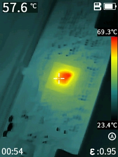

            Ive checked with the help of the pinout and 3.3V LDO is shorted
            kb9028g is the culprit, which reinforces the assumption that DCIN was plugged reversed.
            Apparently this ENE IC needs programming.
            Now comes the fun part, finding it
            Thermal pic of ENE kb9028g attached when injecting 2V@1A
