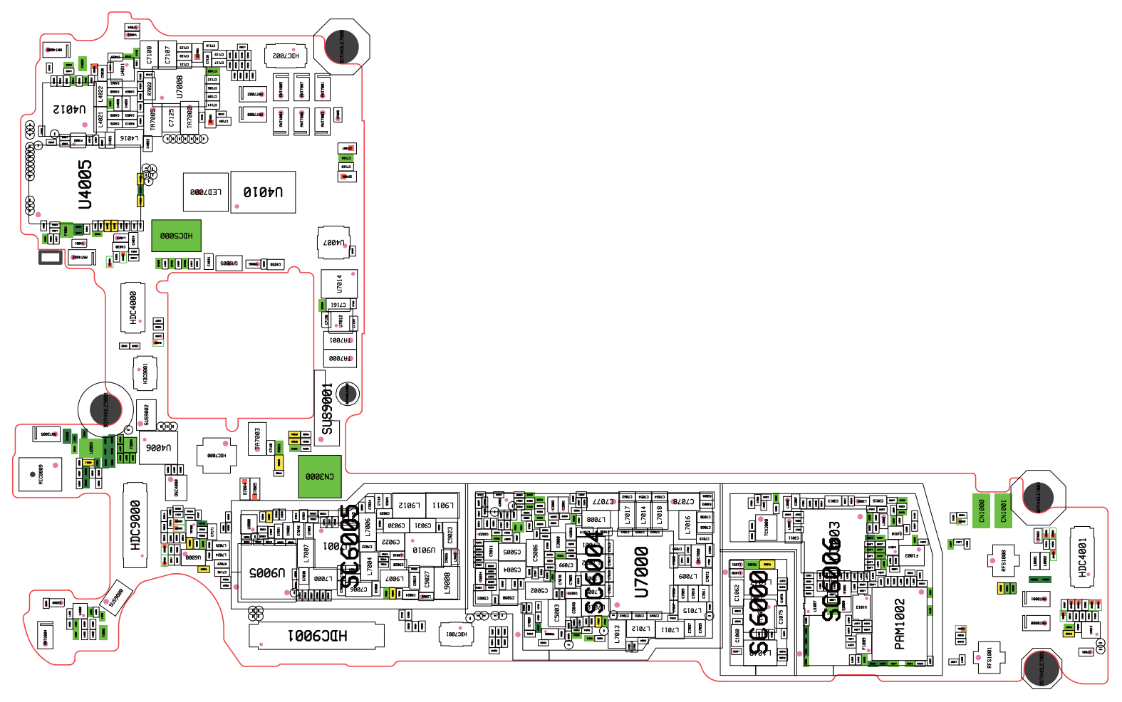

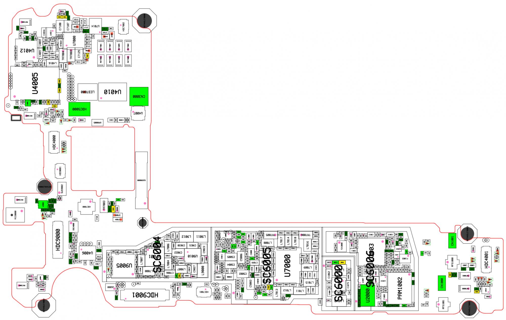

          Re: Paid for wrong boardview for Samsung Galaxy S7 (SM-G930F)

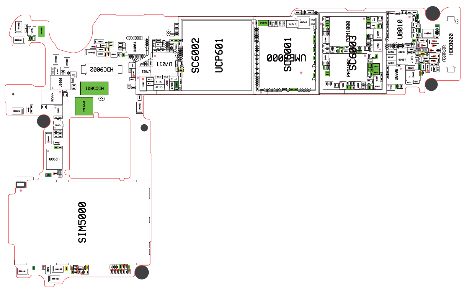

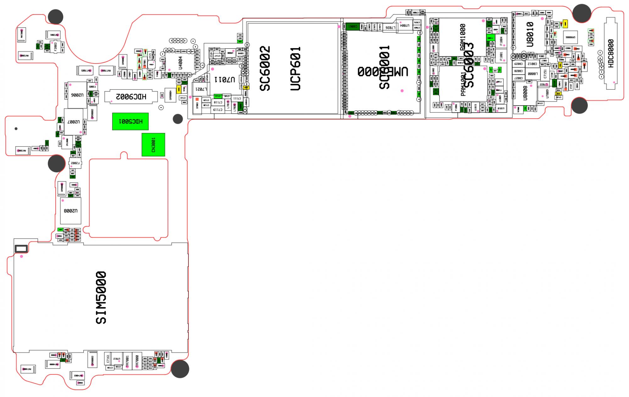

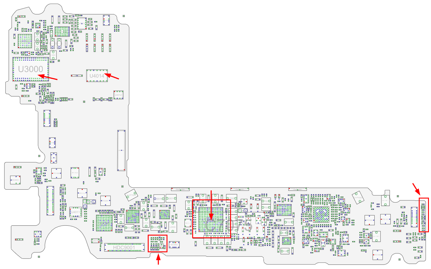

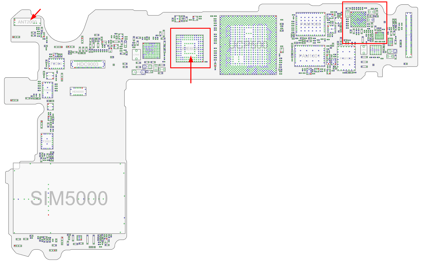

          Boardview not matching the board
          I have pointed out the more obvious deviations. I have used the PCB diagram of the service manual for SM-G930F to compare it to the boardview file.
          TOP SIDE: Boardview
          TOP SIDE: PCB diagram from service manual
          Comments:
          The U3000 is a U4005 on my board.
          The U4014 is a U4010 on my board.
          The components near the power button FPC connector are arranged differently and come in different quantity. There are 20 components on the boardview, compared to only 5 components on my board. The connector itself is named differently: it's HDC8002 on the boardview, and on my board it's HDC7001 if I look at the service manual for Galaxy S7.
          The PMIC comes in the form of a square on the boardview and is labeled U7003. On my board, it's in the form of a rectangle and is labeled U7000.
          On the boardview, there are some 12 components at the very edge of the board, next to the FPC connector for the sub-board. There are no components in that location on my board.
          BOTTOM SIDE: Boardview
          BOTTOM SIDE: PCB diagram from service manual
          Comments:
          No comments. You get the idea. The pictures tell the story very well.

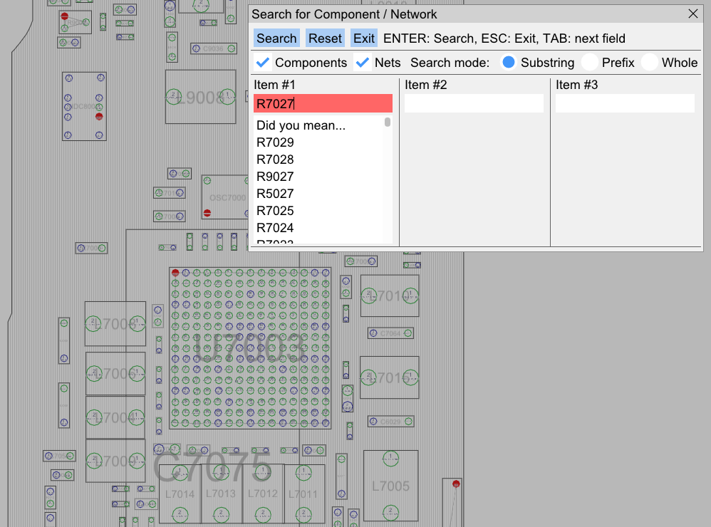

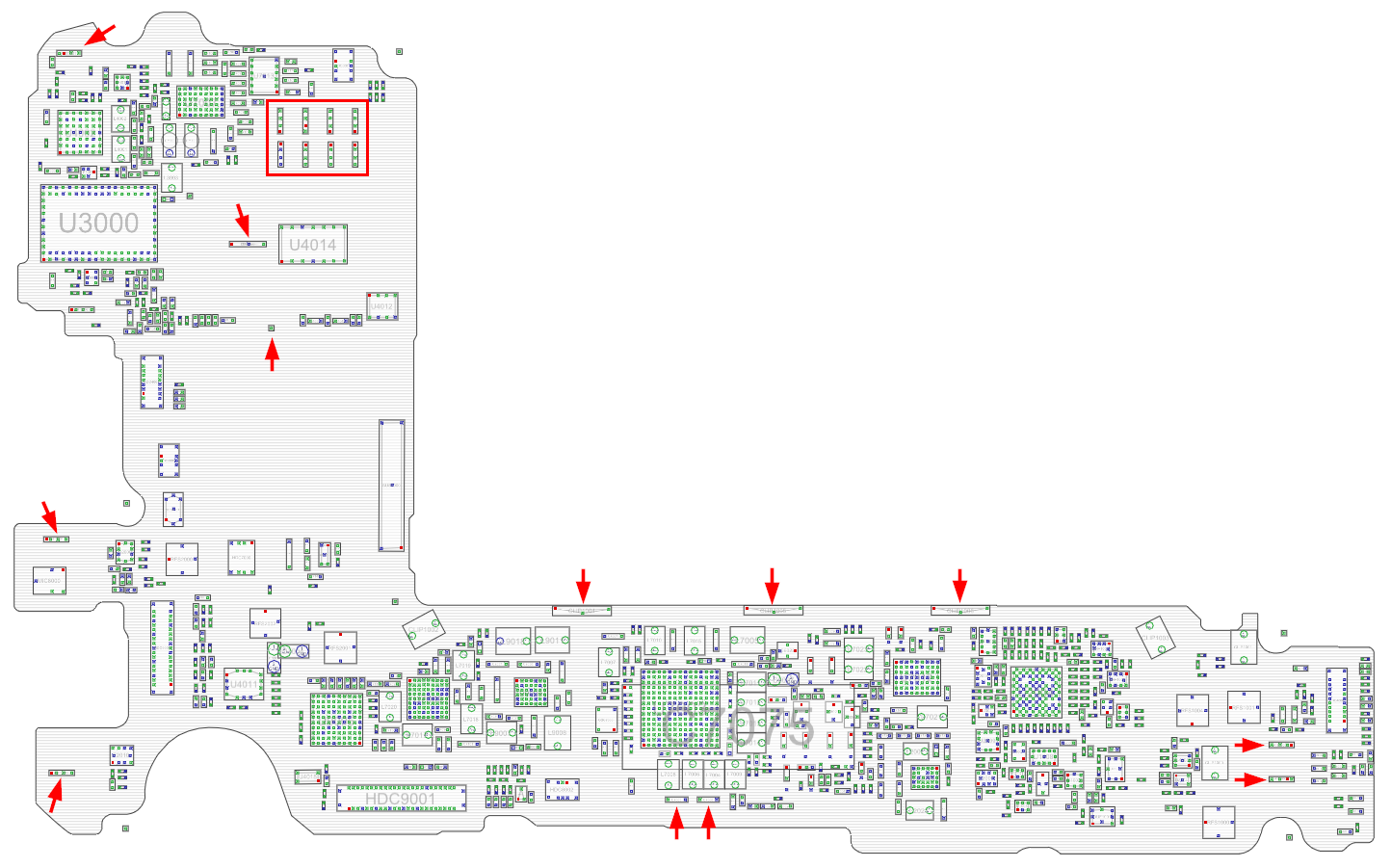

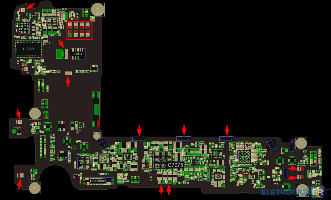

                    Boardview not rendering correctly
                    The boardview I got is not only mismatching my SM-G930F board, it's also not rendered correctly. I think some of the deviations I mentioned previously may be due to bad rendering. But certainly not all of it is due to bad rendering. It's fairly evident that this boardview is for a different revision of SM-G930F (assuming it is for SM-G930F at all).
                    I have prepared another set of images so you can have a look. I used OpenBoardView 9.0.3 to open the BVR file. I compared it to a screenshot of what appears to be the same boardview file, as it was posted on another electronics repair forum (eletronica.br). I can't open the BVRE file, so I can't tell if it would be any different from the BVR file. I suspect that the rendering issue has to do with my software. The guy on the other forum probably used FlexBV to open the same file (or the BVRE file), and for this reason, his boardview is rendered better than mine.
                    TOP SIDE: My boardview rendering
                    TOP SIDE: Eletronica screenshot
                    As you can tell, there are many components on my boardview such as the little capacitors and resistors that appear squashed, or reduced to a small dot. Most prominently, the LED7000 on the front appears imploded whereas the ANT2000 on the bottom side appears exploded. I have not prepared any image for the bottom side of the board. But you can locate ANT2000 in the upper left corner on my previous image, in the previous post (third image from the top).

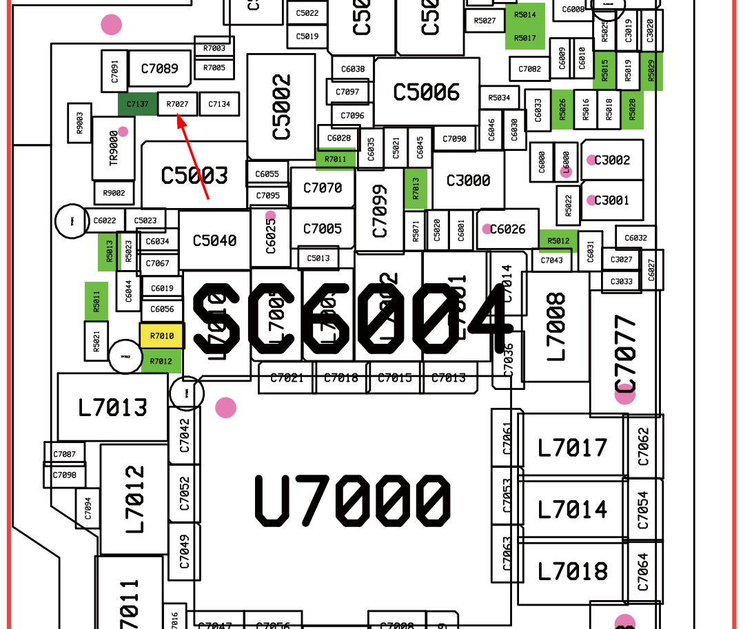

                      I think the most disturbing and funny thing about this boardview file is that it has no R7027! That's another way to tell that the model (boardview) doesn't fit with the reality.
                      If you have the service manual for SM-G930F, one of the first things you're told to do when troubleshooting a power issue is to check the voltage of R7027. Which doesn't exist!?
                      Now you see it:
                      Now you don't:
                      How is that even possible? That makes the boardview incompatible with Samsung's official service manual for SM-G930F. Or do they perhaps have more than one revision of the service manual, one for each SM-G930F board revision? I don't know, but it's an odd thing for sure.

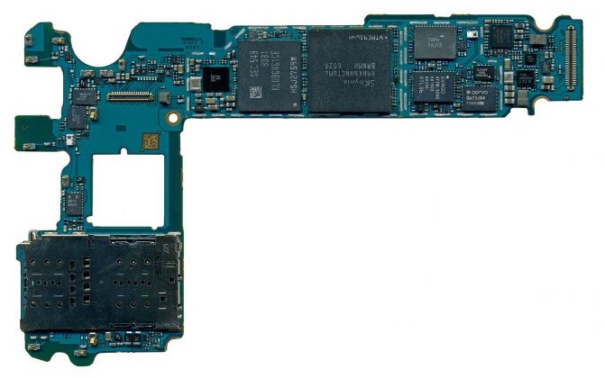

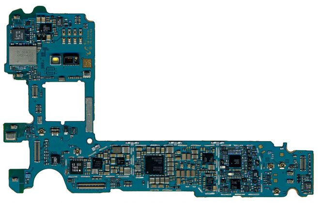

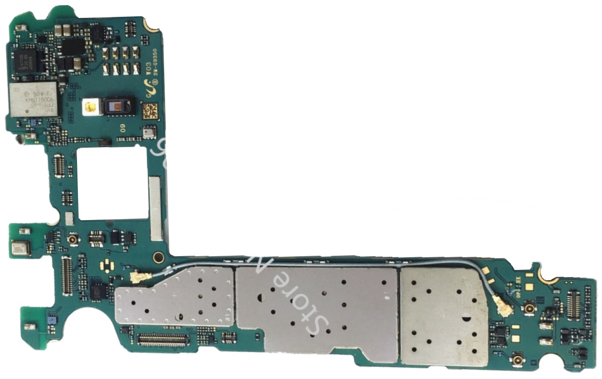

                        TOP SIDE: Boardview
                        TOP SIDE: PCB diagram from S7 Edge (SM-G935F) service manual
                        TOP SIDE: Photo of Hong Kong version of S7 Edge (SM-G9350)
                        TOP SIDE: One more Hong Kong version of S7 Edge (SM-G9350)
                        BOTTOM SIDE: PCB diagram from S7 Edge (SM-G935F) service manual
                        BOTTOM SIDE: Photo of Hong Kong version of S7 Edge (SM-G9350)
                        BOTTOM SIDE: One more Hong Kong version of S7 Edge (SM-G9350)
                        I believe that the global version (F), the India and Southeast Asia version (FD) and the Canadian (W8) version of the phone all share the same board. There may be only minor differences between these three. So in effect, we only have two versions: the Hong Kong version and the global version of S7 Edge. I may be wrong. But I have seen them marked as "SM-G935F/FD/W8_REV08A". Maybe it depends on what revision it is. I have also seen SM-G935K and SM-G935L appear on some listings on AliExpress.
                        Another way to tell the difference between the global version and the Hong Kong version is that the global version has a rectangular PMIC marked S535. The Hong Kong version has a quadratic PMIC marked MAX77854. Again, this may depend on revision of the board. I have seen PMIC chips by Qualcomm appear on a number of these boards as well.
                        By the way, the "D" marking in "SM-G935FD" probably means "Dual", as in dual SIM slot. I am not sure though. But it would seem like a logical conclusion, seeing that it's marketed for India. Otherwise, I'm not sure how you can tell the difference between them. These versions are very similar (if not identical).
                        The takeaway from all of this is that this boardview file is not for the S7 but for the S7 Edge, and it's not for the global version of S7 Edge but for the Honk Kong version of the phone, for which there are no service manuals freely available (assuming one was even made).
