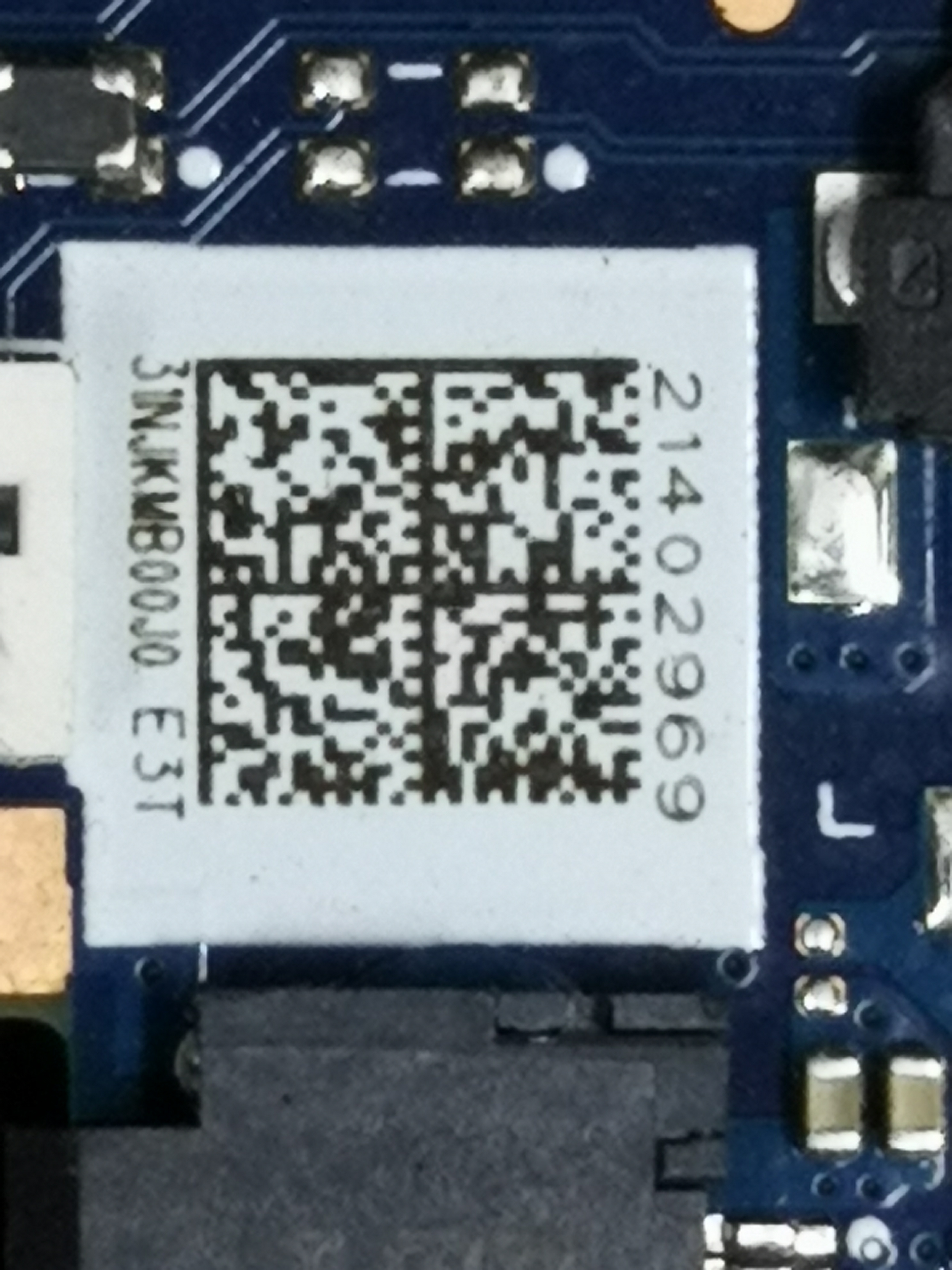

                              Post a clear picture of the QR code sticker on the motherboard, or scan it with your phone and post the contents here
                              Click image for larger version  Name:	fx517zm.jpg Views:	0 Size:	230.0 KB ID:	3739525
                                thanks for reply this is the QR code

                                  QCCNJK0JT21402969,N414NRCX003MD2MB,FX517ZM,60NR09Q0-MB1503,131,5
                                  811223E53BA
                                  Post # 6 from here should have worked, or post 26 from the other thread https://www.badcaps.net/forum/troubl...e2#post3641172
                                  Both are ASUS service F1 BIOS, just different version, if that doesn't work then the BIOS is not the issue, you may have a hardware problem
