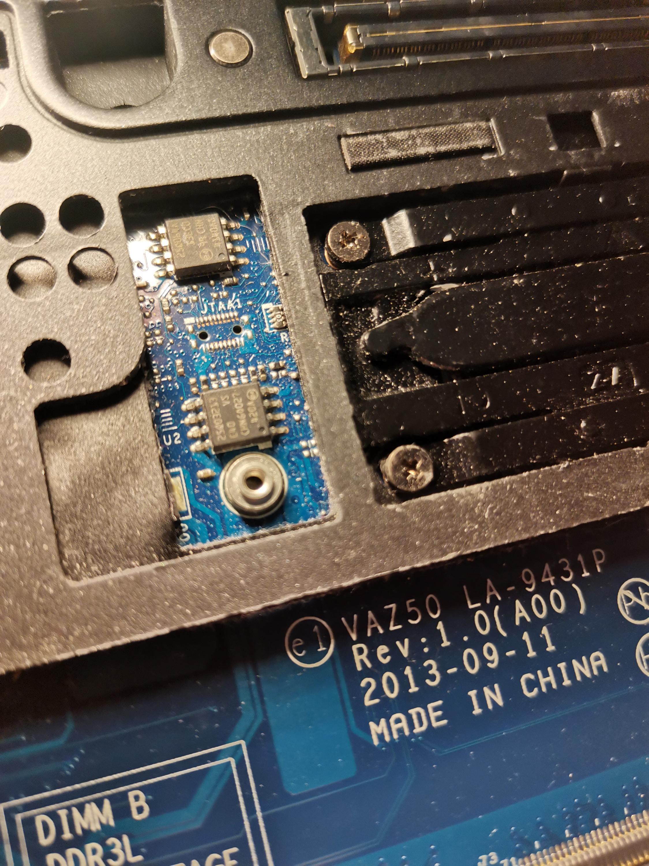

    Dell e7240 FW Status error
    hi guys, FW status error started appear during boot, I think because bad cmos battery. Battery has been changed but fw error is still there..
    I know that I have to flash bios via programmer, I have minipro, but I am not sure which chip contains intel me firmware.
    Could someone help me ? Thanks a lot

    Re: Dell e7240 FW Status error
    Can't read what's written on the chips, take a separate clear image for each chip.
      hi, U1 chip (on top) - 25q064A, U2 chip - 25q03213 thank you
        You should upload both chips to combine them, U1 is 8MB and U2 is 4MB.
          okay, here is readed dump
            Here's your new files, try them and let me know the results.
              Hi, great, it is working well. Thanks a lot.
