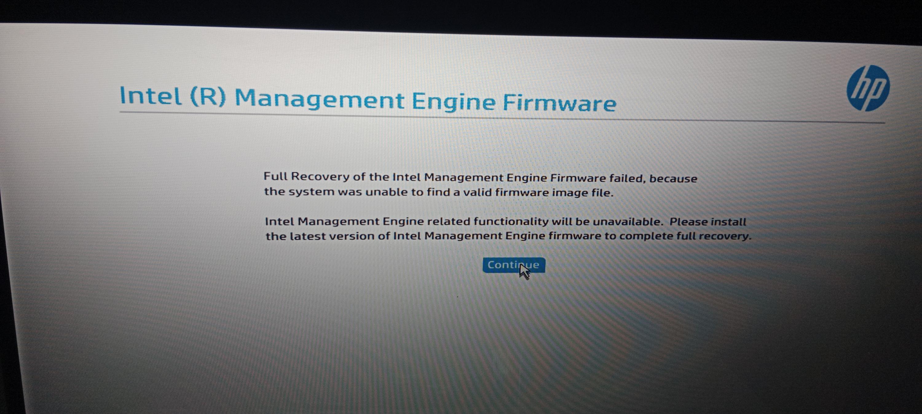

                    • Bolanle
                      • Apr 2023
                      • 17
                      • vn
                      Re: bios password hp elitebook x360 1040 g6
                      Originally posted by farouk_1994
                      Try and feedback
                      Showing this error
                      • Bolanle
                        • Apr 2023
                        • 17
                        • vn
                        Originally posted by Bolanle
                        Showing this error
                        Please help me
