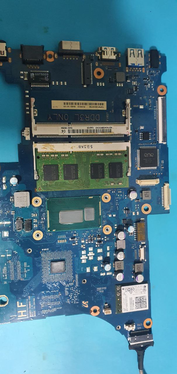

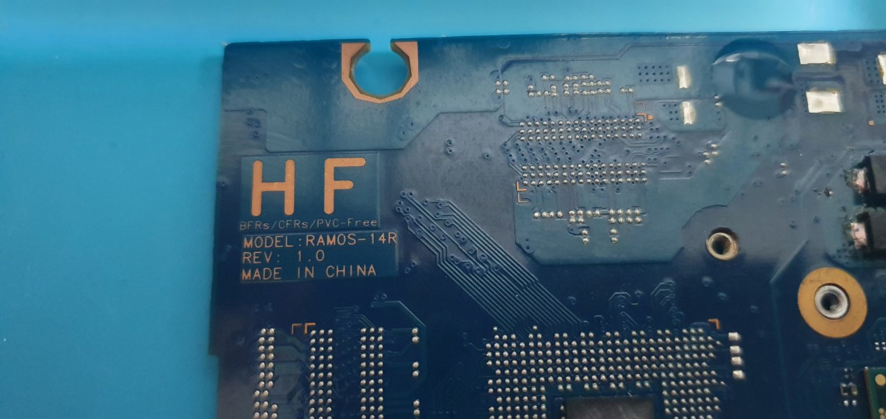

    samsung nt450r4j need bios
    please help me find bios.
    thanks in advance
    ramos-14r rev 1.0
  • peste
    • Dec 2016
    • 13924
    • ROMANIA
    Re: samsung nt450r4j need bios
    thanks in advance
    ramos-14r rev 1.0
    try..
    • Djamalhan
      • Dec 2021
      • 79
      • Узбекистан
      thanks for the bios . still reboot post code 30 ..
      EC KB9010F C4 there is a bios ?
        • 22286
        thanks in advance
        ramos-14r rev 1.0
        try this bios
        • Djamalhan
          • Dec 2021
          • 79
          • Узбекистан
          Originally posted by SMDFlea
          try this bios
          thanks ..everything started laptop :рок:
