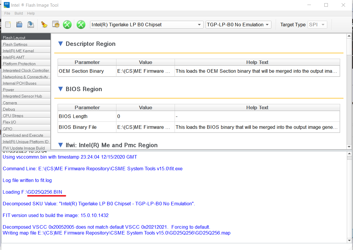

                                        Originally posted by haithem
                                        does not work also , same result
                                        Latitude 5420
                                        Service Tag: 7ZHG1F3
