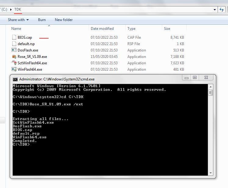

          I do have a ch341a but Ive been trying in vain to get a read using a pomona soic clip.(not so good at soldering (bad nerves)
          I have a donor board that is ok so thought to use boot kit to create a bios back up. It gives me a rom file.
          The board is Acer Aspire 3 A315-22 - NB8607. Unfortunately acer only provide an executable bios which needs windows up and running and i dont know how to convert that to bin.Just to add I have attached the bios file from acer if anyone knows how to convert it to bin

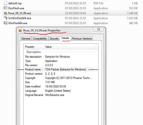

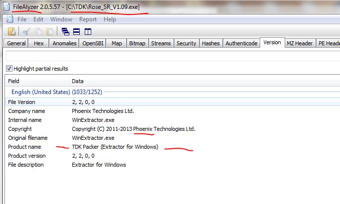

              • 22279
              Re: acer bios question
              Originally posted by Mazorca
              Here is what I was able to get out, it looks like it might not be a complete bios.
              Its a phoenix TDK bios.Extract it using the command line .
              With the CAP file delete block 0 - 317 (L = 318) ,then select block 0 - 7FFFFF (L = 800000) .Its an 8MB update i think .
              How to extract and edit a Lenovo Phoenix TDK Bios - https://www.badcaps.net/forum/showthread.php?t=80861

                • Mazorca
                  • Jan 2017
                  • 463
                  Re: acer Aspire 3 A315-22 - NB8607 bios question
                  Thanks for the lesson, I looked for BIOSIMG but couldn't find anything. This is why I like this forum. I used Bios utilities from platomav.
                    • 22279
                    Yeah he`s added a Phoenix TDK Packer extractor now https://github.com/platomav/BIOSUtilities
