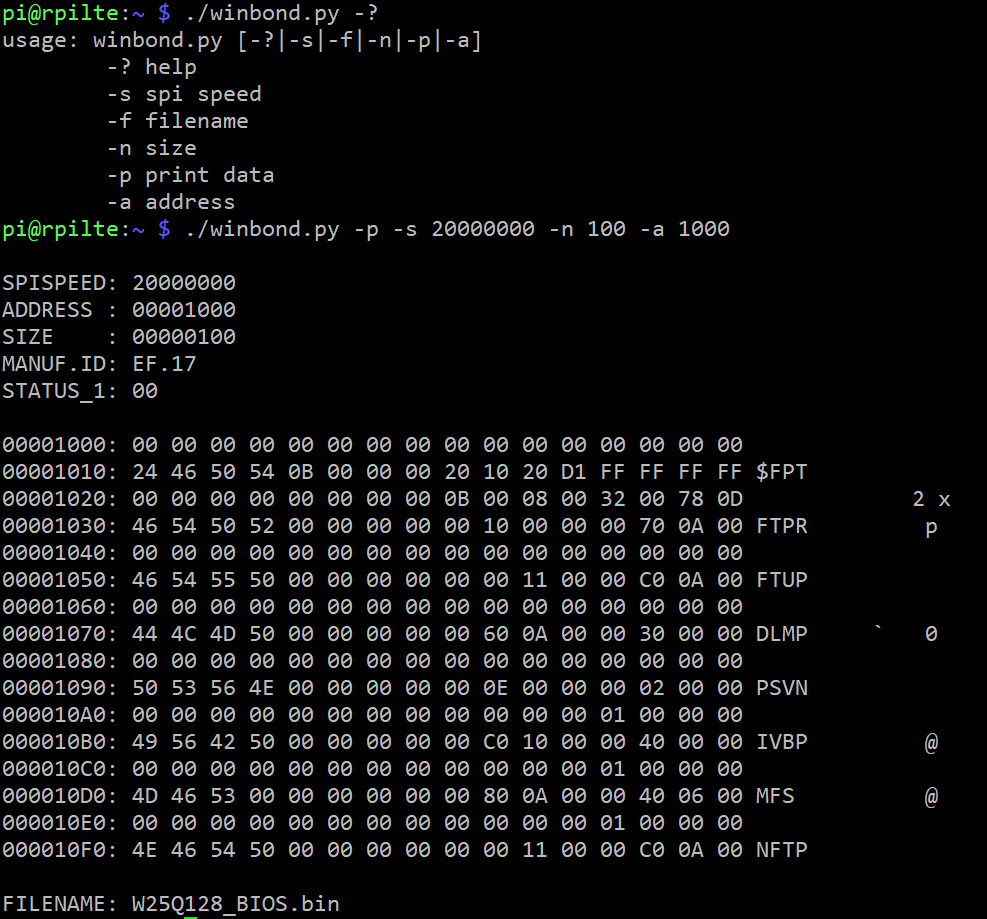

    To make a W25Q128JVPQ dump I've used CH341A (with 3.3V modification) and Raspberry PI.
    - CH341A (both Windows and Linux) doesn't work
    - rpi + flashrom detects it only from time to time. I was able to read the content once.
    - bus pirate works fine however only with lower serialspeed param
    Code:
     flashrom -p buspirate_spi:dev=/dev/ttyUSB0,spispeed=8M,serialspeed=250000 -c W25Q128.V -V -r bios.bin
    To verify the content I wrote the python script that makes a dump and surprisingly it works every time with no error.
    I'm attaching the winbond.py - maybe will be useful for someone.

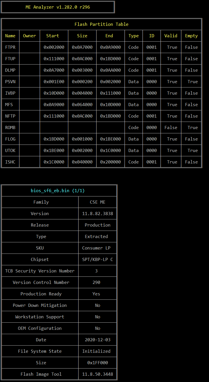

    My question: Does the BIOS need "ME Firmware cleaning" to fix the Surface boot issue.

    Re: Surface Pro 6 + W25Q128JVPQ BIOS
    According to the post https://www.badcaps.net/forum/showthread.php?t=88533
    "CSE ME / 11.8.82.3838 / Consumer LP / SPT/KBP-LP C" so the "ME Region.bin" file should be "11.8.82.3838_CON_LP_C_NPDM_PRD_RGN.bin" .
    New outimage.bin build via FIT.exe has "File System State - Configured"
    W25Q128JVPQ has ben flashed and connected via pogo pins but laptop still doesn't boot.
    Attaching original and MEclean - as I'm not sure if it's correct.
    Is it possible run such flash via pogo pins (connection was tested) or it rather must be soldered.

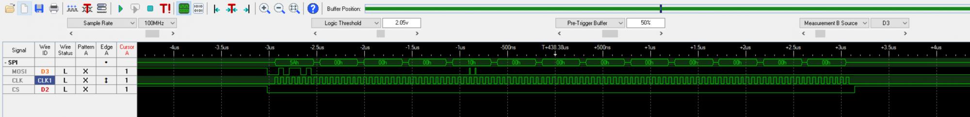

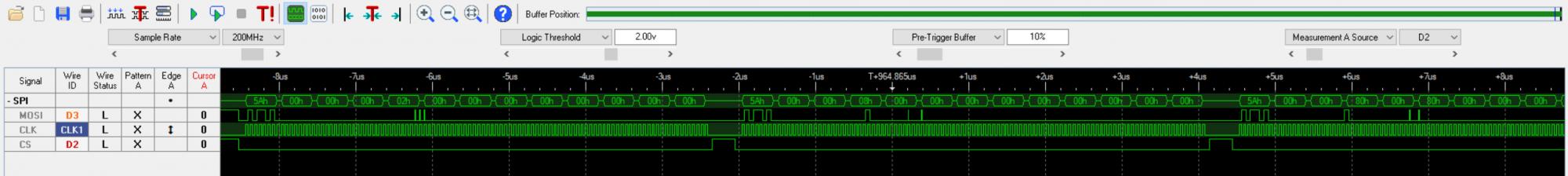

          After flashing new chip laptop displays windows logo twice and hangs (the logo is visible all the time till power off)
          Logic analyzer connected with flash SPI see only command - Read SFDP Register (5Ah).
          Platform Controller Hub should read the Intel Flash Descriptor (at offset 0x10) to verify that there is a valid flash - no idea why we do not see it.

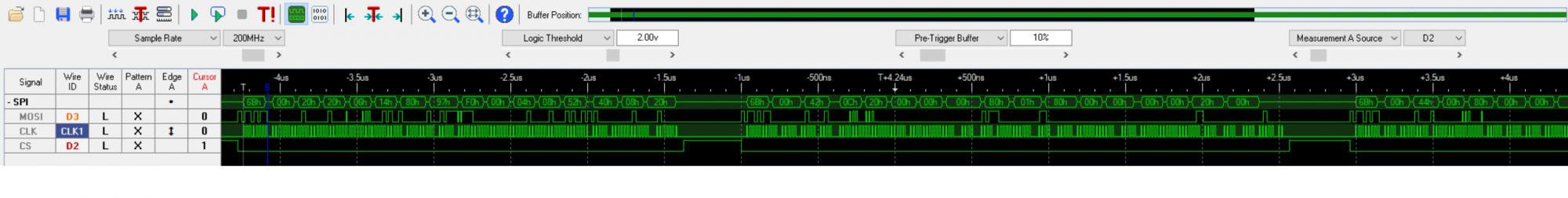

            Flash with bios_sf6_eb_Compare.bin has been soldered and still the same issue - laptop shuts down after windows logo.
            Tried to sniff SPI and communication looks fine. After "Read SFDP Register" (5Ah) it goes to "Fast Read Quad Output" (6Bh)
            Would it be possible to use some working dump from other machine or the original need more modifications ?
