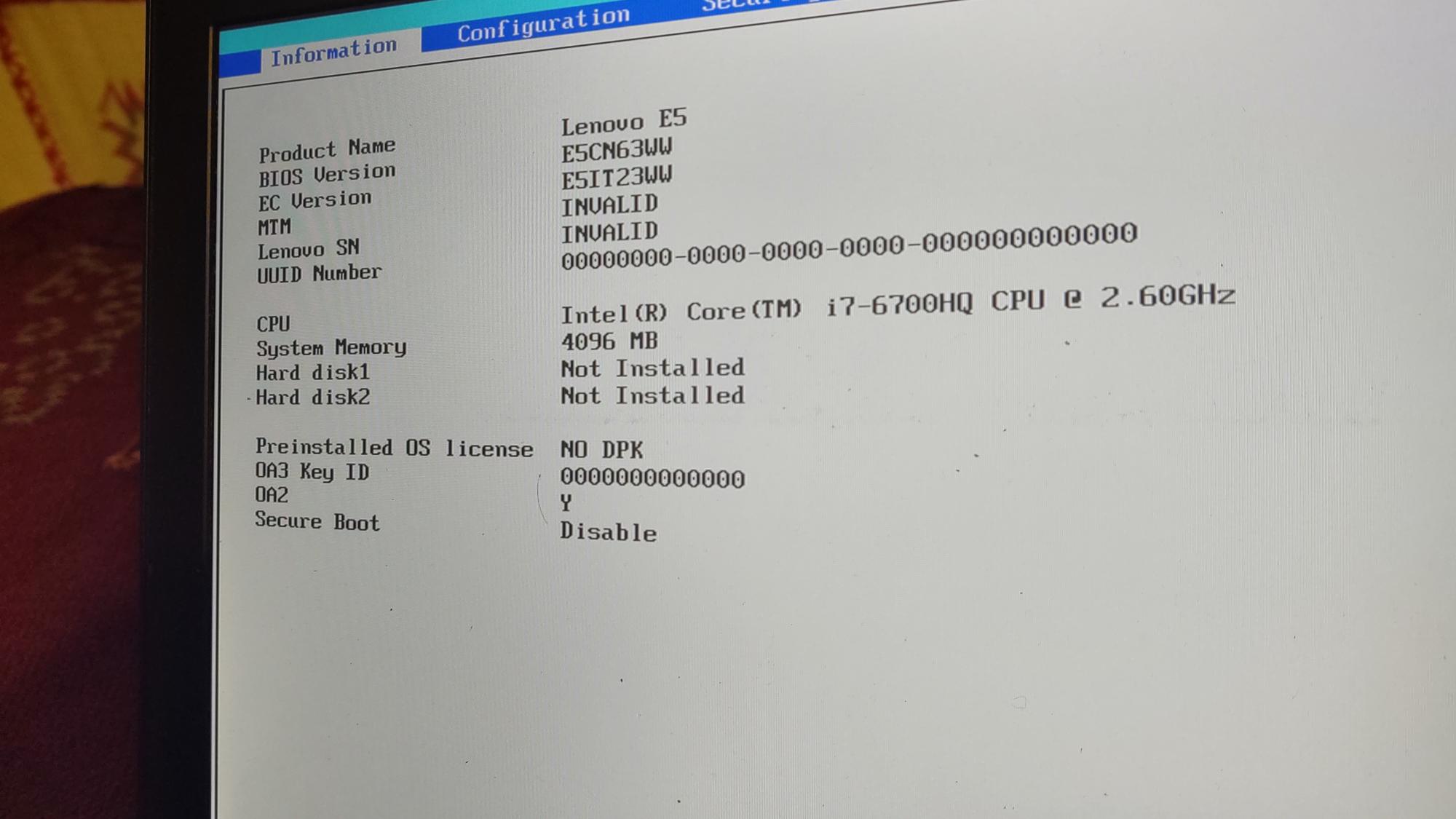

    Dear Gents
    I rescued a Lenovo Ideapad 700-15ISK Type 80RU.
    The matter is that Bios is displaying:
    Product Name - Lenovo E5 - Wrong, it should be the above name
    MTM - INVALID - should be replaced by the number on the sticker on the backside of the laptop
    Lenovo SN - INVALID - should be replaced by the number on the sticker on the backside of the laptop
    UUID Number - 0000000-000 etc, this one might have been lost because i don't have it anywhere.
    All te info can be seen in the attachement.
    Now, can someone please add the Name, MTM and SN to the bios file so they will be updated as they should. Any help or indication would be greatly apreciated.
    The OEM update file of the laptop is available at: https://download.lenovo.com/consumer/mob...cn63ww.exe
    If you think that other stuff needs unlocking, etc. please feel free to modify as you desire, as I don't have any other requests.
    Also after searching the web I fear that the bios or EC may have been corruputed or badly flashed, not moded tho.
    Thank you in advance for the help and support

    Re: Ideapad 700-15ISK Type 80RU MDM - INVALID
    post the copy of the original bios here
          Originally posted by internetdivisor
          I also attached the RW-Everything report. This is as far as I know to extract information from the actual bios.
          you need to make a bios copy with the programmer and then you can add sections where SN, MTM and Name are given
            Dear fire, thanks for the info but unfortunately I am a home-user and and I don't have any hardware tools.
            Can this be accomplished by editing the files that i attached here by someone who knows what he is doing?
            Sadly so far I wasn't able to find some software, program etc to make a dump or backup of the actual BIOS that is running (i mean the actual settings) given that the File Type: zip E5CN63WW.zip (3.33 MB, 2 views) is updated at this time and runs the laptop.
            LE: I also have an identical board, bricked that is, that has the correct BIOS written with the correct details. Are they ok for swap? - If available this should be the last resort if all else fails.
            Thanks for any info or help

                            • 22279
                            The bios you posted at #3 is a .CAP file not a full bios backup,its a bios update extracted from the lenovo bios update exe.The bios at post #8 is corrupt. Try this bios at post #8 https://www.badcaps.net/forum/showthread.php?p=890606 .
                            The DMI info is DMI 801000 - 8011FF Length 200 ,the win key NWYDW-8JW** ,if the bios is updated to the latest version the win key is in a slightly different place .No need to use lvar or any other DMI tools,just a hex editor.

                                Should I use Plhash in a bootable DOS USB for both files with the command : phlash "filename".bin for both the files you provided?
                                  • 22279
                                  The most reliable way is to use an SPI bios programmer,such as a chepo CH341A + clip + optional 1.8V adapter. You can try from windows or dos but you could brick it. Rename the bios to clean.bin ,and edit winflash64.bat to this:
                                  WinFlash64 /file clean.bin /bak /all /cvar /bbl /bcp /sd /sn /silent /cac /cbp 30 /shutdown
                                      Ok, nothing happens. If I run the command from DOS it says /all command is invalid and if I delete the coomand and run the update it says:
                                      ERROR 233 - Only secured capsule is allowed on a SecureFlash system!
                                        • 22279
                                        Ah yes i forgot. You can flash the CAP file to update the bios but not the .bin .You`ll have to use an SPI programmer to flash the .bin
