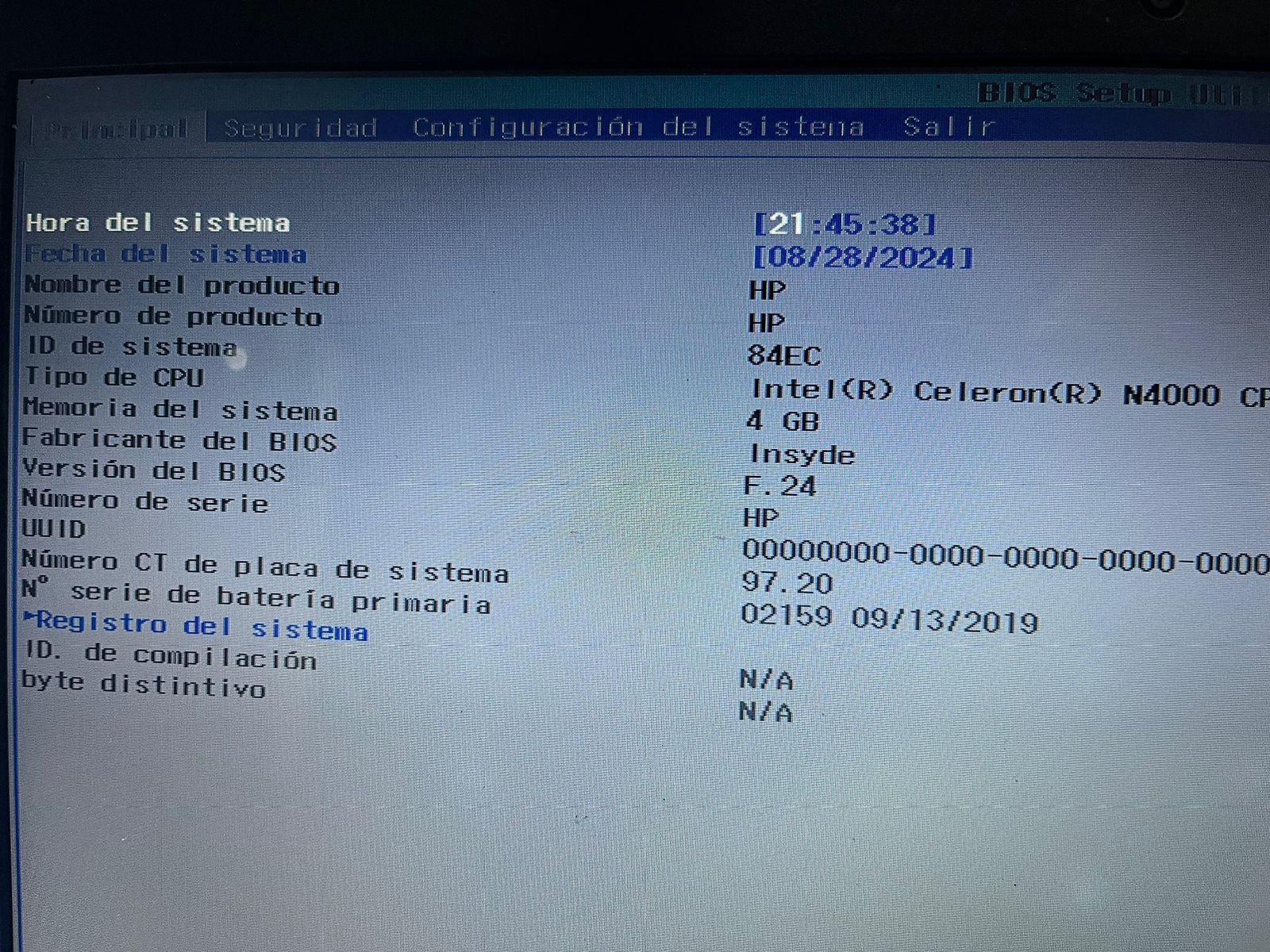

                  • JaironGT
                    • Feb 2021
                    • 3
                    • gt
                    Hi, Someone have dump for the da0p9cmb6c0 rev c, from the HP STREAM 14-CB161WM.
                    Thanks.
                    • kalilinux25
                      • Mar 2018
                      • 2093
                      • ZAMBOANGA SIBUGAY
                      Thanks.
                      where is your backupin and serial number should be posted and issue , please try this if it works for you
                      • JaironGT
                        • Feb 2021
                        • 3
                        • gt
                        Sorry serial Number is: 5CD0028FLQ.
                        Issue: Not Product Info, error in update bios, not battery charging.
                        not let me update BIOS.
