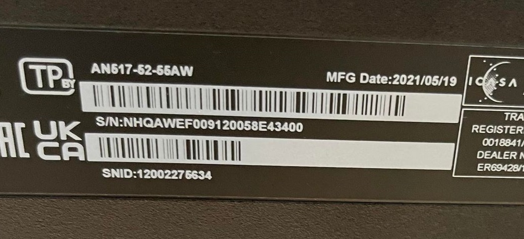

    Hi
    Need Bios for ACER nitro 5 AN517-52-55AW
    La-K862P
    not work
    Power button work, lights up, keyboard lights and cycle/reboot
    no display, no caps lock
    thanks

    Re: Acer nitro 5 an517-52-55aw
    Hi
    Post your bios backup,and the serial number on the case
      ok work with other bios
      SN NHQAWEF009120058E43400
        Nitro AN517-52
          • 20914
          Originally posted by hoaca388
          Nitro AN517-52
          AN517-52 Part Number: NH.QAWEF.009
          W 370000
            AN517-52
            W 370000
            why big eyes ^^
              why big eyes ^^
              surprised that hoaca388 missed something
                Thank you. you are wonderful SMDFlea and Hoaca388
