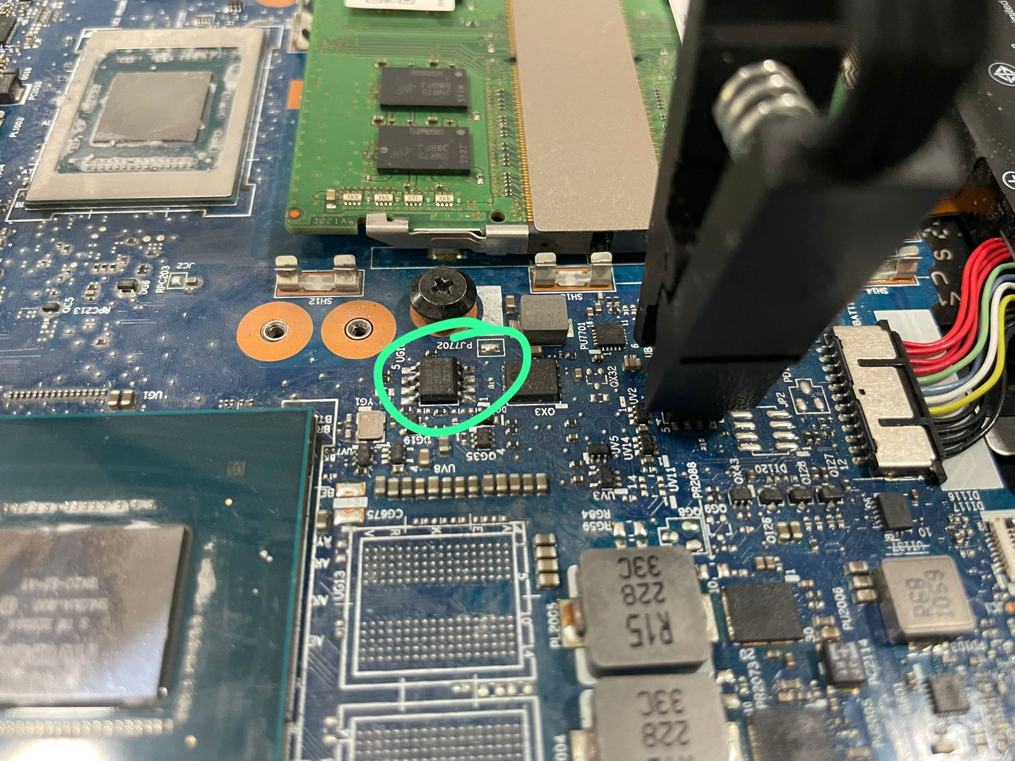

                        Greetings, can you help me rebuild my bios? The machine turns on without video. The fans work. The keyboard lights up. My computer is Legion 5pro 16ach6h series PF3425J6 motherboard nm-d562 rev 3.0. Thank you in advance.

                          LEGION 16ACH6H
                          sn PF3YLNHV
                          NM-D562 rev 3.0
                          Help me bios, please​

                            #113

                              #114
                              Originally posted by Aníbal Barnés Asenjo
                              LEGION 16ACH6H
                              sn PF3YLNHV
                              NM-D562 rev 3.0
                              Post your origin backup bios.

                                #115
                                I am attaching a backup of my BIOS, but I cannot guarantee that it is the original one since a previous technical service flashed the BIOS for me

                                  #116
                                  Legion 5 Pro-16ACH6H Laptop (Lenovo) - Type 82JQ

                                    #117
                                    With this firmware, nothing powers on, only the power button.
                                    With this firmware, the computer heats up the CPU and GPU, the fans start, and the keyboard lights up, but there is no video signal...​

                                      #118
                                      I've spoken with the technical service, and they have sent me the original BIOS backup.

                                        #119
                                        After speaking with the person who flashed it, they told me that the backup was taken from the chip marked in the photo, which is why it's only 2MB, and then they wrote the main firmware there, which is 16MB.
                                        The other chip, where I have the programmer, has the 16MB BIOS as I saw when making the backup, which I am attaching.

                                          #120
                                          I think I will also need the EC BIOS.
