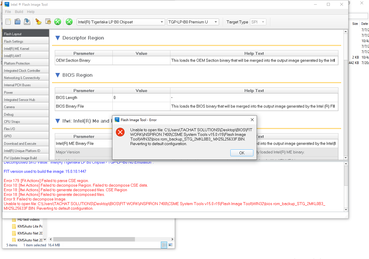

            Re: Dell Inspiron 7400 _ 19765-1 NAKIA-SHURIN7 TGL MP MB Bios Bin

            hello guys , I know this could be opening an "Old Can" but each time i try to open this Bios file with Intel Flash Image tool i get the error: "Unable to open {file name and location} . Reverting to Dfault Configuration. Error 179: Failed to Parse CSE Region etc etc as shown on picture

              this bios only worked for a few boots (1 to 3 boots) after that the machine freeezes on dell logo or sometimes no Display , only comes back when you reflash with bios again. I have another bios file of which the machine works and boots normally all the time but the Fan speed is high (max) and it goes to MAnufacturer Programming Mode all the time and asks for Service Tag no matter how many times you enter it. I have attached the bios file which does that below.
                Write service tag from the bottom label, disable absolute, save and next restart press alt+F to exit manufacturing mode.
                    hello. it still boots to Manufacturer mode and loses the Service tag on next reboot. it keeps booting to Manufacturer mode no matter how many times you enter and save the Service Tag , it loses the service tag all the time.
                      Try again

                                  • Marco_compucell
                                    • Feb 2012
                                    • 75
                                    • South Africa
                                    Hi reboots no display, I have cleaned the ME now it POST but can`t save the Service tag number
                                    Service Tag: 37KMSG3
                                    can someone please help
                                    Thank you
                                    It would be nice if someone can explain how to fix this
