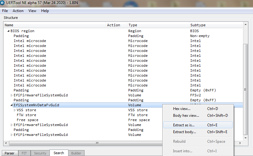

    Hello friends...the first one is the corrupted one....the second is wtih new bios region me region not touched....lap work perfect now but with product infomation not valdid...is there anyway to fix it without using tool.

    send old dump & new both

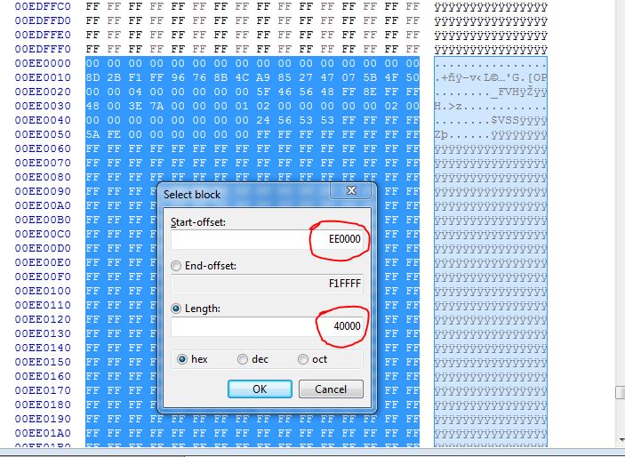

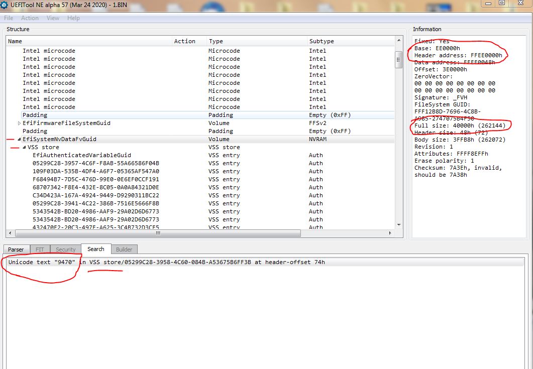

        DMI data is in NVRAM. Transferring NVRAM from old to new should work (Unless NVRAM is corrupted and causing the original issue).

          It works with some.Others have a checksum area that needs copying as well.

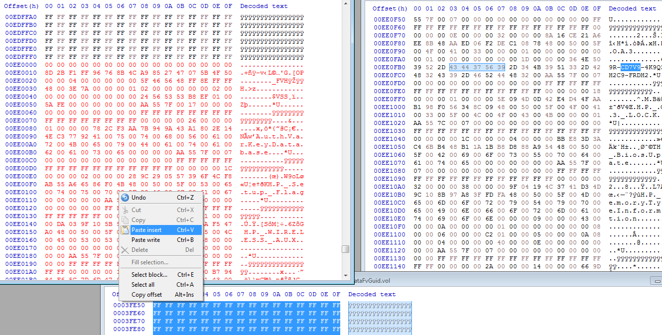

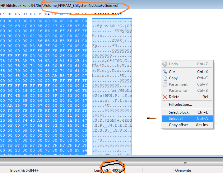

            DMI copying with UEFITool and hex editor

              Re: HP EliteBook Folio 9470m need DMI
              Thank you anshed...thank you smdflea.
              the new dump work but still product information not valid but show only 2 missed informations.
              product serial number
              product sku
