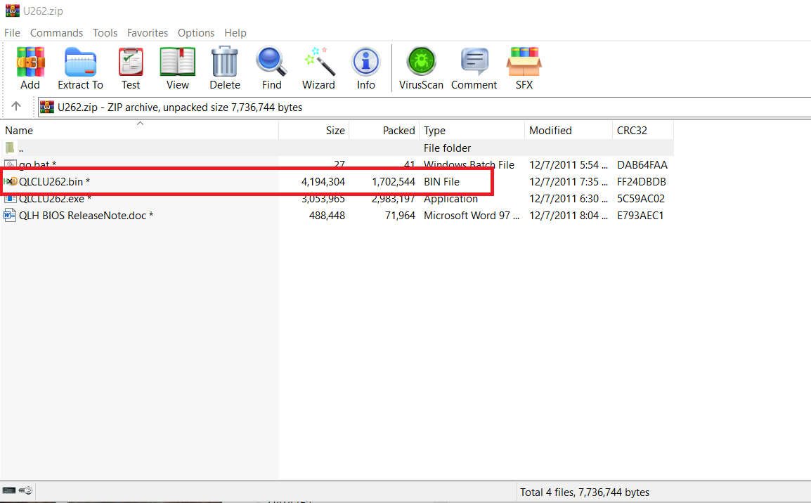

[QUOTE=Mcfalsi;1145779]This is the first time in my life that I see LG's weird support service.
Your model is : A515-K.AC5BT.
Bios can be downloaded from the link: https://www.lg.com/tr/destek/urun/lg-A515-K.AC5BT (it is a U262.zip file).
The bad and frustrating thing is that when unzipping it asks for a password.
What the hell is that?Attached Filesif you find these attachements useful please consider making a small donation to the site

Re: LG DA0QLHMB8F0 Bios dump need
The rar password is lgComment
[QUOTE=hoaca388;1145807]yes i downloaded it and wrote it but unfortunately it started to reset loop
What the hell is that?Comment
