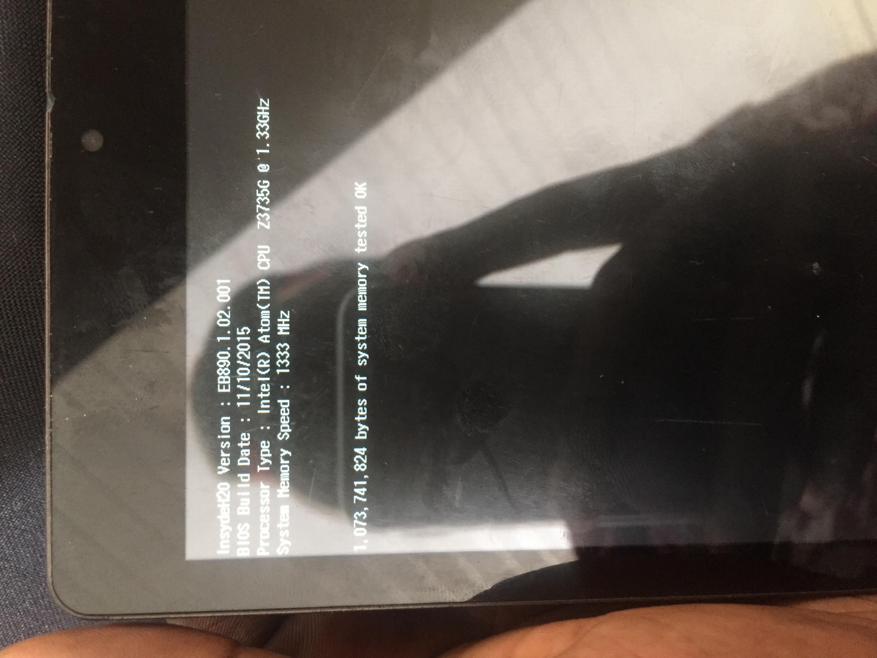

    Good day everyone am asking for a bin file for nextbook tablet nxw8qc16g, the tablet just hangs right after starting and cant do anything else...I have also attached my current bin file
    thanks in advance

        i have tried the bin and it still did the same thing as the other bin, i have attached the img of were the tablet is hanging........
        the tablet was working fine, then i connected an OTG with an external keyboard from there the tablet starting hanging on that screen.... i thought may be the bios has bin corrupted, because even the charging image that comes when you connect the charger has stopped showing, when the tablet is off and i connect the charger it only comes on and hangs, instead of showing the battery charging animating image,and i cant even boot into the bios setup.

          As expected, could not expect support from these unknown brands, could not find bios for this brand.

            yes these brands are not good brands....i checked on google i only found a bin for nxw10qc32g, and not the one for my tablet....thanks for your time..i hope one person has extracted a working bios

                so after searching for this bin file i couldn't find the update or working file online, i decided to modify the corrupt 8 inches bin file with a 10 inches bin and to my blessing i managed hence i made a working file for this tablet, in case some one is in need of it, i have attached it here
