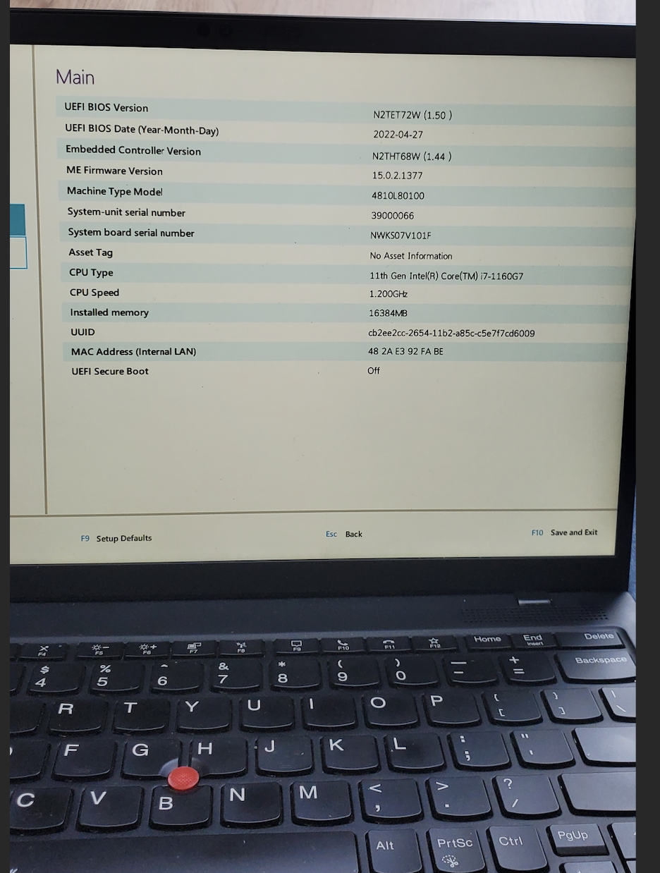

                        I have run into a similar problem with x1 Nano. I did not do anything with the laptop and it weirdly stopped doing anything. Now, when I connect the power cord the power led blinks and then nothing. Pressing the power button does nothing. Sometimes, the power led comes on and then goes off after few seconds. I am not sure what to do.
                        I am a newbie in flashing, and I don't know where to start. Can someone help please.

                            Thank you so much for replying.
                            I don't have my original bios. Actually, the laptop died on its own and I was not trying to update or flash it. How do I get my original bios?
                            I only have this screenshot of the bios screen with me.
                            How do I flash it to unbrick it? DO I need an eeprom programmer to do it and if yes which one would I need?
                            I am sorry for so may basic questions but I dont know where to start.

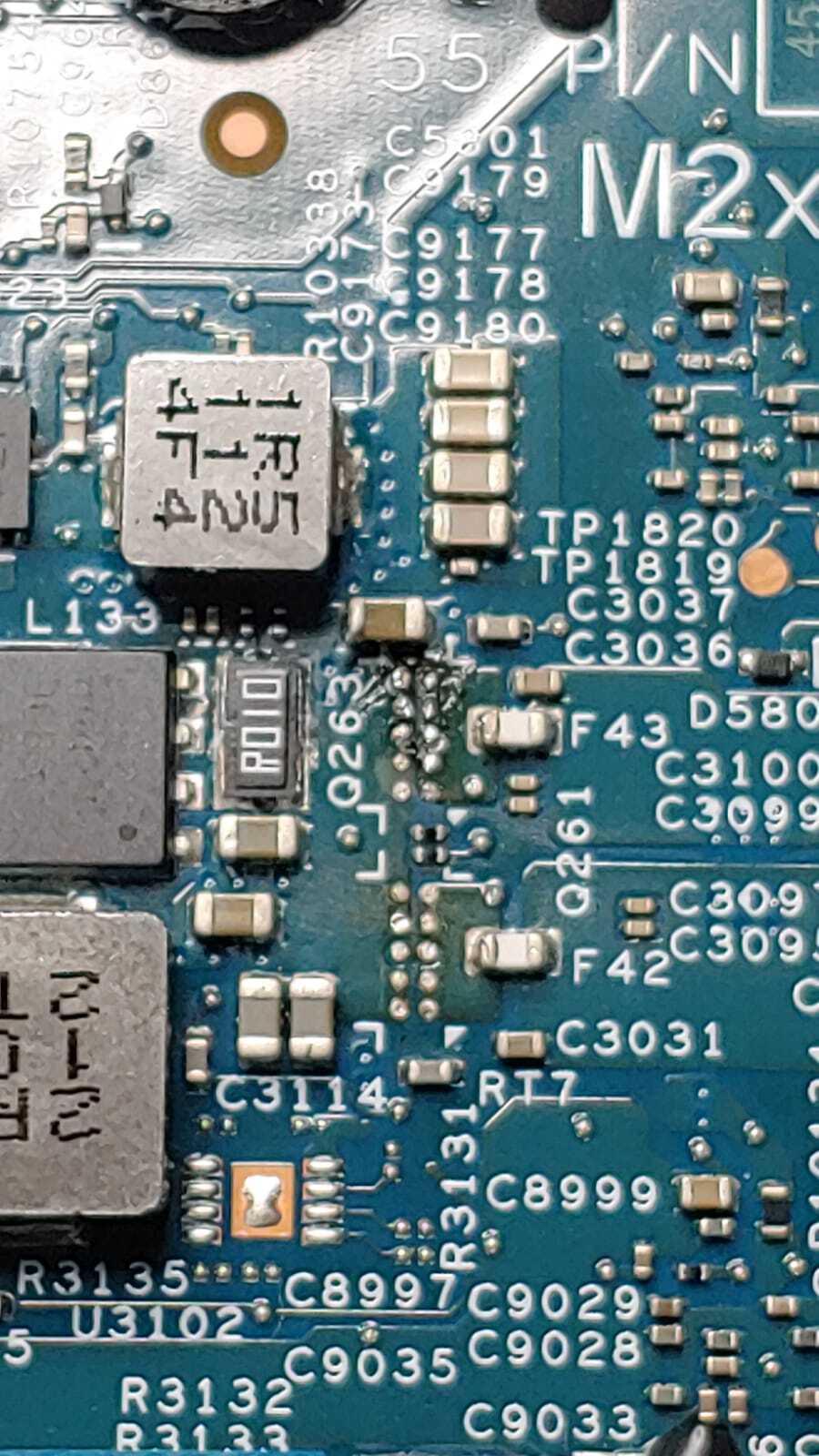

                                    Hello, can someone tell me the number of q263 and q261, I received the laptop without those ICs. Thank you
