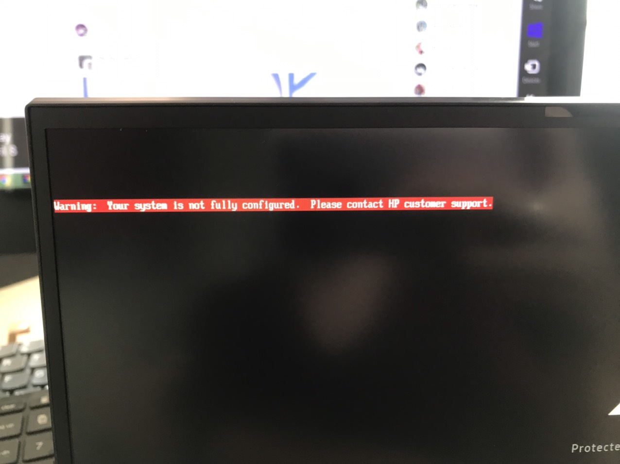

    HP ZBook Studio G8
    CAn some one help me fix this error (see on picture)
    thankyou

    try..
    https://www.badcaps.net/forum/showthread.php?t=70456

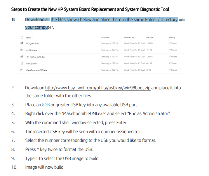

      Re: HP ZBook Studio G8
      you have link to download this tool?
      Download http://www.bay- wolf.com/utility/usbkey/win98boot.zip
      i can't download it
        i can't download it
        https://www.bleepingcomputer.com/dow...e-format-tool/
        https://www.badcaps.net/forum/showthread.php?t=69204
          Done. thank you ad!

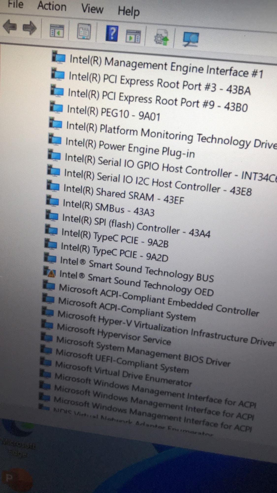

                            • 369
                            this problem i have resolved
                            but now i have other problem with sound drives (see picture i add)
                            i try to clear Me but after clear ssd not detected in bios
                            and laptop can not load to windows
