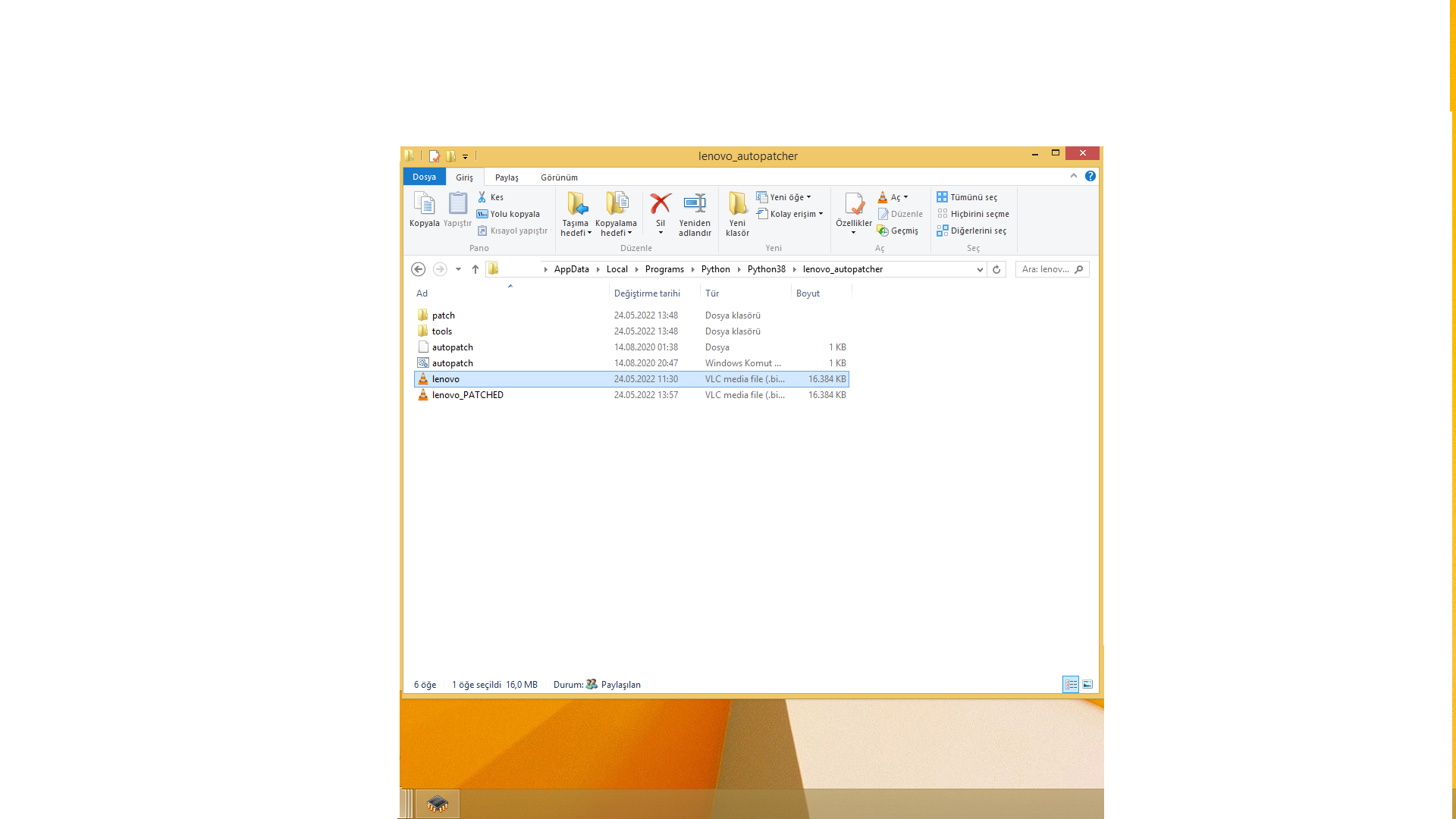

        Lenovo Thinkpad X240 - Way to unlock SVP ? (New method)
        Hello!
        Bought from a liquadation a broken X240.
        Repaired it,and it turns out it's locked in the SVP (Supervisor Password)
        I have searched around the forum, found different solutions but everything was scattered around and old, so don't know which is the best way to attack / unlock it ?
        Should i first post a BIOS Dump ,and we proceed from there?
        Thanks a lot in advance

            Re: Lenovo Thinkpad X240 - Way to unlock SVP ? (New method)
            For some reason the autopatcher doesn't create me the file that i need.
            I have saved the dump .bin from my X240.
            I open a CMD command line with administrative privilege, inside the folder like etc. (C:/BIOSPatcher) inside there are the files i make the cd: C:/BIOSPatcher.
            Then i press the "autopatch test.bin" nothing happens, try "autopatch test.ext" (with the dump renamed , nothing happens).
            What am i doing wrong?
            • AccountSaver
              • Dec 2016
              • 416
              • Poland
              nevermind fixed it, it needed the python to be installed.
              All good ,and fixed my X240.

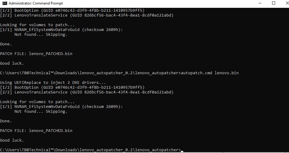

                          lenovo x240 bios dump
                          hi fellow gentlemen. i need help concerning this laptop with security issue. i did patched it using this method
                          HTML Code:
                          https://www.badcaps.net/forum/showthread.php?t=87588
                          im guessing there's an error by looking at this pic. i also uploaded my dump bios
