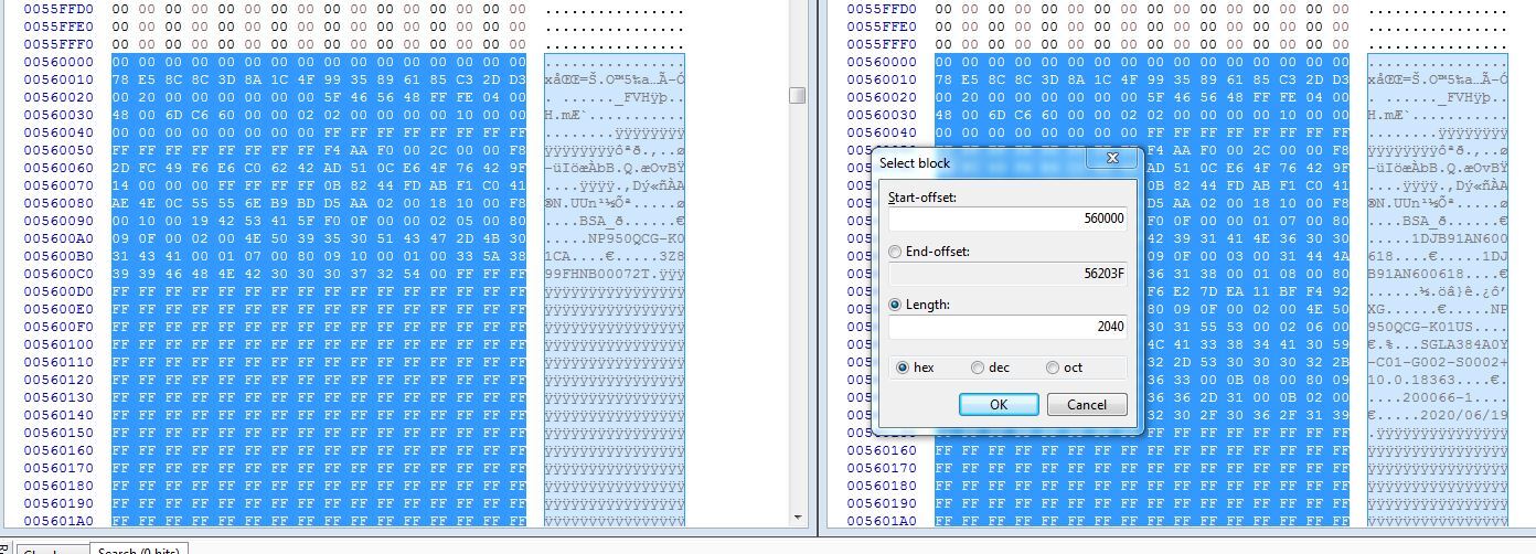

                    Can you clear or rebuild this bios, fan spin fast, keyboard light, But NO DISPLAY.

                      • 21679
                      #30
                      Samsung galaxy book np950qcg
                      NP950QCG – P11AJC
                      S/N: 3Z899FHNB00072T
                      Thank you MASTER
                      Use the bios at post 14 https://www.badcaps.net/forum/troubl...58#post1614758
                      Just copy your DMI from your old bios to the new one using a hex editor, select the same offsets in both, copy from the old and paste into the new then save, job done.
                      Offsets 560000 - 56203F

                          • BOGOSY77
                            • Aug 2018
                            • 50
                            • PITON
                            #33
                            Click image for larger version  Name:	Capture.jpg Views:	25 Size:	225.6 KB ID:	3737574
                            Hello, thanks, but same issue, I followed this step,
                            Keyboard light, power on, fan run fast never stop unless power off manually, : NO DISPLAY
