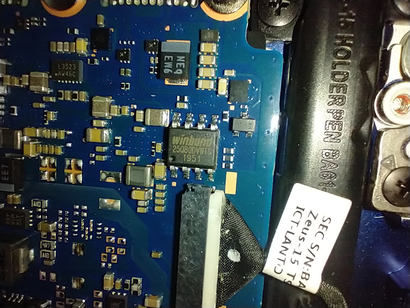

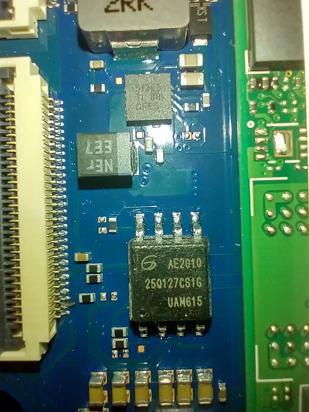

    New here. Can I request the BIOS for the following...Samsung Galaxy Book Flex NP950QCG. And also there was 2 chips on the motherboard that resembles the BIOS chip. I included pics in the post. I can't tell which one is it but my hunch is its the WINBOND but at the same time I hope its not because its hard to get to with the CH341A Programmer I bought. If so then I think I would have to modify the clip to get access to those pins.
    Thanks.

    Re: Samsung Galaxy Book Flex NP950QCG BIOS
    Originally posted by (D_D)
    ... but my hunch is its the WINBOND...
    Your hunch misleads you , the other chip is the right one.
          Sorry, it's Winbond chip.
            Are you kidding me?

            • (D_D)
              • Jan 2022
              • 19
              Yeah, it's the GigaDevice one. The Winbond only has 8 Mbit.
