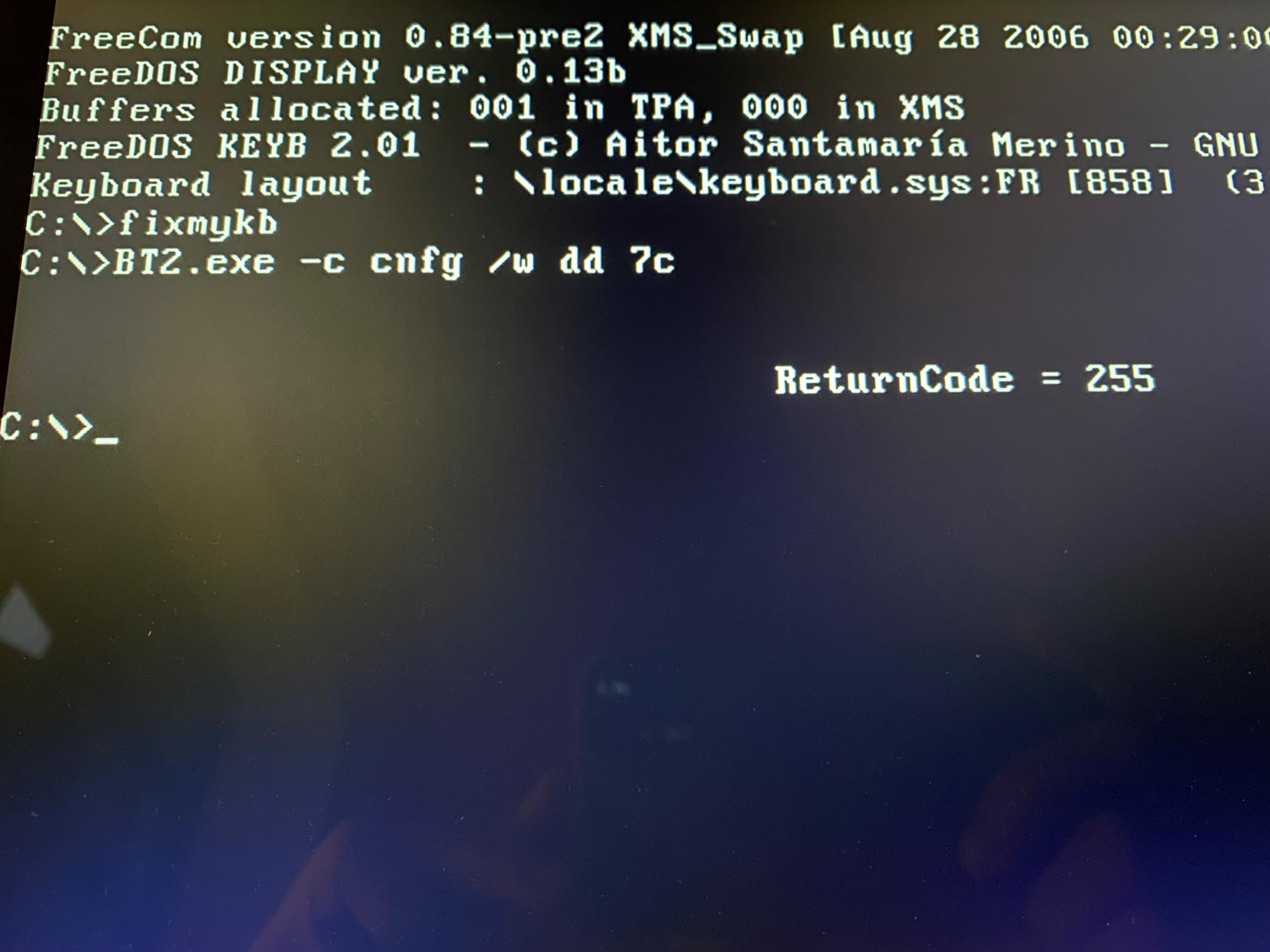

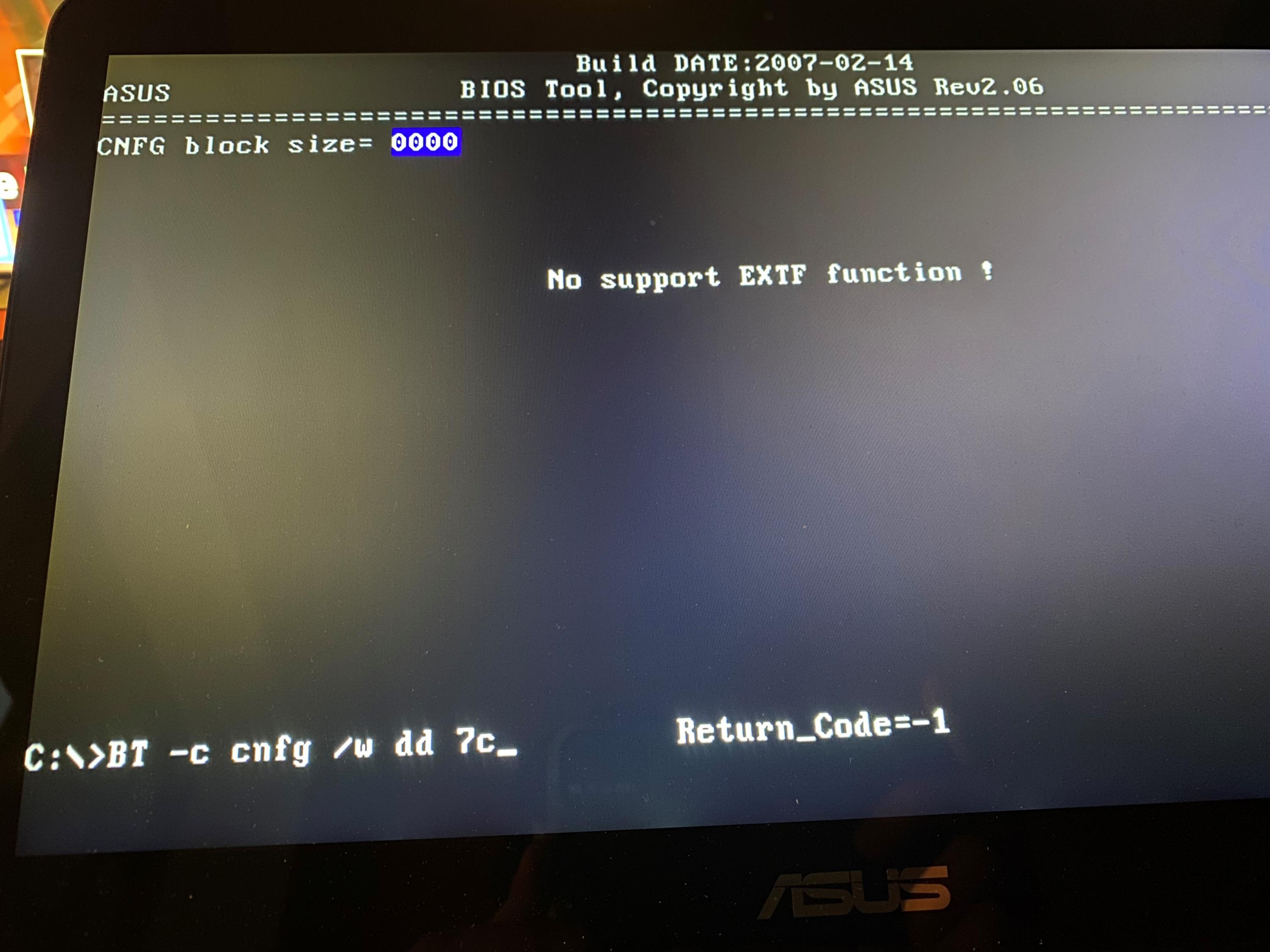

            I tried to install the clear-ME Bios. Nothing change for the keyboard: my Asus just takes longer time to boot. No luck on this.
            Originally posted by SMDFlea
            I tried to use asus block transmit tool bt.exe and bt2.exe. The first one returned an EXTF Error and the second one " returncode: 255". I am not sure about the meaning of this code. (screenshots attached)
            I also tried to manually write "7C" inside the bios using UEFI Tools but i am a bit lost and didn't succeed doing it.
              Sorry,its a newer board so you need WBT.exe ,it should be run from the command line in windows.
                It worked with "WBT.exe"! No need to be sorry, i am the one who should thank you for helping me.

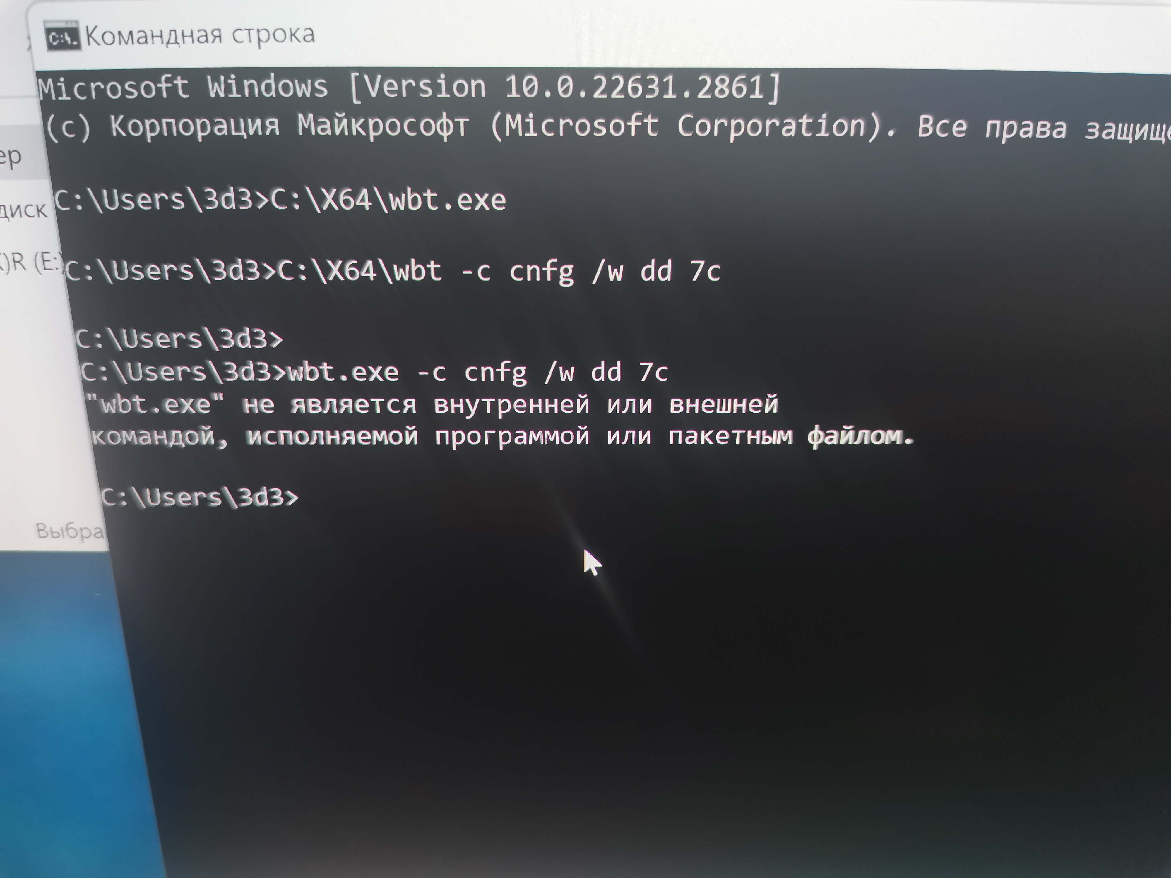

                                    WBT.exe it doesn't work on windows 11?
                                      • 20952
                                      Are you asking if it does work or saying that it doesn`t ?
