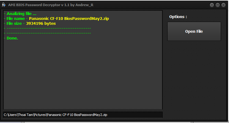

AMITSESetup Decryptor
  • Donaldiniosan
    • Nov 2022
    • United Kingdom
    #61
    Re: AMITSESetup Decryptor
    Hello guys. Could you please try and get the password out of it? We could remove it but no luck with decrypt.
    • thoaitam
      • Jan 2022
      • 11
      • VietNam
      #62
      Re: AMITSESetup Decryptor
      Originally posted by BootLoader1
      Working, working, but I forgot about this case. Now fixed and working well.
      Hi, when i add my dump.bin file. The app only show as picture i attached. Please advise me.
      Thanks you
      • hoaca388
        Badcaps
        • Jan 2022
        • 11625
        #63
        Re: AMITSESetup Decryptor
        Originally posted by Donaldiniosan
        Hello guys. Could you please try and get the password out of it? We could remove it but no luck with decrypt.
        Try this file :
        • hoaca388
          Badcaps
          • Jan 2022
          • 11625
          #64
          Re: AMITSESetup Decryptor
          Originally posted by thoaitam
          Hi, when i add my dump.bin file. The app only show as picture i attached. Please advise me.
          Thanks you
          Means it failed to decrypt that file.
          • TheRealBeltet
            • Jan 2023
            • 2
            • Sweden
            #65
            Re: AMITSESetup Decryptor
            Originally posted by EineWildeStehlampe
            As a lot of older firmware images use the well known, incredibly secure AMI XOR key to encode the supervisor password in the firmware image, I wrote a small Python tool to automate the process of searching through the image and decrypting the key. It is far from perfect but works well enough for me to share.
            The tool uses UEFIExtract to dump the entire image, naively search for a folder ending in "AMITSEDecrypt", iterate through the body.bin to find all possible hashes stored in there, decrypt them with the XOR key, remove every second byte, then convert to ASCII.
            Usage: python3 AMITSEDecrypt <Path/to/image.bin>
            Hope it'll be of use to someone and excuse my horrible Python skills.
            Thank you for your post!
            But unfortunately the script did not post the password. Seems like the script did not finish correctly?
            Only output I get in terminal is:
            Code:
            Extracting original.bin
            Searching original.bin.dump
            • TheRealBeltet
              • Jan 2023
              • 2
              • Sweden
              #66
              Re: AMITSESetup Decryptor
              Originally posted by BootLoader1
              Working, working, but I forgot about this case. Now fixed and working well.
              The tool worked for me. Thanks for your job!
              • northernmonkey
                • Feb 2023
                • 4
                • United Kingdom
                #67
                Re: AMITSESetup Decryptor
                hi, is there any chance someone can help? CF-53 with bios password, i have dumped the BIOS, found the hex data for the password, chnaged all values for 00 but it fails when trying to reflash?? if any of you wizards can decrypt the original i would be ever so grateful!
                • northernmonkey
                  • Feb 2023
                  • 4
                  • United Kingdom
                  #68
                  Re: AMITSESetup Decryptor
                  Originally posted by northernmonkey
                  hi, is there any chance someone can help? CF-53 with bios password, i have dumped the BIOS, found the hex data for the password, chnaged all values for 00 but it fails when trying to reflash?? if any of you wizards can decrypt the original i would be ever so grateful!
                  this time with attachment
                  • peste
                    • Dec 2016
                    • 12601
                    • ROMANIA
                    #69
                    Re: AMITSESetup Decryptor
                    Originally posted by northernmonkey
                    this time with attachment
                    you only posted half of the bios.. what programmer do you have? try again and post again...
                    • northernmonkey
                      • Feb 2023
                      • 4
                      • United Kingdom
                      #70
                      Re: AMITSESetup Decryptor
                      I used the ami bios tool - that should be all of the bios rom?
                      • Vesko356
                        VIP Moderator
                        • Aug 2018
                        • 4386
                        • Bulgaria 🇧🇬
                        #71
                        Re: AMITSESetup Decryptor
                        Originally posted by northernmonkey
                        I used the ami bios tool - that should be all of the bios rom?
                        Don't waste time, Panasonic CF-53 bios pass can not be read with this tool, you will need programmer to read the bios chip and upload the dump at the corresponding topic, someone of us will edit the dump to remove the password. No other options.
                        Become a Badcaps supporter
                        Thanks to all supporters.
                        • northernmonkey
                          • Feb 2023
                          • 4
                          • United Kingdom
                          #72
                          Re: AMITSESetup Decryptor
                          Originally posted by Vesko356
                          Don't waste time, Panasonic CF-53 bios pass can not be read with this tool, you will need programmer to read the bios chip and upload the dump at the corresponding topic, someone of us will edit the dump to remove the password. No other options.
                          Thanks is programmer a ‘chip off' solution? Or can it be done from within windows?
                          • Vesko356
                            VIP Moderator
                            • Aug 2018
                            • 4386
                            • Bulgaria 🇧🇬
                            #73
                            Re: AMITSESetup Decryptor
                            Originally posted by northernmonkey
                            Thanks is programmer a ‘chip off' solution?
                            Yes.
                            Originally posted by northernmonkey
                            Or can it be done from within windows?
                            Definitely no.
                            Become a Badcaps supporter
                            Thanks to all supporters.
                            • geep
                              • Jan 2013
                              • 40
                              #74
                              Re: AMITSESetup Decryptor
                              any chance i can get passwords removed thanks
                              Last edited by geep; 03-21-2023, 09:42 AM. Reason: file didnt upload
                              • hardware1
                                • Sep 2021
                                • 2925
                                • N/A
                                #75
                                Re: AMITSESetup Decryptor
                                Originally posted by geep
                                any chance i can get passwords removed thanks
                                Here's your Unlocked file, try it.
                                all donations are welcome,
                                • geep
                                  • Jan 2013
                                  • 40
                                  #76
                                  Re: AMITSESetup Decryptor
                                  This works great and i was just curious if this also resets accumulated hours. and if you would share the offsets to ff out as i have a few more of theses thanks
                                    • 20648
                                    #77
                                    Re: AMITSESetup Decryptor
                                    Originally posted by geep
                                    This works great and i was just curious if this also resets accumulated hours. and if you would share the offsets to ff out as i have a few more of theses thanks
                                    How many accumulated hours is it showing now and before,if you can remember.If you post another one take note of the accumulated hours first
                                    • geep
                                      • Jan 2013
                                      • 40
                                      #78
                                      Re: AMITSESetup Decryptor
                                      its showing 0 hours but they all look new no wear other than damage from being shipped around. I bought a small lot off online auction site they are locked at bios startup so i don't know the hours
                                      • geep
                                        • Jan 2013
                                        • 40
                                        #79
                                        Re: AMITSESetup Decryptor
                                        hear is the next locked bios dump
                                        • oldsports
                                          • Mar 2023
                                          • 3
                                          #80
                                          Re: AMITSESetup Decryptor
                                          Originally posted by BootLoader1
                                          Working, working, but I forgot about this case. Now fixed and working well.
                                          You are a life-saver! This program worked perfectly - thank you!
                                            09-12-2024, 02:20 PM
                                            HP ProBook 430 G6 + Image Load & Asset Tag Notebook 400 Specification for Upgrade or Repair
                                            This specification for the HP ProBook 430 G6 + Image Load & Asset Tag Notebook can be useful for upgrading or repairing a laptop that is not working. As a community we are working through our specifications to add valuable data like the 430 G6 + Image Load & Asset Tag boardview and 430 G6 + Image Load & Asset Tag schematic. Our users have donated over 1 million documents which are being added to the site. This page will be updated soon with additional information. Alternatively you can request additional help from our users directly on the relevant badcaps forum. Please note that we...
                                            09-06-2024, 10:56 AM
                                            HP ProBook 450 G6 + Image Load & Asset Tag Notebook 400 Specification for Upgrade or Repair
                                            This specification for the HP ProBook 450 G6 + Image Load & Asset Tag Notebook can be useful for upgrading or repairing a laptop that is not working. As a community we are working through our specifications to add valuable data like the 450 G6 + Image Load & Asset Tag boardview and 450 G6 + Image Load & Asset Tag schematic. Our users have donated over 1 million documents which are being added to the site. This page will be updated soon with additional information. Alternatively you can request additional help from our users directly on the relevant badcaps forum. Please note that we...
                                            09-06-2024, 10:56 AM
                                            HP EliteBook 1050 G1 + Image Load, Asset Tag & Testntag Notebook 1000 Specification for Upgrade or Repair
                                            This specification for the HP EliteBook 1050 G1 + Image Load, Asset Tag & Testntag Notebook can be useful for upgrading or repairing a laptop that is not working. As a community we are working through our specifications to add valuable data like the 1050 G1 + Image Load, Asset Tag & Testntag boardview and 1050 G1 + Image Load, Asset Tag & Testntag schematic. Our users have donated over 1 million documents which are being added to the site. This page will be updated soon with additional information. Alternatively you can request additional help from our users directly on the relevant...
                                            09-06-2024, 10:56 AM
                                            HP ProBook 450 G6 + Image Load, Asset Tag & Testntag Notebook 400 Specification for Upgrade or Repair
                                            This specification for the HP ProBook 450 G6 + Image Load, Asset Tag & Testntag Notebook can be useful for upgrading or repairing a laptop that is not working. As a community we are working through our specifications to add valuable data like the 450 G6 + Image Load, Asset Tag & Testntag boardview and 450 G6 + Image Load, Asset Tag & Testntag schematic. Our users have donated over 1 million documents which are being added to the site. This page will be updated soon with additional information. Alternatively you can request additional help from our users directly on the relevant badcaps...
                                            09-06-2024, 10:56 AM
