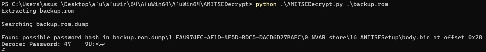

AMITSESetup Decryptor
  • shiyab
    • Sep 2023
    • 1652
    • india
    #141
    Originally posted by Cvsle1321
    please help me unlock bios on this laptop
    Modell:Epson Endeavor NA520E
    BIOS:AMI BIOS/UEFI
    BIOS Serial Number: 952006306
    Motherboard:Epson 13M1
    Secure boot:Enable
    The key for the backdoor password is not displayed.
    cmospwd failed because after running "ioperm.exe -i" I got the error "StartService function call failed".
    I will not be able to access the boot options .
    dual boot(Windows and Linux) is what BIOS password removal is for.
    Booting from a USB flash drive will always boot into Windows, even if you select a different boot option.
    Cmos-Deanimator and others also failed.
    Resetting the cmos battery also failed.
    afuwin3.rom(10.5MB) is from aptio v ami firmware update utility afuwin64
    using htt********************** didn't help.(Result is output.txt(warning binary file) in biosdump.zip)
    AMITSEdecrypt.py didn't give me the password.
    afuwin3.rom.report.txt and afuwin3.rom.dump is Result of AMITSEDecrypt.py.
    I apologize for my English I am not from English-speaking world and I am translating via google translate.
    need backup bios
    • Cvsle1321
      • Oct 2024
      • 3
      • Private Information
      #142
      Originally posted by shiyab
      need backup bios
      backup of bios may be afuwin3.rom.
      This hexadecimal code may be an encrypted BIOS password.(0x072b30~ and 0x03f790)
      C7 07 72 44 43 5D 61 E1 62 B8 36 B2 8B 74 E5 AF(16 Characters)
      Secure boot is enabled. I can't access the boot menu so I can't change it.
      Also, I cannot flash the BIOS from FreeDOS.(FreeDOS cannot be booted with UEFI.)(Use afudos)
      And, In the case of afuwin, it fails due to an ffs checksum error.(In the case of afuwin, it fails due to ffs checksum error. (Include in the case of a dump(backup?) where nothing has been changed)
      • AAAC
        • Jan 2020
        • 459
        • Mexico
        #143
        @Cvsle1321
        Seems like the password cannot be recovered as it's hashed in AMITSESetup variable, only the first SHA256 half is stored there. I've searched for the hash in a database without any match. It also seems like the password maximum length is 8.
        • uritech
          • Jun 2022
          • 3
          • Mexico
          #144
          Originally posted by BootLoader1
          Re: AMITSESetup Decryptor
          Working, working, but I forgot about this case. Now fixed and working well.
          Its working!!! Thank you so much for sharing!!!
          • kosmonaft
            • Mar 2016
            • 7
            • Россия
            #145
            AMITSEDecrypt.py can't to decrypt my file. Can any help me?
              • 22135
              #146
              Originally posted by kosmonaft
              AMITSEDecrypt.py can't to decrypt my file. Can any help me?
              It would help if we knew what the model and serial number is - Read the rules https://www.badcaps.net/forum/troubl...before-posting
              • kosmonaft
                • Mar 2016
                • 7
                • Россия
                #147
                oh, sorry. That is SmartX HMI panel from Schneider SN: GSAB034065
                • shiyab
                  • Sep 2023
                  • 1652
                  • india
                  #148
                  Originally posted by kosmonaft
                  oh, sorry. That is SmartX HMI panel from Schneider SN: GSAB034065
                  hi unlock file
                  • kosmonaft
                    • Mar 2016
                    • 7
                    • Россия
                    #149
                    well it's need to programm in SPI FLASH? Show password itself are not possible?
                    • kosmonaft
                      • Mar 2016
                      • 7
                      • Россия
                      #150
                      Thanks a lot off any way. But I havn't physical acsses at that HMI rithg now. Only enter password are possible. Can you repeat with same HMI (same SN). I attached file here
                      • zeldev1l
                        • Jan 2025
                        • 2
                        • Россия
                        #151
                        PLs Help.
                        Asus X545FJ-BQ034T
                        please help me find out the password in BIOS. I beg you
                        Sorry for my English. I'm from Russia
                        • hoaca388
                          Badcaps
                          • Jan 2022
                          • 12421
                          #152
                          Originally posted by zeldev1l
                          PLs Help.
                          Asus X545FJ-BQ034T
                          please help me find out the password in BIOS. I beg you
                          Sorry for my English. I'm from Russia
                          hERE
                          • kalu
                            • Dec 2011
                            • 48
                            #153
                            Hello can any one please remove the password from this BIOS
                            It's from a Insys WH1-140P - Board model IP3_CN6_MB_V40​
                          • shiyab
                            • Sep 2023
                            • 1652
                            • india
                            #154
                            Originally posted by kalu
                            Hello can any one please remove the password from this BIOS
                            It's from a Insys WH1-140P - Board model IP3_CN6_MB_V40​
                            hi try
                            • kalu
                              • Dec 2011
                              • 48
                              #155
                              Originally posted by shiyab
                              hi try
                              Thank You.
                              It works, you're a genius
                              • LMCMM
                                • Jun 2020
                                • 2
                                • Sweden
                                #156
                                Hi! Thanks for doing this guys, really appreciate it, however I can't get it to work.
                                Running it on backup.rom which I collected with afu gives the following result:
                                Hard to imagine that this is the password since unicode characters can't be entered in bios.
                                It's an ASUS Vivobook X515EA_R565EA with serial number: CAF63618-3028-4670-BCAE-4B07B0637D84
                                Here is the rom attached;
                                Humbly request assistance.
                                • hoaca388
                                  Badcaps
                                  • Jan 2022
                                  • 12421
                                  #157
                                  Originally posted by LMCMM
                                  Hi! Thanks for doing this guys, really appreciate it, however I can't get it to work.
                                  Running it on backup.rom which I collected with afu gives the following result:
                                  Hard to imagine that this is the password since unicode characters can't be entered in bios.
                                  It's an ASUS Vivobook X515EA_R565EA with serial number: CAF63618-3028-4670-BCAE-4B07B0637D84
                                  Here is the rom attached;
                                  Humbly request assistance.
                                  You should backup bios with a hardware device, for example CH341a, to get the full bios file.
                                  https://www.youtube.com/results?sear...41a+how+to+use
                                  • LMCMM
                                    • Jun 2020
                                    • 2
                                    • Sweden
                                    #158
                                    Thanks for the quick response!
                                    Aha ok so I need to get this one?
                                    Amazon Link
                                    So the problem was that I wasn't getting the "while" image of my bios, but with this hardware I can get it?
                                    Ok, as Arnold famously said; I will be back!
                                    Thanks again!
                                    • axeba
                                      • Feb 2025
                                      • 4
                                      • Italia
                                      #159
                                      Trova estratto la password del bios con il programmatore
                                      CH341A Tutto in un computer DEVO S/N
                                      S24G09180155 Board S/N KBMP180809100325
                                      In English !
                                      Find extracted bios password with programmer CH341A All in one computer DEVO S/N S24G09180155 Board S/N KBMP180809100325
                                      Last edited by SMDFlea; 02-13-2025, 04:36 AM. Reason: english
                                      • osman68i
                                        • May 2015
                                        • 354
                                        • The Netherlands
                                        #160
                                        Originally posted by axeba
                                        Trova estratto la password del bios con il programmatore
                                        CH341A Tutto in un computer DEVO S/N
                                        S24G09180155 Board S/N KBMP180809100325
                                        try
                                          09-12-2024, 02:20 PM
                                        • Jaime Morillo
                                          by Jaime Morillo
                                          08-18-2025, 11:38 AM
                                          HP ProBook 450 G6 + Image Load & Asset Tag Notebook 400 Specification for Upgrade or Repair
                                          This specification for the HP ProBook 450 G6 + Image Load & Asset Tag Notebook can be useful for upgrading or repairing a laptop that is not working. As a community we are working through our specifications to add valuable data like the 450 G6 + Image Load & Asset Tag boardview and 450 G6 + Image Load & Asset Tag schematic. Our users have donated over 1 million documents which are being added to the site. This page will be updated soon with additional information. Alternatively you can request additional help from our users directly on the relevant badcaps forum. Please note that we...
                                          09-06-2024, 10:56 AM
                                          HP EliteBook 1050 G1 + Image Load, Asset Tag & Testntag Notebook 1000 Specification for Upgrade or Repair
                                          This specification for the HP EliteBook 1050 G1 + Image Load, Asset Tag & Testntag Notebook can be useful for upgrading or repairing a laptop that is not working. As a community we are working through our specifications to add valuable data like the 1050 G1 + Image Load, Asset Tag & Testntag boardview and 1050 G1 + Image Load, Asset Tag & Testntag schematic. Our users have donated over 1 million documents which are being added to the site. This page will be updated soon with additional information. Alternatively you can request additional help from our users directly on the relevant...
                                          09-06-2024, 10:56 AM
                                          HP ProBook 450 G6 + Image Load & Asset Tag Notebook 400 Specification for Upgrade or Repair
                                          This specification for the HP ProBook 450 G6 + Image Load & Asset Tag Notebook can be useful for upgrading or repairing a laptop that is not working. As a community we are working through our specifications to add valuable data like the 450 G6 + Image Load & Asset Tag boardview and 450 G6 + Image Load & Asset Tag schematic. Our users have donated over 1 million documents which are being added to the site. This page will be updated soon with additional information. Alternatively you can request additional help from our users directly on the relevant badcaps forum. Please note that we...
                                          09-06-2024, 10:56 AM
