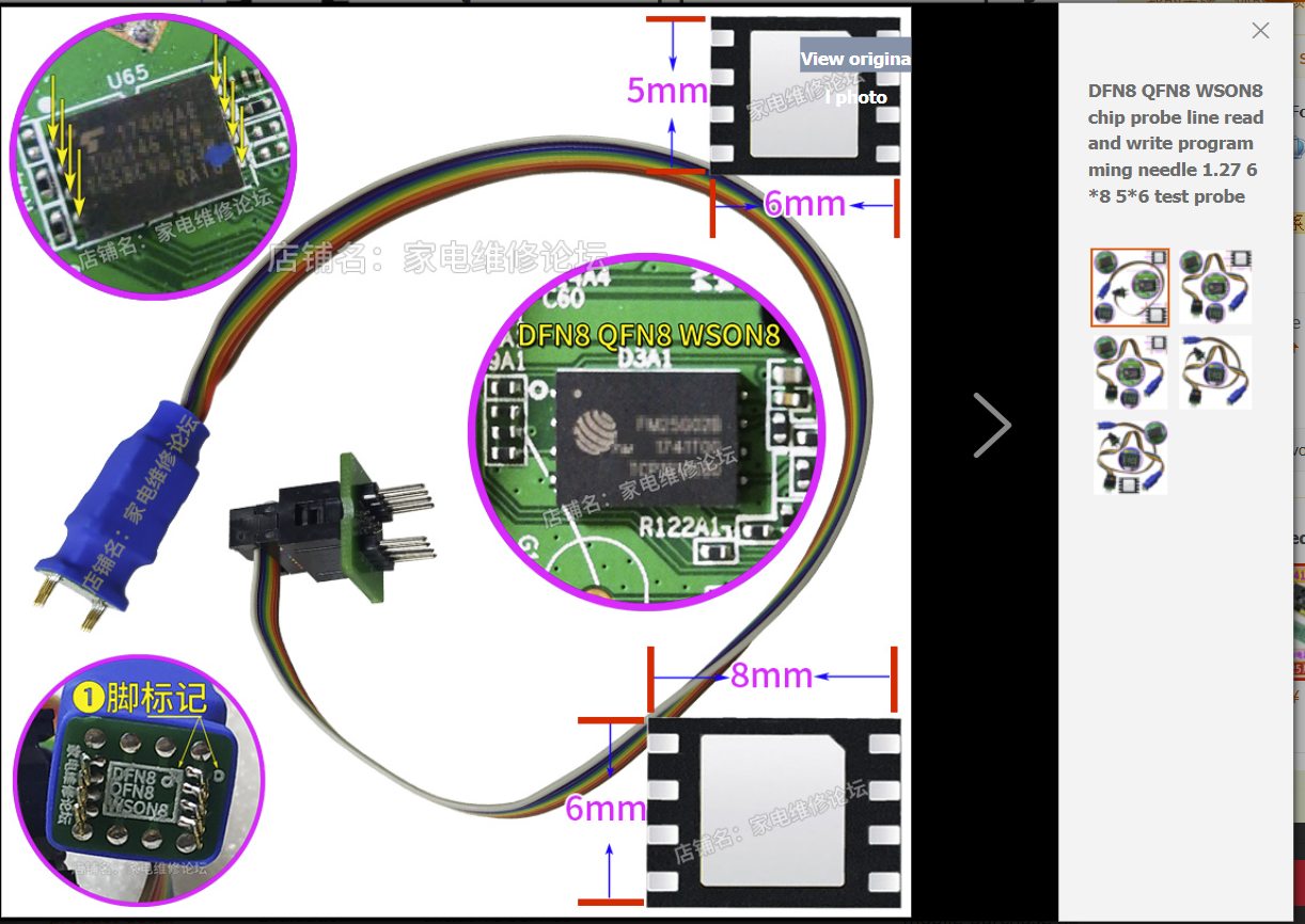

                        #351
                        Re: need bios dump dell latitude 5420 (cpu 11th)
                        Is it possible to program my WSON type bios chip withou a socket?
                        Directly on the board?
                        Is there an adapter to not need to unsolder the chip from the board?
                        • hoaca388
                          Badcaps
                          • Jan 2022
                          • 11615
                          #352
                          Possible
