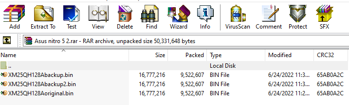

      Your backup isn`t good, and there`s extra code at the end because you backed it up as OTP ,one time programmable. Make another backup and don`t choose OTP

        Can it be edit?? Ihavr read more than 10 times not able to compare correctly??

          Are you using a clip or have you desoldered the chip

            Re: hp elitebook X360 1030 G7 Locked BIOS Dump
            Clip

              Desolder it if you have a hot air station and a suitable adapter board. Your backup is corrupt, the clips can be very unreliable

                A fast way to compare two or more bins is to rar them and look at the CRC32 value.

                  If there`s another bios chip somewhere, post that backup as well

                    Havr desoldered it
                        Try this one now

                          Thanks boss
                          But AFETR inserting information on it again still showing manufacturing program mode

                            Fixed
                            thanks so much
