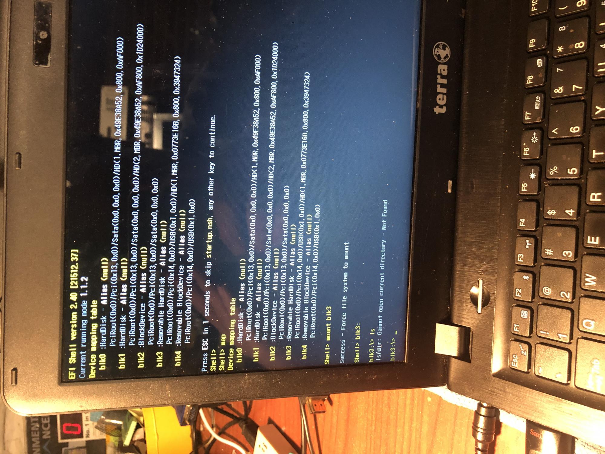

    Hi Guys
    I've got a weird brand laptop what doesn't seems to read
    from usb or hdd and then goes into the EFI shell
    The drive is detected but cannot see the files.
    And can't set it to legacy mode. I can get into
    the bios setup, but most of the items is not
    possible to change.
    Here's a photo and I will add the bios right now
    Thanks for the help

    Bios main and ec working, but not 100%;

      Do you have the motherboard part number.Its probably a clevo

        Mb 1510a019214040800517
        mn2840
        000b2f151a31
        b21_vf
        eton et856
        e213441
        z005 b21l g5044766dxfa

          try this

            Thanks SMDFlea,
            I tried with the new file but the screen stays black. :-(
            Processor warms up normally.
            I took of the EPROMs again and the files are still the same as what I programmed. Tried again but no luck
