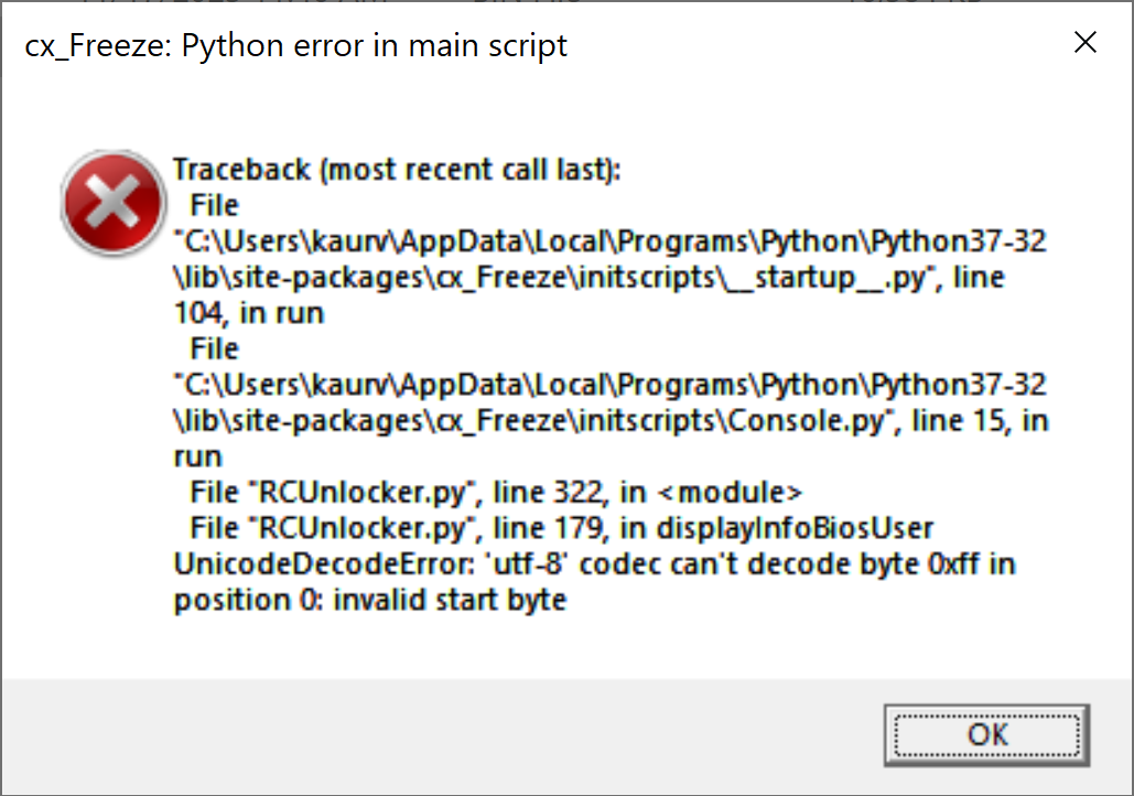

                                Unlocked 8470p, all good! Great tool!
                                Replaced CMOS battery while at at - why does HP wrap it into plastic ... Slightly shorted a good 2032 Duracell while attaching wires.
                                The program gives an error at the end, but that does not seem to impact anything, and the unlocked bios is produced OK.

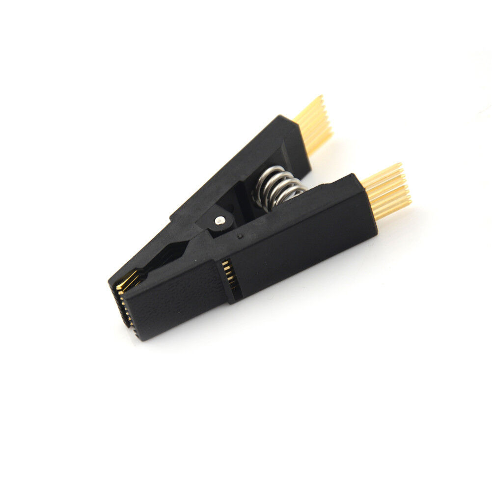

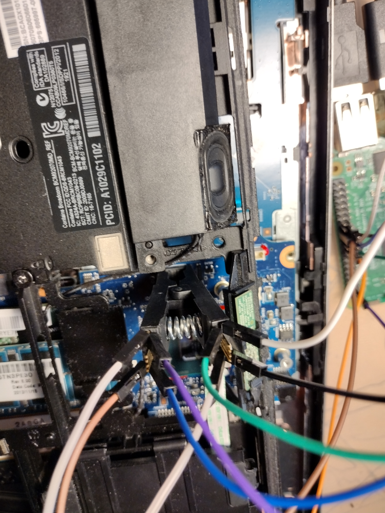

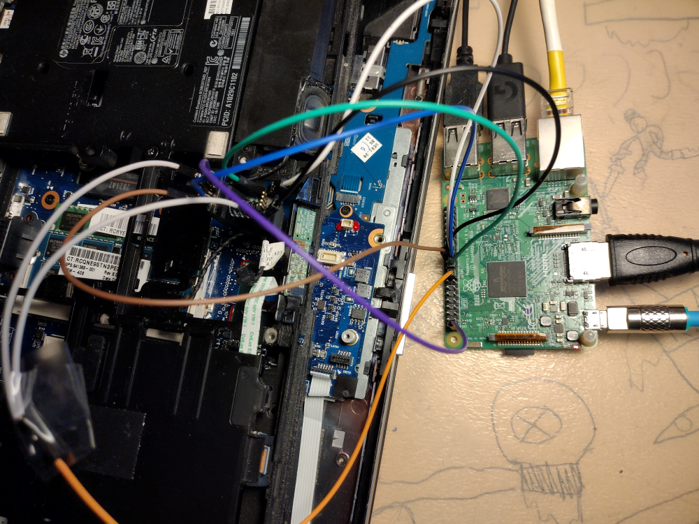

                                    Btw, I highly recommend the very simple wire-less SOIC clips that go for $2 on eBay from China.
                                    One can simply attached wires to the clip, and the other ends to Raspberry Pi. I had 20cm wires. To create some room for wires to be attached, I bent clip's pins into the middle and out in a staggered way.
                                    I saw some pictures out there where the clip wires go to a break out board first, and then have to get connected to Raspberry. That's an extra step, and tons of possible confusion.
                                    See pictures.
