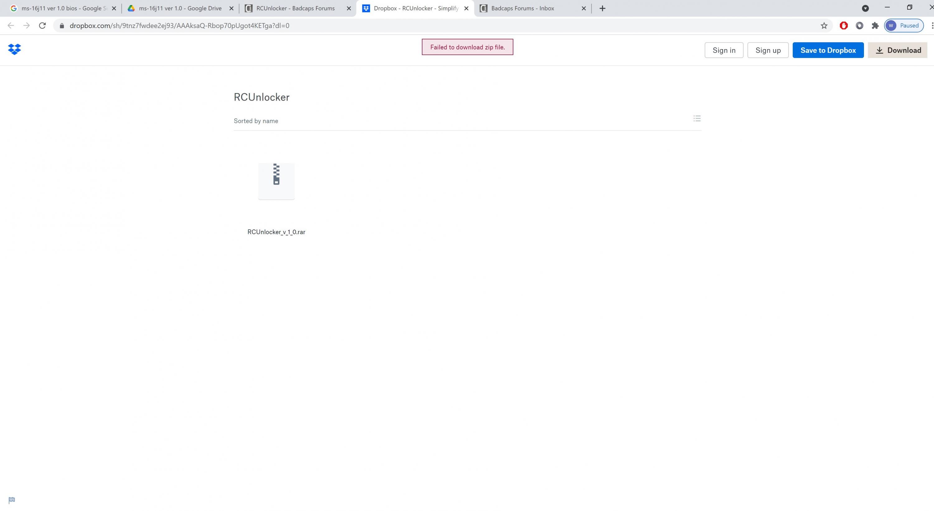

            • azanwaqas771
              • Feb 2019
              • 48
              • Pakistan
              #46
              Re: RCUnlocker
              not download bro can you share on here RCunlocker tool
              show this error
              • donskogvito
                • Sep 2021
                • 15
                • Norway
                #47
                Re: RCUnlocker
                I can confirm that the zip file download is working as of today.
