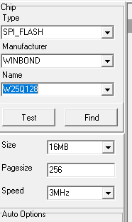

RCUnlocker
  • aspenthedon
    • Apr 2023
    • 7
    • United states
    #761
    Re: RCUnlocker
    Originally posted by peste
    yes, you wanted to delete his password, look at the bios here..
    Thanks for the quick reply. So just so I'm clear your saying to write this file to bios and it should be good?
    I thought I read that I should read multiple times and make sure that the are all same size ect.
    Is it normal to read the chip and verify bin then when I go to read it again its empty? Sorry if these questions are obvious, I'm just trying to fully understand. Thanks again
    Also im getting this error when opening the bin i pulled with rcunlocker.
    Last edited by aspenthedon; 04-27-2023, 09:12 AM.
    • peste
      • Dec 2016
      • 12691
      • ROMANIA
      #762
      Re: RCUnlocker
      Originally posted by aspenthedon
      Thanks for the quick reply. So just so I'm clear your saying to write this file to bios and it should be good?
      I thought I read that I should read multiple times and make sure that the are all same size ect.
      Is it normal to read the chip and verify bin then when I go to read it again its empty? Sorry if these questions are obvious, I'm just trying to fully understand. Thanks again
      Also im getting this error when opening the bin i pulled with rcunlocker.
      it should not be empty when you read it...use the HxD program..
      with this model it is ok... don't take the window into account..
      • aspenthedon
        • Apr 2023
        • 7
        • United states
        #763
        Re: RCUnlocker
        Originally posted by peste
        it should not be empty when you read it...use the HxD program..
        with this model it is ok... don't take the window into account..
        Im a bit new to all of this can you maybe explain a bit more?
        hxd hex editor im assuming your talking about? Im sorry about the confusion
        • aspenthedon
          • Apr 2023
          • 7
          • United states
          #764
          Re: RCUnlocker
          Originally posted by peste
          it should not be empty when you read it...use the HxD program..
          with this model it is ok... don't take the window into account..
          its concerning that I read it fine now I get chip is empty error or it reads and is filled with nothing. I hope I didn't do something wrong.
          that file you uploaded to me earlier what is that for?
          • aspenthedon
            • Apr 2023
            • 7
            • United states
            #765
            Re: RCUnlocker
            Originally posted by peste
            it should not be empty when you read it...use the HxD program..
            with this model it is ok... don't take the window into account..
            also when I'm reading the chip these are the settings, maybe something isn't set right? my original read file i believe has a size of 128B set in the program.
            • Vesko356
              VIP Moderator
              • Aug 2018
              • 4386
              • Bulgaria 🇧🇬
              #766
              Re: RCUnlocker
              Originally posted by aspenthedon
              Im a bit new to all of this can you maybe explain a bit more?
              hxd hex editor im assuming your talking about? Im sorry about the confusion
              Yes that's exactly what he meant.
              This discussion and your questions are starting to get off-topic here.
              Read some guides here before asking more questions please:
              BIOS guides, methods, resources and tools
              Common SPI bios chip programming Questions and Answers
              P.S. There's no need to post multiple times one after another, use the EDIT button if you want to add something.
              Become a Badcaps supporter
              Thanks to all supporters.​
              • aspenthedon
                • Apr 2023
                • 7
                • United states
                #767
                Re: RCUnlocker
                Originally posted by Vesko356
                Yes that's exactly what he meant.
                This discussion and your questions are starting to get off-topic here.
                Read some guides here before asking more questions please:
                BIOS guides, methods, resources and tools
                Common SPI bios chip programming Questions and Answers
                P.S. There's no need to post multiple times one after another, use the EDIT button if you want to add something.
                I apologize. I'm just stuck and don't know what my options are. Can you verify that the dump I uploaded is or is not complete? thanks
                • Vesko356
                  VIP Moderator
                  • Aug 2018
                  • 4386
                  • Bulgaria 🇧🇬
                  #768
                  Re: RCUnlocker
                  Originally posted by aspenthedon
                  I apologize. I'm just stuck and don't know what my options are. Can you verify that the dump I uploaded is or is not complete? thanks
                  There is no need to do it, since Peste has worked on the file I am absolutely sure that everything is fine. He is one of the people here who have certainly proven his professionalism many times. To say the least.
                  Become a Badcaps supporter
                  Thanks to all supporters.​
                  • aspenthedon
                    • Apr 2023
                    • 7
                    • United states
                    #769
                    Re: RCUnlocker
                    Originally posted by Vesko356
                    There is no need to do it, since Peste has worked on the file I am absolutely sure that everything is fine. He is one of the people here who have certainly proven his professionalism many times. To say the least.
                    Oh awesome. I asked what he meant by look at the bios. I wanted to make sure I was understanding correctly. I was just confused is all! Thanks you guys for your help and I will report back!
                    • mitchw
                      • Dec 2016
                      • 136
                      • Slovenia
                      #770
                      Re: RCUnlocker
                      Hey, love this thread and all the effort that went into it.
                      I received a ZBook 17 G5 from my friend that is locked by a fingerprint and password. He managed to hurt his finger so badly that the fingerprint reader failed to detect his finger anymore. And after 2 years he also forgot the password.
                      I had a quick peek inside and I see two flash chips, one is marked EC and it is a standard SOIC-8 package that I have a clip for, but the other one is marked BIOS which is that low profile WSON-8 package. If possible, I would prefer not to take the board out and desolder that one...
                      Do I need to get the dumps of both of chips to get it unlocked?
                      • peste
                        • Dec 2016
                        • 12691
                        • ROMANIA
                        #771
                        Re: RCUnlocker
                        Originally posted by mitchw
                        Hey, love this thread and all the effort that went into it.
                        I received a ZBook 17 G5 from my friend that is locked by a fingerprint and password. He managed to hurt his finger so badly that the fingerprint reader failed to detect his finger anymore. And after 2 years he also forgot the password.
                        I had a quick peek inside and I see two flash chips, one is marked EC and it is a standard SOIC-8 package that I have a clip for, but the other one is marked BIOS which is that low profile WSON-8 package. If possible, I would prefer not to take the board out and desolder that one...
                        Do I need to get the dumps of both of chips to get it unlocked?
                        try RCUnlocker on the 16MB chip.. I wouldn't advise you to use the clip, most of the time it gives errors.. if you don't have a chip adapter stick wires between the chip and the programmer... don't forget to make a backup copy of the chip before writing..
                        • mitchw
                          • Dec 2016
                          • 136
                          • Slovenia
                          #772
                          Re: RCUnlocker
                          I tried it using on a 16MB EC chip, and it said successfully unlocked.
                          But when I wrote the image back, it is now again asking for a password... or fingerprint
                          • Vesko356
                            VIP Moderator
                            • Aug 2018
                            • 4386
                            • Bulgaria 🇧🇬
                            #773
                            Re: RCUnlocker
                            Originally posted by mitchw
                            I tried it using on a 16MB EC chip, and it said successfully unlocked.
                            But when I wrote the image back, it is now again asking for a password... or fingerprint
                            And you are unable to enter the bios with F10 and reset security settings to default?
                            Become a Badcaps supporter
                            Thanks to all supporters.​
                            • drefo
                              • Mar 2021
                              • 26
                              • France
                              #774
                              Re: RCUnlocker
                              Hello, can you help me to remove the password? Thanks
                              • Vesko356
                                VIP Moderator
                                • Aug 2018
                                • 4386
                                • Bulgaria 🇧🇬
                                #775
                                Re: RCUnlocker
                                Originally posted by drefo
                                Hello, can you help me to remove the password? Thanks
                                Use the tool with your 16Mb dump. Leave the 32Mb one as is.
                                Become a Badcaps supporter
                                Thanks to all supporters.​
                                • drefo
                                  • Mar 2021
                                  • 26
                                  • France
                                  #776
                                  Re: RCUnlocker
                                  I made the modification but the screen remains black and the fan turns quickly. thanks
                                  • Vesko356
                                    VIP Moderator
                                    • Aug 2018
                                    • 4386
                                    • Bulgaria 🇧🇬
                                    #777
                                    Re: RCUnlocker
                                    Originally posted by drefo
                                    I made the modification but the screen remains black and the fan turns quickly. thanks
                                    Just wait a little longer, first boot will take a while. If the problem persist check the soldering of the both chips to the motherboard, and surrounding area for blown components. Check the content of the 16Mb chip again, use verification.
                                    Become a Badcaps supporter
                                    Thanks to all supporters.​
                                    • drefo
                                      • Mar 2021
                                      • 26
                                      • France
                                      #778
                                      Re: RCUnlocker
                                      thanks for the info, just before doing the 16mb i had looked at the 32mb passing it to unlocker, can it do something wrong? Thanks
                                      • Vesko356
                                        VIP Moderator
                                        • Aug 2018
                                        • 4386
                                        • Bulgaria 🇧🇬
                                        #779
                                        Re: RCUnlocker
                                        Originally posted by drefo
                                        thanks for the info, just before doing the 16mb i had looked at the 32mb passing it to unlocker, can it do something wrong? Thanks
                                        What do you mean by "passing in to unlocker", RCU doesn't work with the 32Mb dump anyways so I don't understand what do you mean, besides I've said not to touch the 32Mb chip. Did you play (read/write/erase..) with it too at some point?
                                        Become a Badcaps supporter
                                        Thanks to all supporters.​
                                        • drefo
                                          • Mar 2021
                                          • 26
                                          • France
                                          #780
                                          Re: RCUnlocker
                                          I modified the file 32 mb with Hpunlocker and then I tried to start, here is my mistake I put it back original to then make your modification
                                            HP Clean VSS2 dumps,fix Endpoint Security error
                                            by SMDFlea
                                            Just a thread to post clean VSS2 files/dumps in.A clean VSS2 file can, in some cases, fix
                                            the infamous **"Endpoint Security" error message.
                                            Be aware that if you use a clean VSS2 you may need to fill in missing DMI info using HP BCU !
                                            I`ve included some clean files/dumps,offsets and a few scripts to autopatch a few models.
                                            The offsets and file sizes are part of the naming convention i`ve used for the extracted
                                            files.
                                            hoaca388 has made an excellent guide how to extract the VSS2 file and edit/clean it up by
                                            filling everything after...
                                            08-08-2024, 03:14 PM
                                            HP ProBook HP ProBook 450 15.6 inch G10 Notebook PC Notebook 400 Specification for Upgrade or Repair
                                            This specification for the HP ProBook HP ProBook 450 15.6 inch G10 Notebook PC Notebook can be useful for upgrading or repairing a laptop that is not working. As a community we are working through our specifications to add valuable data like the HP ProBook 450 15.6 inch G10 Notebook PC boardview and HP ProBook 450 15.6 inch G10 Notebook PC schematic. Our users have donated over 1 million documents which are being added to the site. This page will be updated soon with additional information. Alternatively you can request additional help from our users directly on the relevant badcaps forum. Please...
                                            09-07-2024, 07:12 AM
                                            HP ProBook HP ProBook 450 15.6 inch G10 Notebook PC Notebook 400 Specification for Upgrade or Repair
                                            This specification for the HP ProBook HP ProBook 450 15.6 inch G10 Notebook PC Notebook can be useful for upgrading or repairing a laptop that is not working. As a community we are working through our specifications to add valuable data like the HP ProBook 450 15.6 inch G10 Notebook PC boardview and HP ProBook 450 15.6 inch G10 Notebook PC schematic. Our users have donated over 1 million documents which are being added to the site. This page will be updated soon with additional information. Alternatively you can request additional help from our users directly on the relevant badcaps forum. Please...
                                            09-07-2024, 06:40 AM
                                            HP ProBook ProBook Fortis 14 inch G9 Notebook PC Notebook Specification for Upgrade or Repair
                                            This specification for the HP ProBook ProBook Fortis 14 inch G9 Notebook PC Notebook can be useful for upgrading or repairing a laptop that is not working. As a community we are working through our specifications to add valuable data like the ProBook Fortis 14 inch G9 Notebook PC boardview and ProBook Fortis 14 inch G9 Notebook PC schematic. Our users have donated over 1 million documents which are being added to the site. This page will be updated soon with additional information. Alternatively you can request additional help from our users directly on the relevant badcaps forum. Please note...
                                            09-07-2024, 05:50 AM
                                            HP ProBook ProBook Fortis 14 inch G9 Notebook PC Notebook Specification for Upgrade or Repair
                                            This specification for the HP ProBook ProBook Fortis 14 inch G9 Notebook PC Notebook can be useful for upgrading or repairing a laptop that is not working. As a community we are working through our specifications to add valuable data like the ProBook Fortis 14 inch G9 Notebook PC boardview and ProBook Fortis 14 inch G9 Notebook PC schematic. Our users have donated over 1 million documents which are being added to the site. This page will be updated soon with additional information. Alternatively you can request additional help from our users directly on the relevant badcaps forum. Please note...
                                            09-07-2024, 05:50 AM
