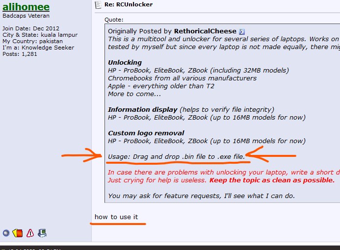

                  • alihomee
                    • Dec 2012
                    • 1596
                    • malaysia
                    #649
                    Re: RCUnlocker
                    Originally posted by RethoricalCheese
                    This is a multitool and unlocker for several series of laptops. Works on Windows. No python etc installing needed, all included in package. Everything is tested by myself but since every laptop is not made equally, there might be edge cases. Always VERIFY your file after reading!!!
                    Unlocking
                    HP - ProBook, EliteBook, ZBook (including 32MB models)
                    Chromebooks from all various manufacturers
                    Apple - everything older than T2
                    More to come...
                    Information display (helps to verify file integrity)
                    HP - ProBook, EliteBook, ZBook (up to 16MB models for now)
                    Custom logo removal
                    Usage: Drag and drop .bin file to .exe file.
                    In case there are problems with unlocking your laptop, write a short description of the issue, upload original file and if possible, _unlocked.bin file aswell. Just crying for help is useless. Keep the topic as clean as possible.
                    You may ask for feature requests, I'll see what I can do.
                    how to use it

                                    • 22163
                                    #657
                                    Re: RCUnlocker
                                    Originally posted by alihomee
                                    how to use it
                                    by reading the instructions at post #1
