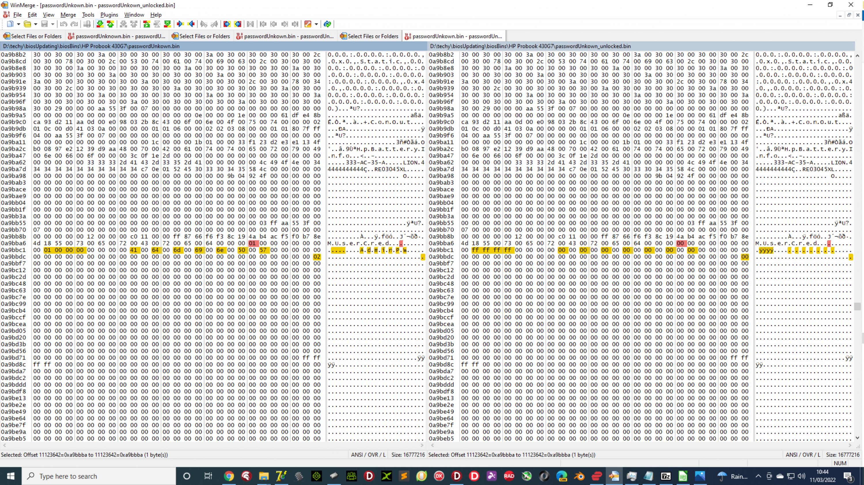

                                    new to unlocking and forum. I have tried a HP Probbook 430G7. I read the bios chip ( and verified ) using CH341A. This created a bin file. I dragged it onto the RCUnlocker.exe and this produced a new bin file. I used WinMerge to check any differences and it had. ( see attached image).
                                    Am I right in presuming the original password is AdminPW ??
                                    Uploaded to new bin file. The bios did not show a 'reset the security settings' we went to setup and there was still a password so we could not get in.
                                    Any help appreciated.
