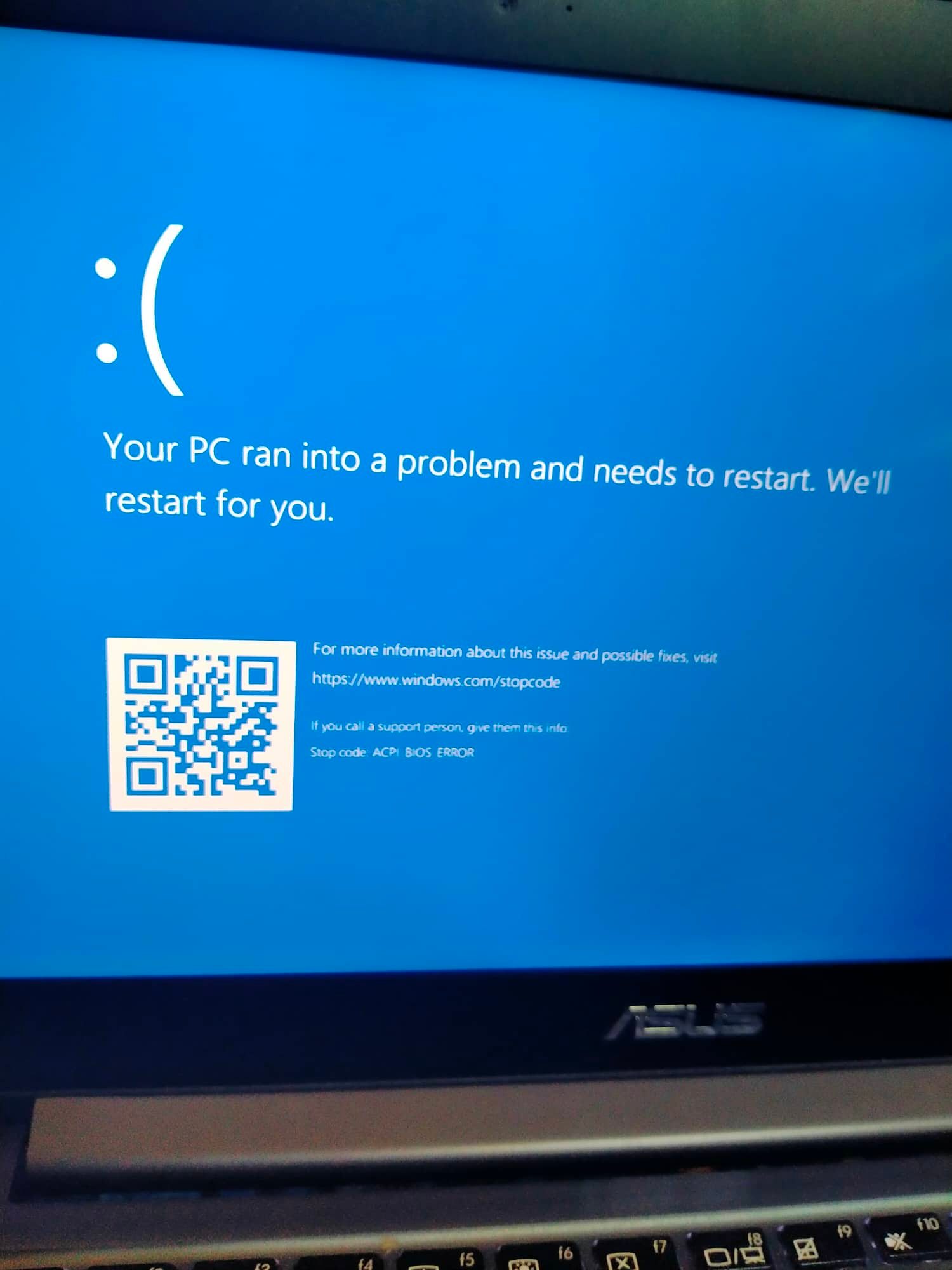

06-25-2022, 08:19 AM
Asus Taichi21 notebook pc
Device: laptop
Brand: Asus
Model: Asus TAICHI21 NOTEBOOK PC
Request: Clean/Update/Repair
when booting having BSOD with ACPI BIOS ERROR

06-25-2022, 12:36 PM
Re: Asus TAICHI21 bios dump
Try this and report back, new BIOS region from web and your own DMI region plus clean ME region.

06-25-2022, 04:30 PM
thank you. tested and works like a charm.
