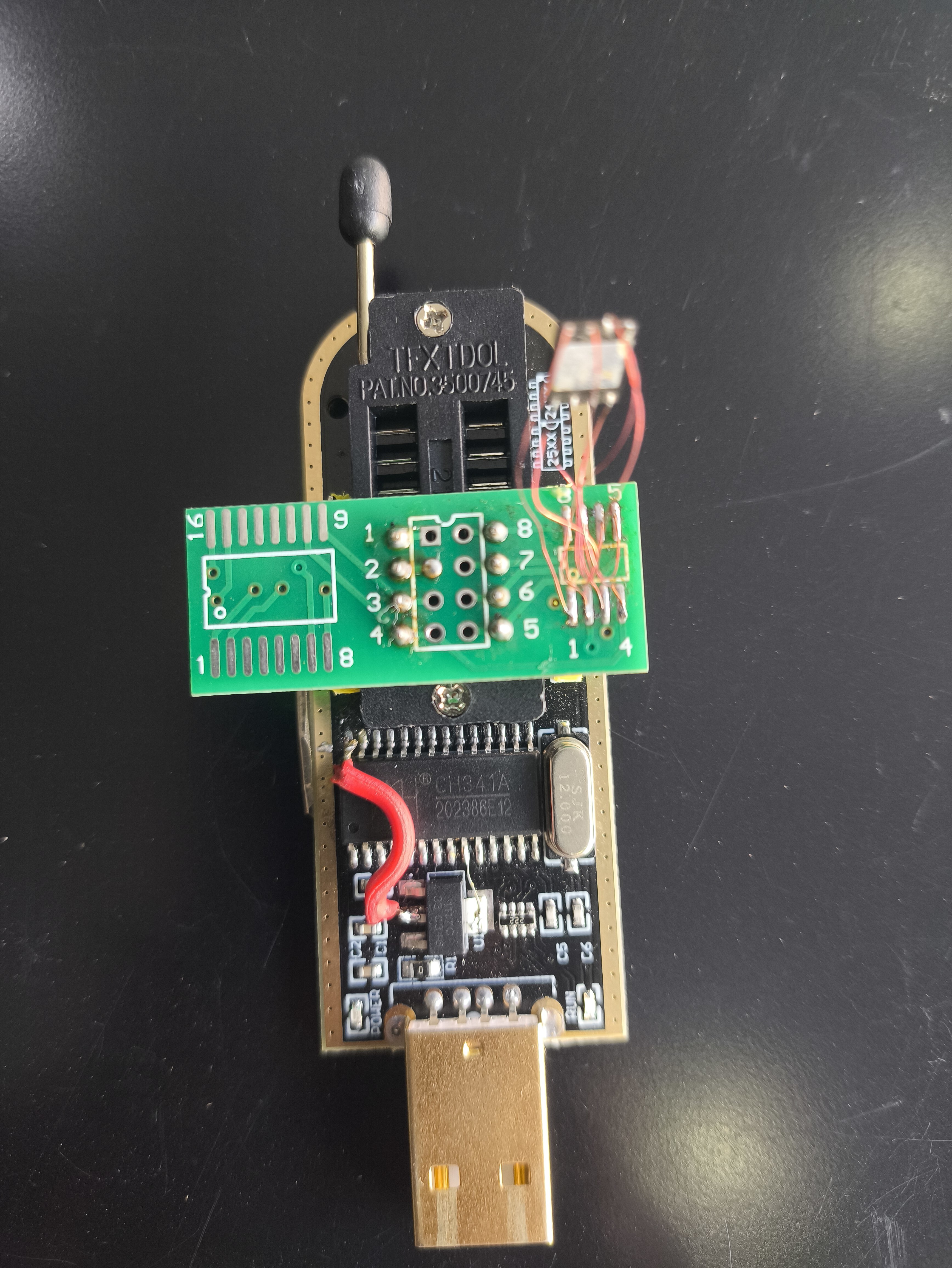

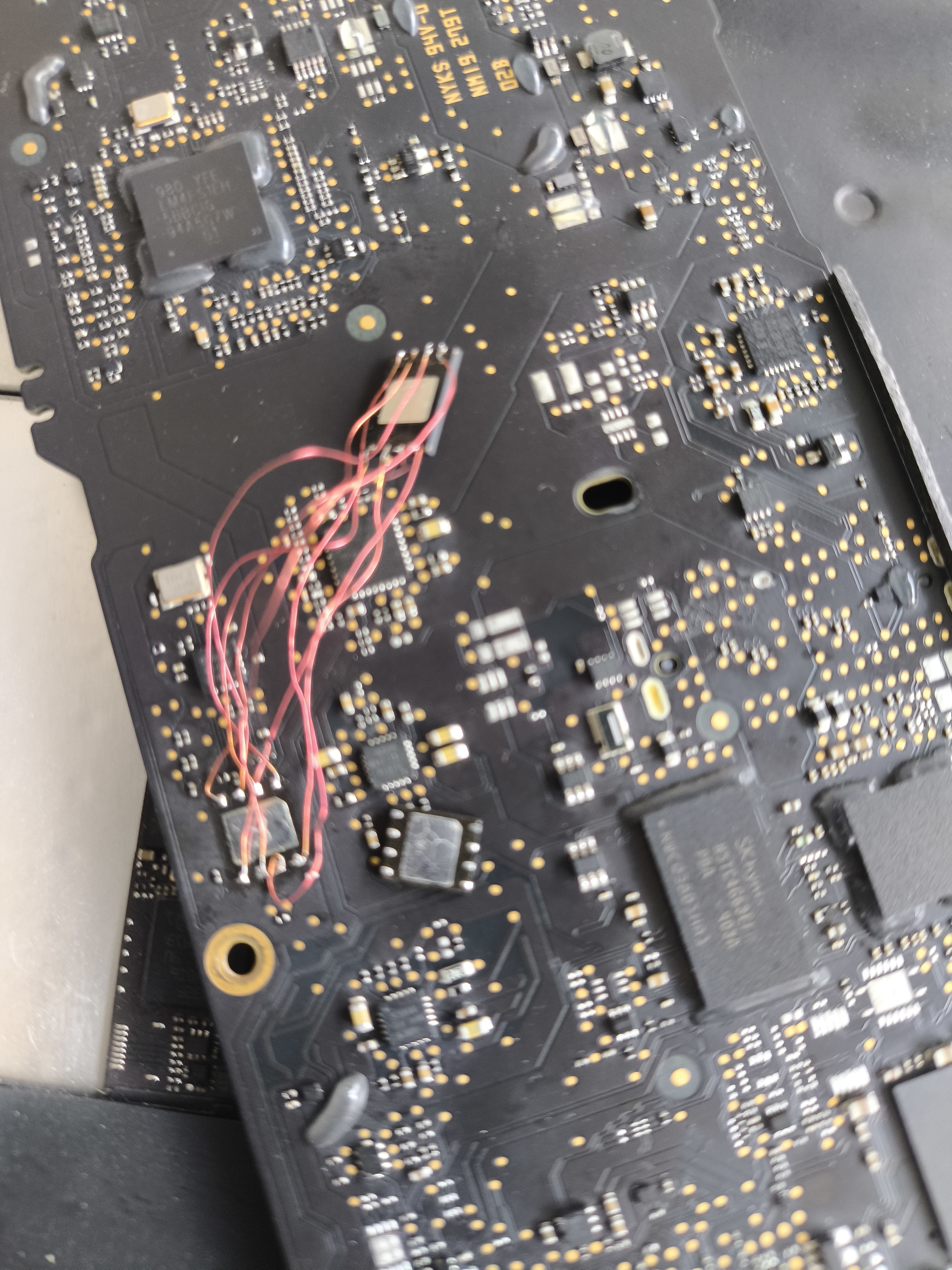

          #84
          Got programer data pin show 5 volt , or software not contact show in windows Mac .or need only window pc? thank you for fast support
          • Vipinverma
            • Sep 2025
            • 10
            • India
            #85
            There are no file
            • Vipinverma
              • Sep 2025
              • 10
              • India

                #87
                It's for help user not contact ic board giving short chip , so I found way my self, it's for macbook air a1466

                      #90
                      I have one problem i write on new chip this file workings fine but but orignal ic same problem i write and verify file , can use this file on both ic , i erase both ic , now thinking original ic damaged bad sactor but how to identify , original one fit on board but new I need wireing that is my ishu, I mean wire on board Big chip working fine
